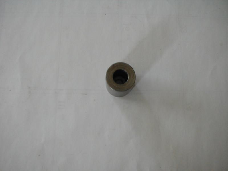

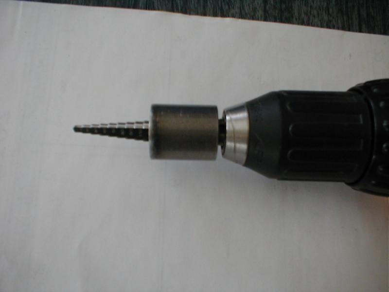

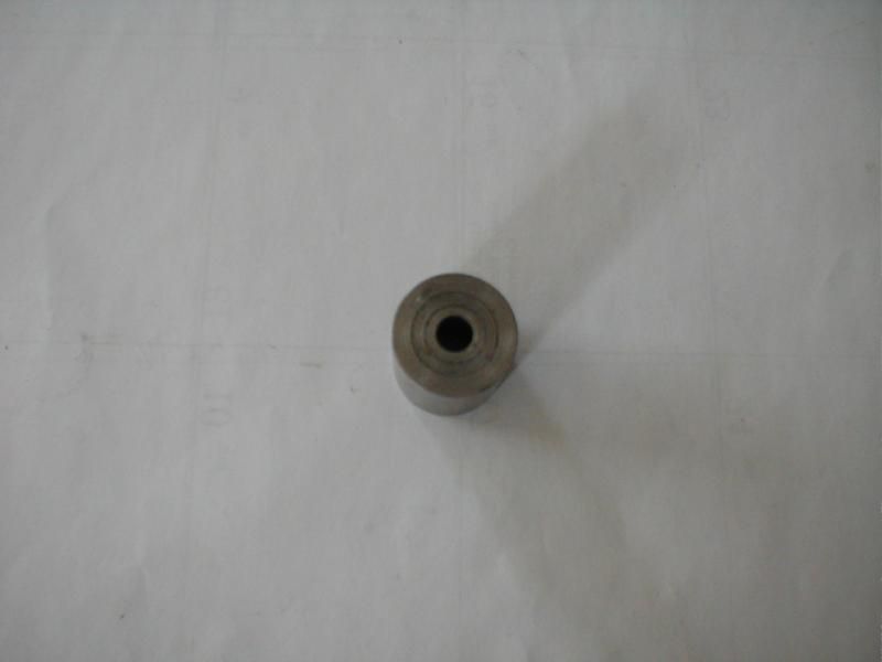

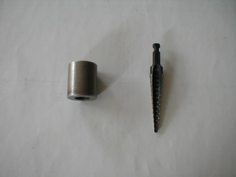

                      • The job was to drill 160, 3/8" diameter holes in 80' of 14 gauge sheet metal conveyor frame located 10' off the floor.
                        There was no doubt in my mind that a Unibit, or step drill, was the tool of choice. For drilling accurate round holes in thin gauge sheet metal they are hard to beat.
                        The problem with them is you run the risk of drilling under or oversize if you aren't constantly checking the hole or forgetting how many steps you've gone. That eats up alot of time.
                        My solution to the problem was the drill stop shown. While it's true that it is only for one size hole, the time it saves drilling the holes more than makes up for the time it took to make it.
                        It should be self explanitory as to how it's made and how it works but in short, it's a piece of 1" CRS with a 1/2" hole, the largest diameter on the Unibit, and a hole just large enough for the 1/4" hex shaft to go through the other end. The blind end of the 1/2" hole butts against the end of the Unibit which, when clamped in the drill chuck, prevents the stop from moving back and forth. The other end is trimmed to where the 3/8" step is plus a bit more to deburr the hole.
                        Works like a charm. After using a jig to locate and drill 1/8" pilot holes I just drilled away, clearing chips now and then, until the stop hits the base material and your done. Move on to the next hole. No need to worry about oversize holes.
