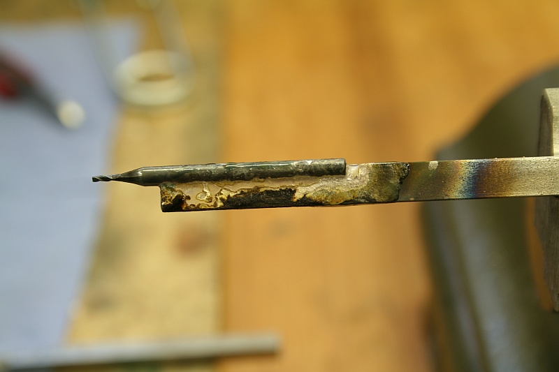

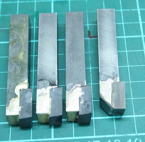

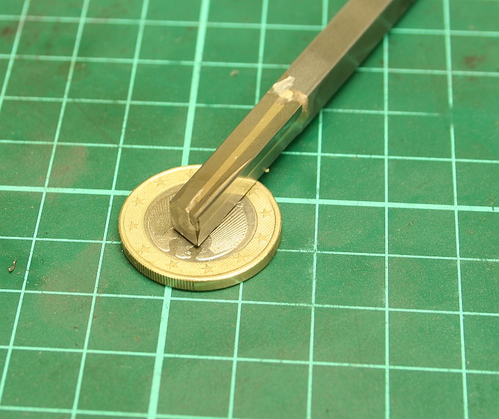

                          • Shop made brazed carbide tooling - You cant buy quality brazed toolbits here anymore (Used to buy Sandvik, but no one here stocks those).
                            Made two flavors:
                            6x6mm square with fine grade carbide endmills brazed on and ground:
                            That one is for very fine work.
                            10x10mm Shank with a tougher carbide for roughing:
                            I machined the pocket for the carbide tilted at 5° so i get my clearance angle by default and only have to skim the carbide on the grinder. The carbide bits I use already have a angled side on them that creates the top rake - Also very little grinding needed there. Only thing that needs more attention is the front clearance angle and an optional corner facet or radius.

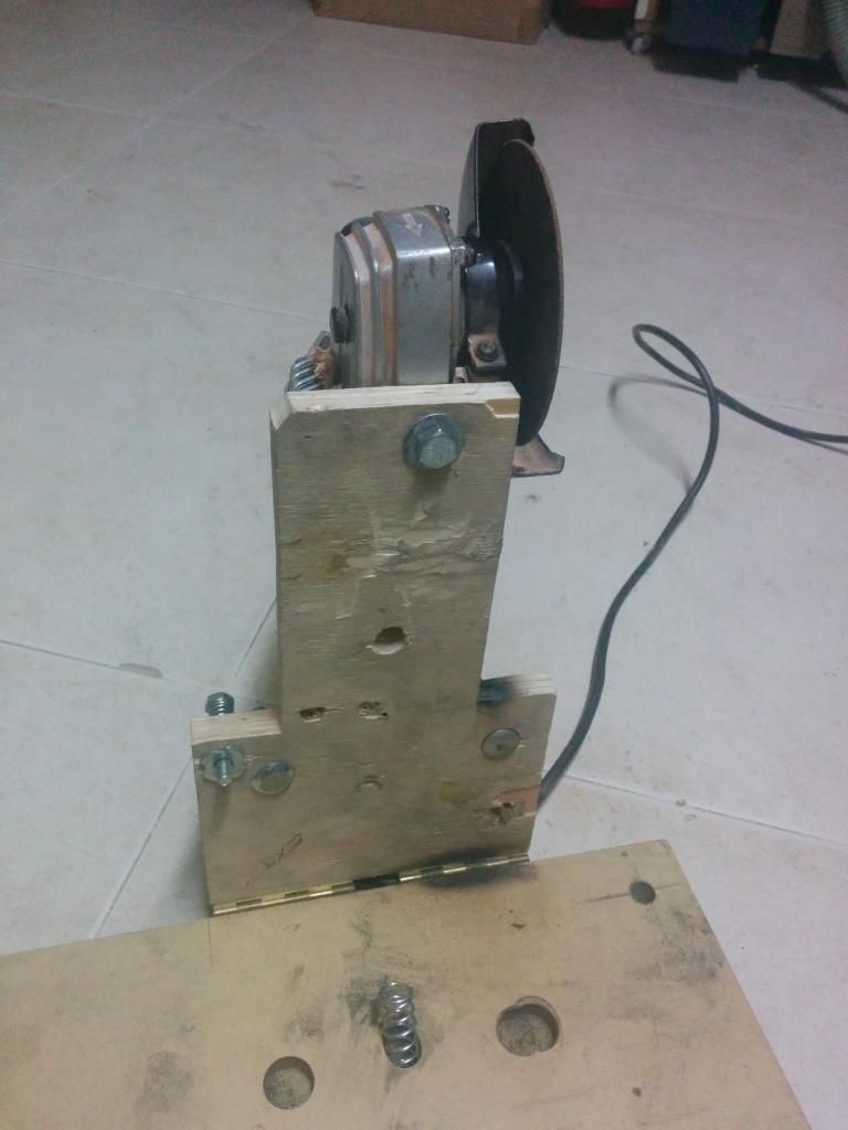

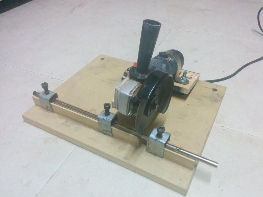

                            • Safe angle grinder
                              To use it safely, I fastened my angle grinder to a plywood board using a metal Ω (omega shaped) 2 inch metal bracket, and a single bolt through the board. The metal rod I want to cut is placed on a v-grooved board and fastened using three socket head screws. After cutting, and with the switch depressed, the board with the grinder pop up due to a spring located at the base. Disassembling is quick, and the hand-held grinder is there again.
                              [IMG][/IMG]
                              [IMG][/IMG]
                              [IMG][/IMG]
