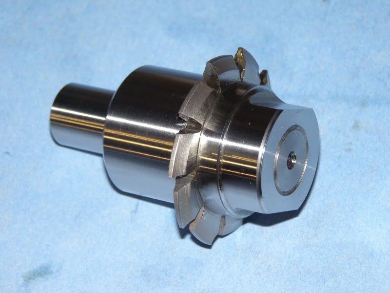

    • Cutter arbor for a metric involute cutter

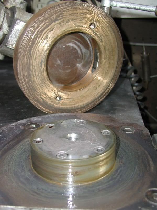

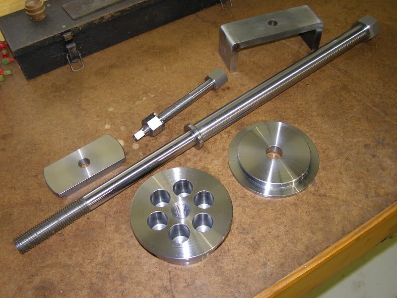

      Pullers and installation tools for 5 1/2“ bushings
      Grinding wheel puller for the surface grinder
      Various bushings for the end of my lathe spindle to center stock.

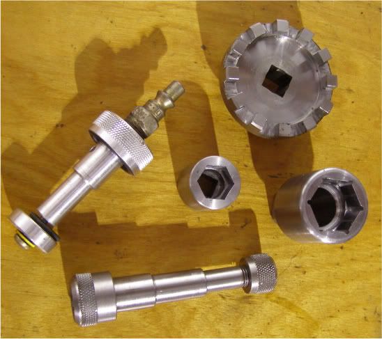

      • Various special sockets, fixtures, and pullers on what seems like a daily basis

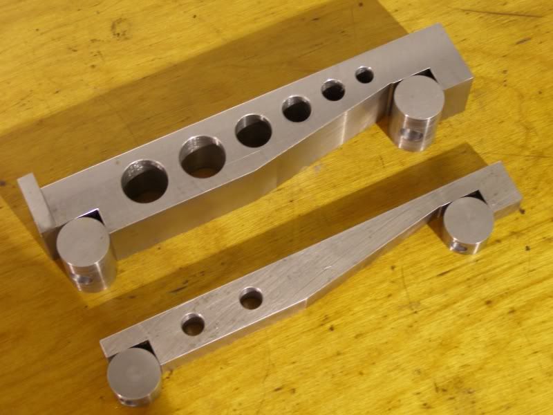

        Working on a couple of sine bars. Got them roughed out of A2 tool steel and ready to pop into the oven. Then off to the grinder to finish them.

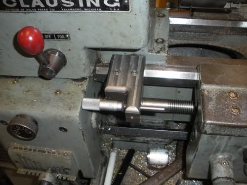

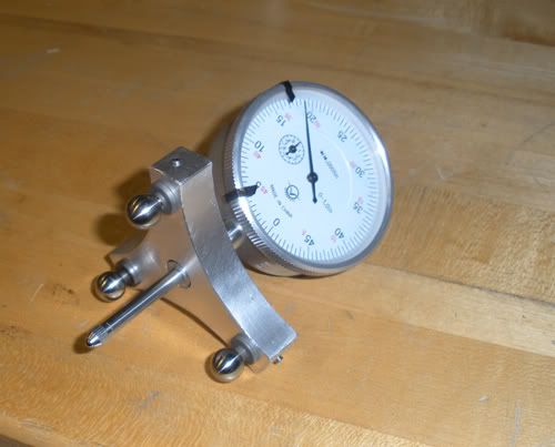

                  These are just a few things I came up with. The first is a micrometer carriage stop. very handy as I have no DRO and the compound screw is pretty worn.

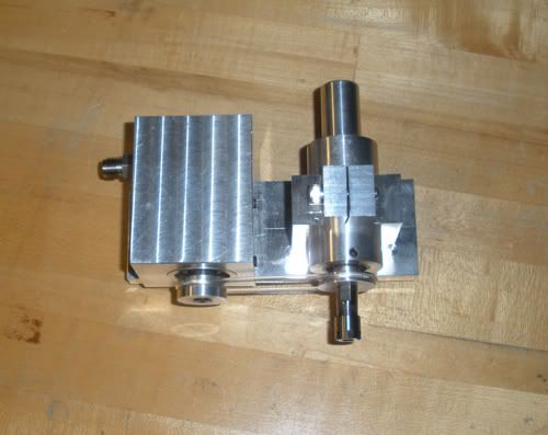

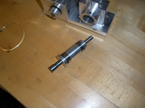

                  The second is a high speed spindle I made from a die grinder and an ER8 long shank collet I purchased from Hardinge. The spindle housing fits in a 3/4 collet, so its aligned with the spindle of my BP. Not particularly controllable, but fun to make, and useful when working with tiny endmills. The second picture is of the spindle cartridge itself.
                  Lastly is a spherical radius measurement indicator I built when I wanted to mill a dome shape on something. if you know the locations and diameters of the tooling balls, you can use CAD (SolidWorks in this case) to determine the correct indicator value for a given radius.

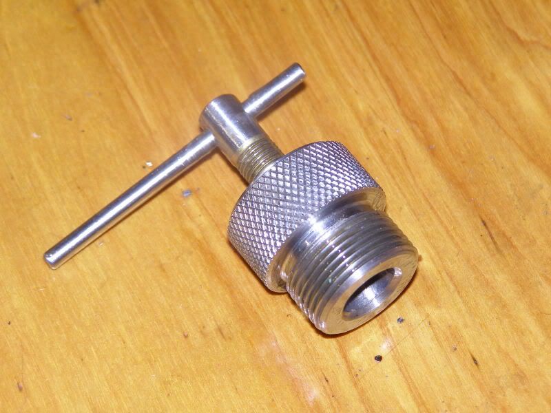

                  • Quill Handle
                    Here is a quill handle I made out of re-bar to replace the hex bolt someone had welded to the hub. Evidently, they couldn't get the broken stud out. I did. That hex head was bad on the hand.
                    It didn't thread all that bad. The knob was from Grainger.
                    The shiny spot in the second pic is where I belt sanded the weld off.

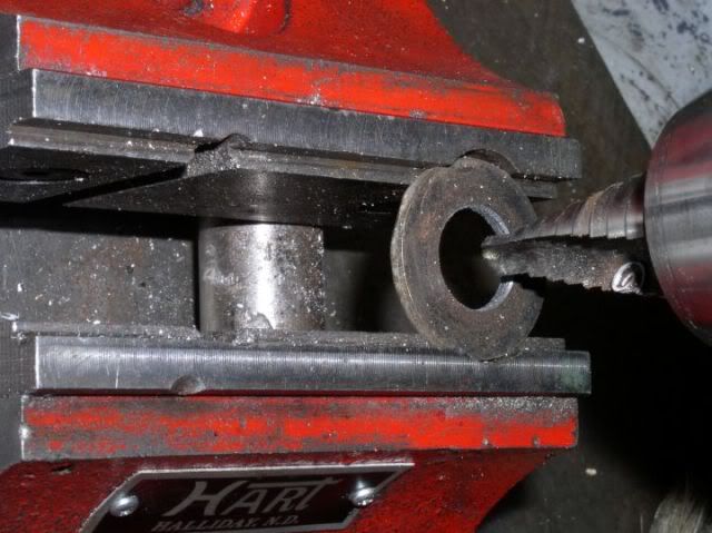

                    • Drill press vise improvements. Stepped vise jaws so parallels not needed and notches cut to cut hold disks. It is quick and easy to enlarge hole in a washer. Using a Unibit makes it easy to make hole bigger round and chamfer. Flip over and chamfer other side. Much quicker then using lathe.

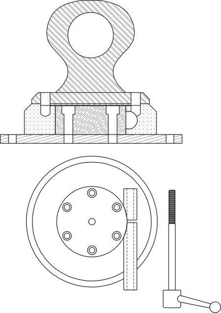

                            • Used to hate rotating bench vise. Loosen two bolts and juggle vise to rotate and retighten the two bolts. Was over at a friends and he showed me this vise, think it was Italian. Anyway it used a cotter that loosened easily with quarter turn of handle and swiveled easily with one hand and locked back into position easily. Copied that design shortly after that and have been happy that did.
                              Not needing the old lock down bolts they were replaced with new extension bolts so could have table behind vise.
