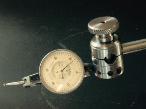

            • Just made an indicator snug inspired by a Starrett item. I can't say this is a good copy because I've only seen photos of the Starrett part and never held one in my hand. Some things about this design could be changed but it works. It mounts on a 5/16" or 3/8" post and takes several different sized indicator stems.
              • I will be copying that.
                • Originally posted by TGTool View Post
                  I believe Guy Lautard (remember him?) has instructions and drawings in one of his "Bedside Readers" for a Starrett type snug.

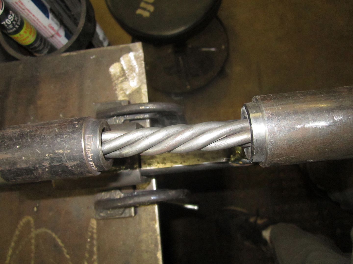

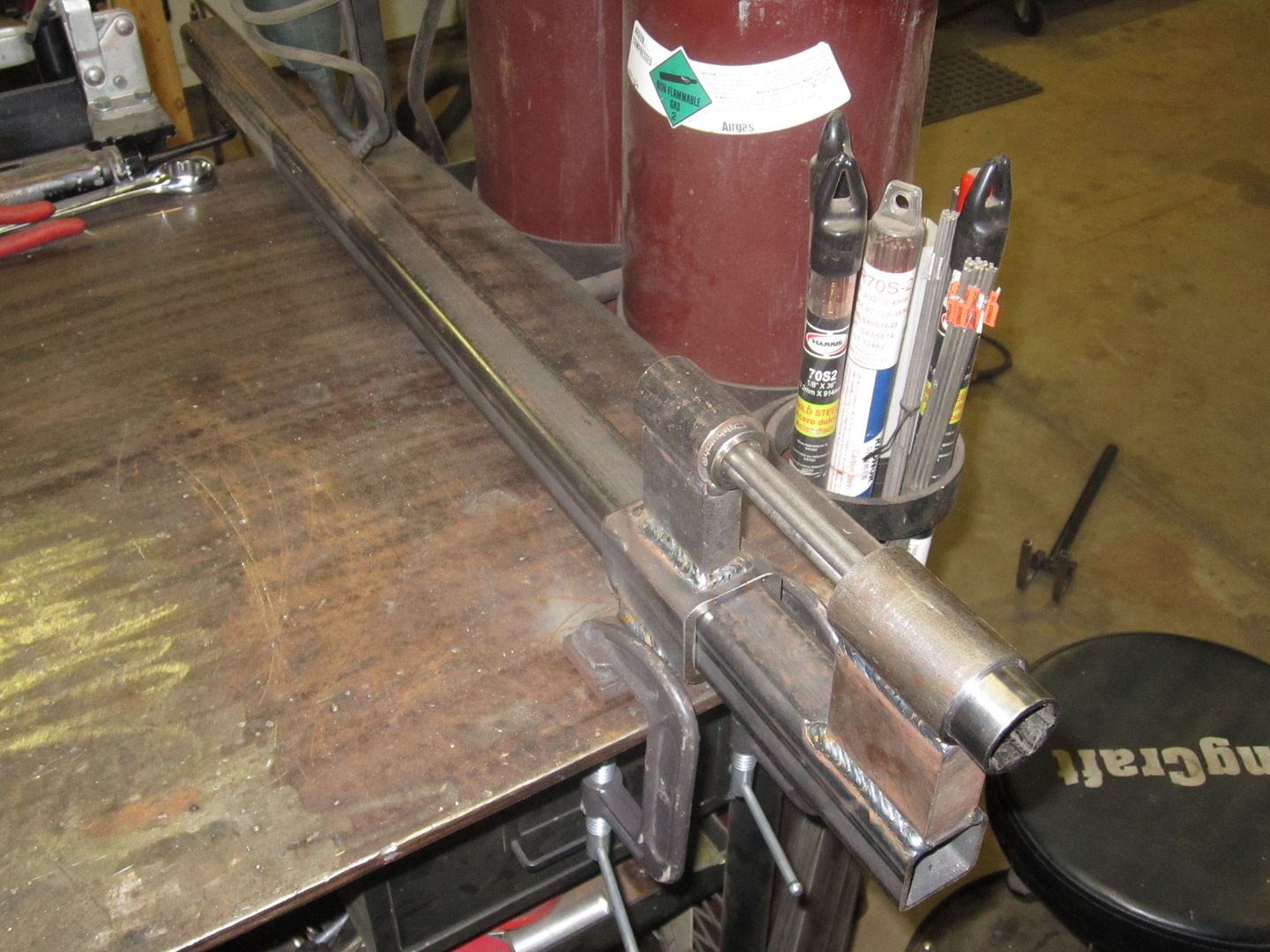

                  • Someone asked me to post this machinery moving kit to this thread. I call it my 'modular tube dolly'.
                    Here's the whole story:
                    http://www.nwnative.us/Grant/shop%20...ctWebPage.html
                    This is a great thread marred only by the vanishing photographs. Thanks to all who have posted.
                    metalmagpie
