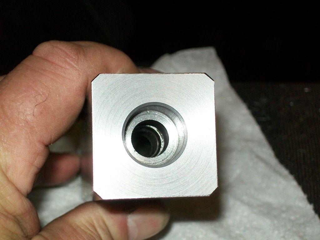

          • Here is a little tool I made from some scrap parts from work. The knurled end screws onto a hollow, threaded center section. I cut the center off flush with the end of the knurled nut, drill the ID part way thru to fit a 3/8" allen driver. I use it when changing vise jaws to spin the capscrews on/off.
            You can see I plugged the open end of mine.
            Drop me a line if you want a nut and insert.

              • That is an analytical column for liquid chromatography. Used in chemical analysis processes. High pressures (2-5000 psi) and low flow rates (1-2 ml/min) are common.
                • Nice, I need one of those and a hex one too, got any advice on how to make the bore accurately?
                  • The bore doesn't have to be accurate, .020-.030 undersize and press the Allen in. It is for hand use and doesn't see much torque.

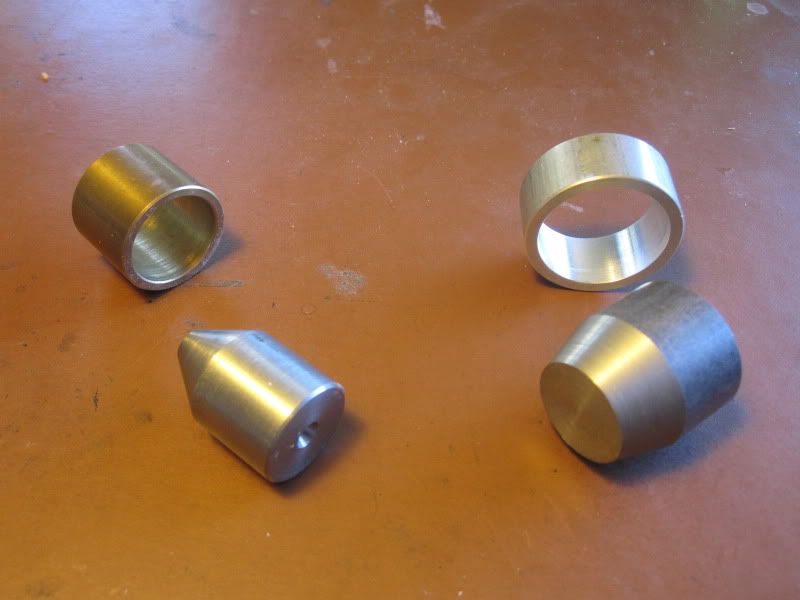

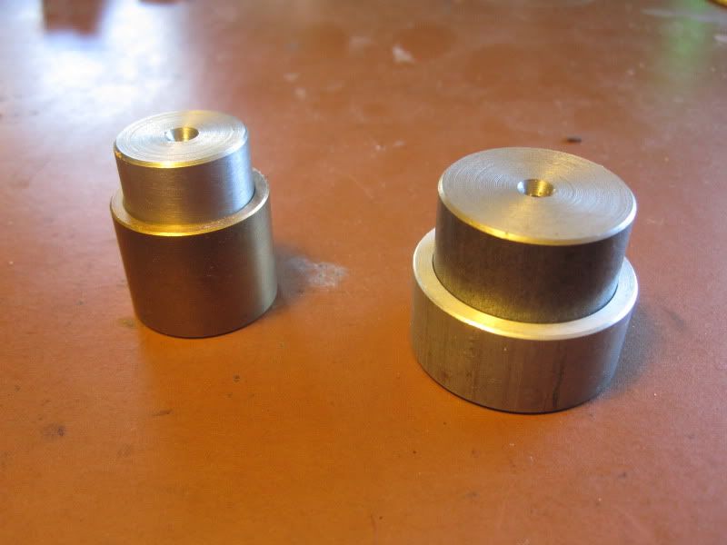

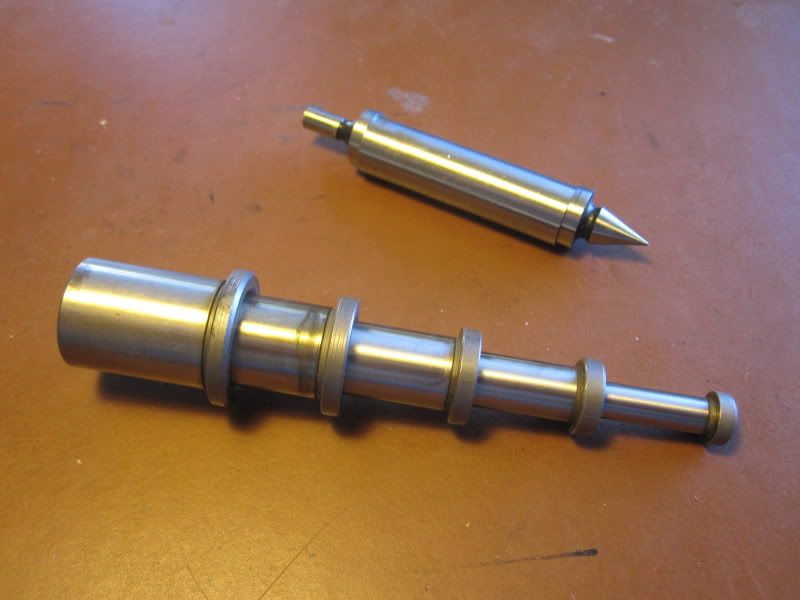

                            • Like many HSMs I don't have the headroom on my mill to use a coax indicator to center holes under the quill.
                              If the job doesn't require the accuracy of the Zero-It indicator, I'll often just use the pointy end of the edge finder (shown at top of picture) to center the hole. Unfortunately, the larger end of the conical tip is only 0.3" diameter so one is out of luck for holes larger than that.
                              If the holes happen to be aliquot sizes, set of nesting drill bushings (shown at bottom) can help but, if the hole is slightly over/under size, the fit can be sloppy.
                              I made these two devices to deal with the problem. Each consists of a slug of steel, accurately center-drilled at one end and having a conical taper at the other. Each has a companion close-fitting ring.
                              In use, the cone is inserted into the hole and the ring is pressed down on the stock to ensure that the conical plunger is held vertically. Then the cone on the edge finder is inserted into the center-drilled hole.
                              No, it's not as accurate as using a DTI in the Zero-It but it's more than accurate enough for 90% of the jobs I do.
                              They're simple to make. Try one.
