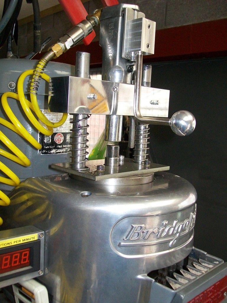

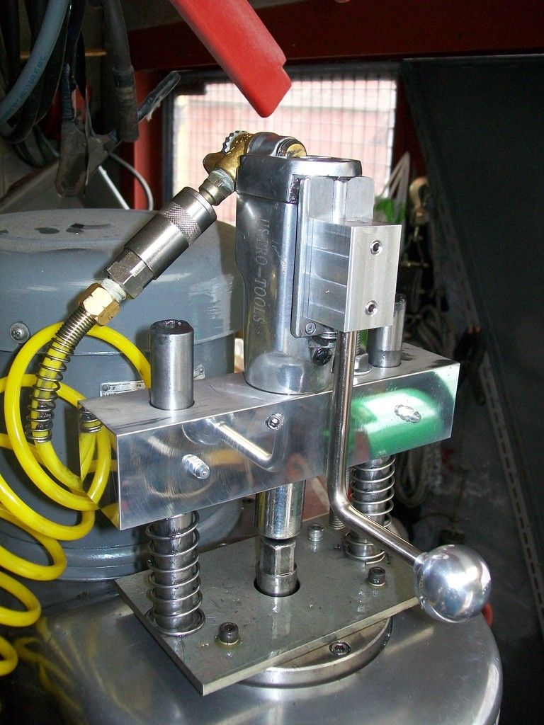

    My Fibromyalgia is getting no better and its a real struggle to use the drawbar on the Bridgeport so I made a simple power drawbar, like many other home made types it uses a 3/8" "butterfly" air wrench.
    Seems to work OK so far all it really needs is a decent automatic oiler, I did fit an in-line one but it wasn't a success.

    Been away for a month's holiday with the family to the Motherland. Paul; absolutely stunning work and finish, as per usual.
    Mike.

      He's right, now you just need to buff up that shroud says Bridgeport so it matches your shiny new power drawbar.
      Location: Long Island, N.Y.
      • Gentlemen thank you very much for the kind words, my cheapo oiler has finally turned up from the far east so I now have to make up some bracketry and do a bit of plumbing.
        Regards
        Paul

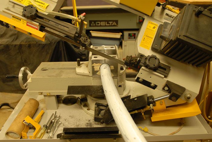

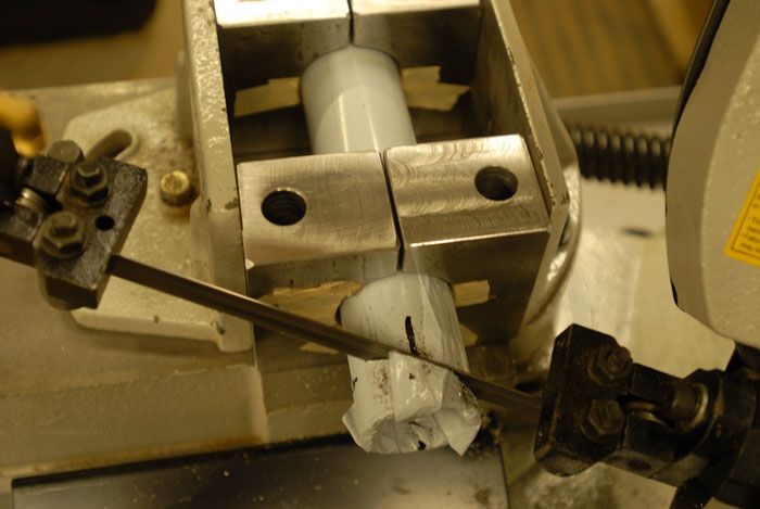

          With that challenge behind me I setup to cut very accurate fish-mouths for the frame's welded joints. By transferring marks from a full-size pattern, I laid out the miters and fish-mouths. Even here I made use of the saddles I had just produced to hold the work while making the miter cuts on the horizontal (mitering) bandsaw, as shown. Limited by the size of my mill vice, I used a conglomeration of things to setup and stabilize the most difficult compound fish-mouth, cutting all using a heavy duty (but not enough) carbide hole saw and arbor. Even though being very careful manually feeding, I managed to break a tooth off and snag one of the teeth enough to bend the tooth and the 1/2" shank arbor. I was able to bend the tooth back, using a punch. And I got the arbor straight enough, on my 50-ton press, that I could finish the job. (note--the hole saw was used with no center drill or guide pin) In the last photo you see the hole saw arbor being held by a 1" end mill holder; the quill is retracted.

            One thought on the hole saw grabbing. I have done a lot of DOM tubing work building a rock crawling buggy. Spin the hole saw faster than you would think, I like to spin an 1-5/8" at around 3-400 Rpm in 1.5" OD x .188" Wall 4130. I did an entire chassis with probably a hundred cuts on one saw and its still good. If you spin it slow each tooth grabs and pulls and breaks teeth. the higher speed allows the teeth to cut rather than rip. Very thin tubing (.065) requires even more speed to keep from grabbing. Heat is not really an issue because there are so few teeth in contact at once.
            Also for coping thin or large dia tubng that may be difficult to get to the mill. Try this: http://metalgeek.com/static/cope.pcgi
            I had to cope some 16Ga 3" OD SS exhaust tubing at a 45' angle. This worked very very well. Just punch in your job and print out the parabola, cut it out with scissors, tape it around your tube and cut the tube on the line.
            • Thanks for the link; I haven't tried that yet.
              And I think you're right about needing more speed. I set the mill's speed based on what I seemed to remember was good for HHS on steel, 100 fpm. But I could have perhaps doubled the rpm for carbide.

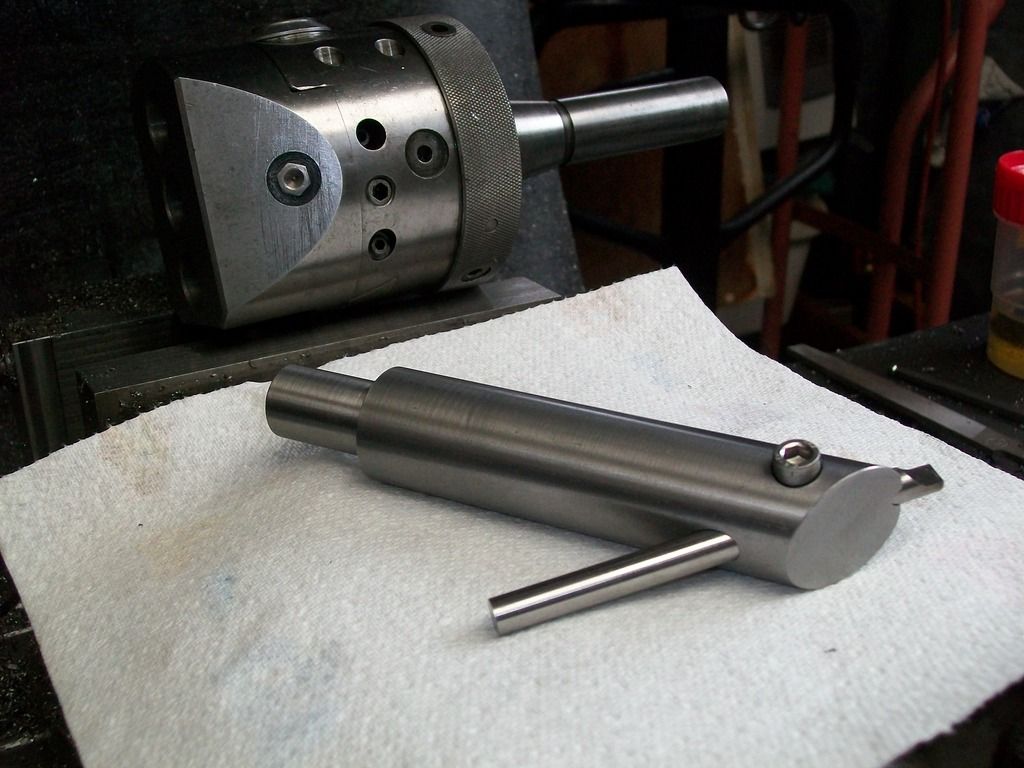

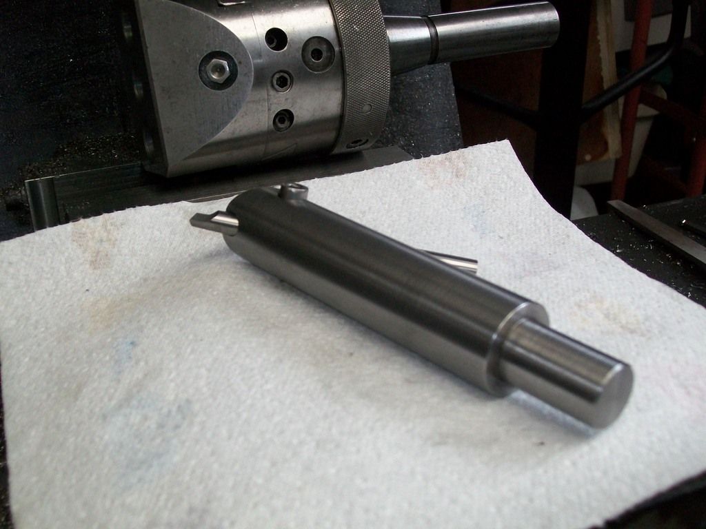

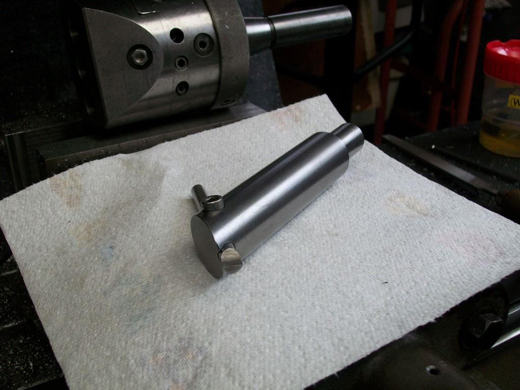

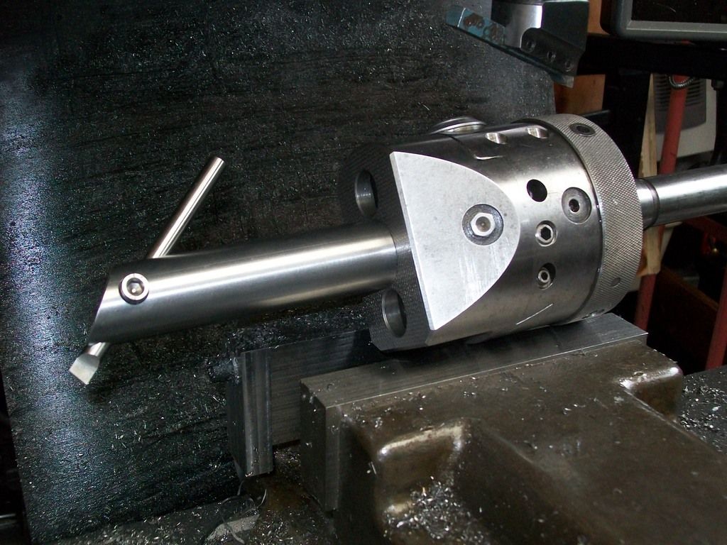

              • Bought some Brazed Carbide tooling for my new (to me) Gamet Boring & facing head, the quality of which seems less than spectacular.... so decided to make some boring bars to suit 5/16" HSS tool steel, this is the first one made from some "spare" EN8 major dia 1.125" minor 0.749" & 6" long.
                Paul
                • paul, a set of multi tool diamond disks from HF and a diamond hone will work wonders on getting those brazed carbide cutters sharp and with the correct relief. I did that on some junk brazed bits and they cut very well now.
