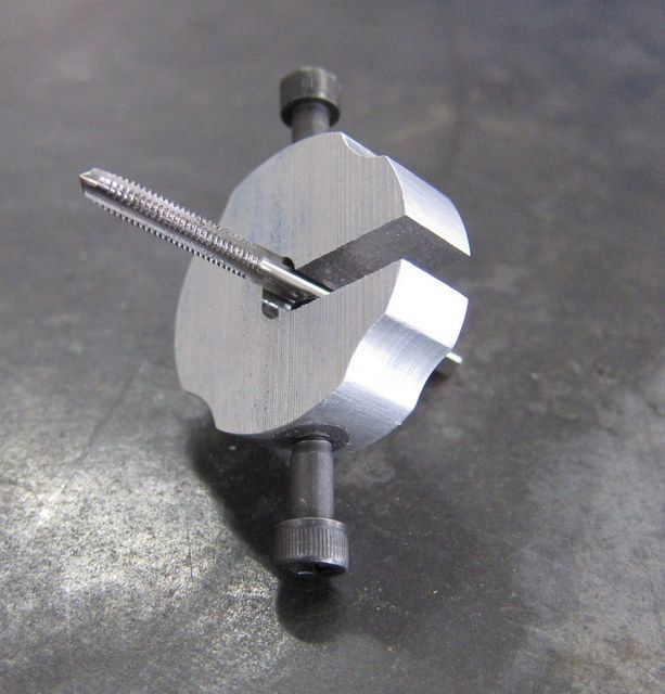

          I'm just curious here but why go to the bother of building a sliding tapping device when the tailstock is made to slide on the ways. I have always just used a standard Jacobs superchuck in the tailstock and let the tailstock unclamped and slid it into and out of the tapped hole. This is how I learned to tap in a lathe from about a dozen full time lathe hands when I was serving my apprenticeship.
          Hey Brian had tail stock off lathe it weighs 210lbs. that is why I built sliding tap holder,it heavy beast.
          • Here's my quick n dirty take on a tap handle to use after drilling so as to use the chuck to start the tap straight without removing the work.. in this case drilling/threading pistol barrels for sights.[IMG][/IMG] -ST-

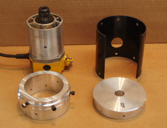

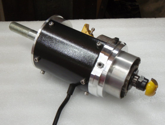

                        • Woodworking Router Mount for Bridgeport Mill
                          I needed a sturdy means to mount a woodworking router onto my Bridgeport mill. I decided to use the mounting point on the back of the ram where a slotter would ordinarily go. This keeps dust away from the milling head, and keeps oil from dripping onto my work.
                          The first picture shows the router mount assembled, and the second picture shows it in place on the milling machine:
                          I took a piece of 12 gage steel sheet to a local metal fab company, where they cut it to size and rolled it to a cylinder, about 4.6 inside diameter and 5" long.
                          Then I cut away enough of the cylinder to give access to the switch and to let plenty of cooling air in to the motor fan. After drilling the neccessary holes I sandblasted and painted the cylinder.
                          I machined the two aluminum parts to fit the cylinder, then bored the bottom ring to fit an old DeWalt router motor. A hole in the center of the top plate accepts the 7/8" mounting bolt, and the slot in the top plate engages a 1/4" pin locktited into the bottom face of the mill ram. Two setscrews go through the bottom ring and engage holes bored into the router motor body, and this keeps the motor from turning under high torque loads.
                          Here it is in use, hogging excess material from a chunk of Osage Orange. It works as well as I had hoped, solid and sturdy with no chatter or vibration even when hitting knots, voids, and wild grain.
                          • Excellent John!! That sure gets the big stuff off fast.
