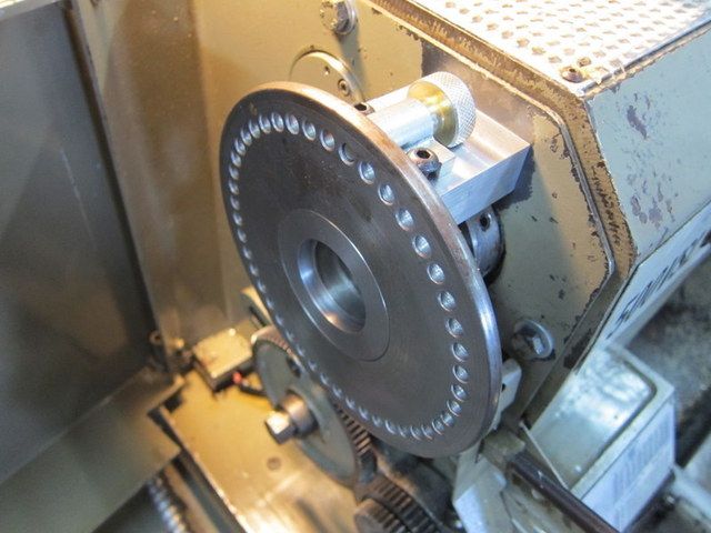

      • Indexer for back of Boxford 500 VSL spindle. -ST-[IMG][/IMG]

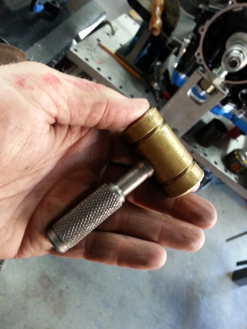

              • I was looking for my favorite shop made tool, I have allot of them. BUT what do I use most?
                [IMG][/IMG]

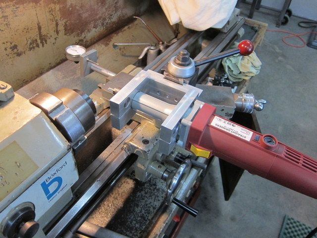

                    • Here's my take on a lathe die grinder. Can also mount to T slot cross slide. -st-[IMG][/IMG]
                            I will be making one of these ASAP, I see its usefulness!
