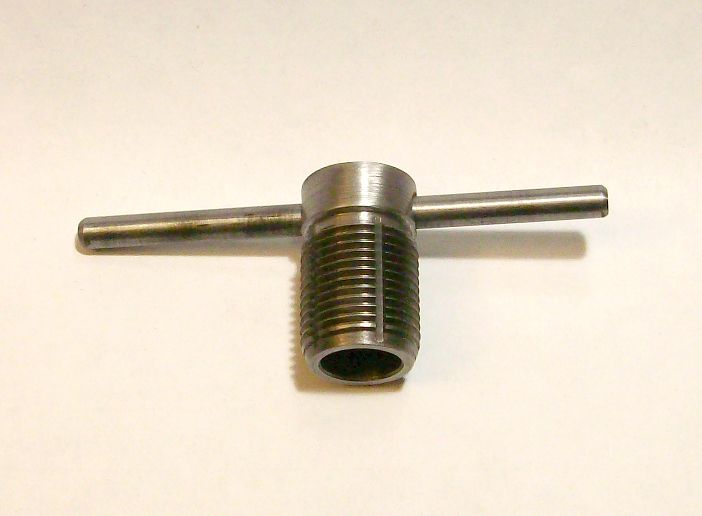

      • Made a "hollow line tap" (the industry's nomenclature, not mine). It's obviously not a tap, just a tool for restoring threads in refrigerant line fittings. The commercial set I have is supposed to have the most common sizes but it doesn't have a 7/8"-14, which is what I need most often. So, I turned some "Scrapalloy", put a thread on it, cross drilled for a tommy bar and then hardened it. Haven't had a chance to use it yet, but it will sure as heck beat scraping the gunk out of a fitting with a pick.
        • Welcome to the forum Tim. Nice job. Did you slot and then thread or the other way around?
          Location: Long Island, N.Y.
          • Thanks Rich. I threaded first, cut the slots then drilled the hole. I don't have a mill (yet) so any slotting has to be done on the lathe. I figured it would be easier to have only thread to cut through.

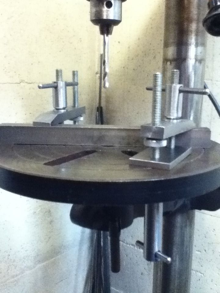

            • Drill press clamps. I got the design from Chrisb257 on YouTube. Having no mill, the rectangular bits were roughed out with a torch and angle grinder. Finishing was done through a lot of tedious four jaw chuck work and filing. All the material, except for some bits of 3/8" threaded rod, were yanked out of the scrap bin at work.
