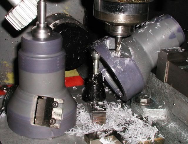

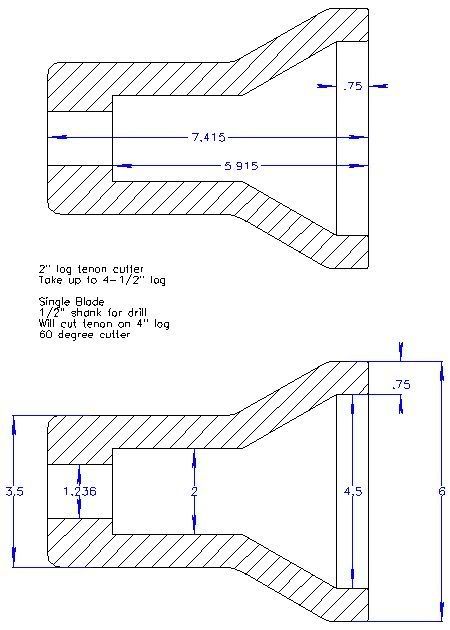

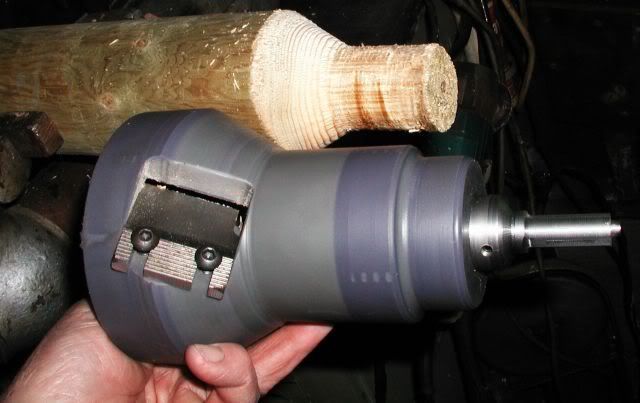

                    • Using some unknown industrial plastic that was a throw out, hunk of planer blade and some steel for shank to fit half inch drill. Using picture from Lee Valley catalog, Veritas® Power Tenon Cutters , as a guide. Tough plastic held up for doing bunch of fence rails.

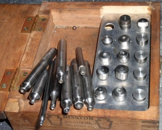

                      • Some punches made from drill rod

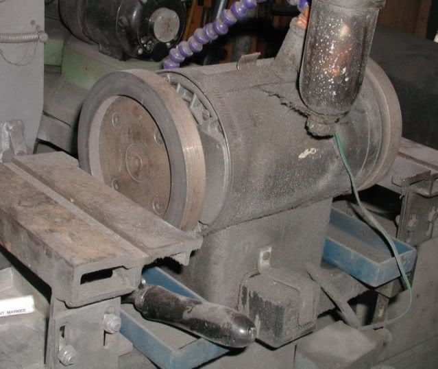

                        Washing machine motor with some tin rapped around it. Hunks of broken table saw cut out. Bottle has kerosine and acid brush in it.

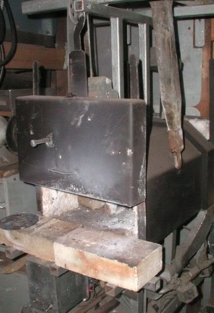

                        Propane gas forge. Has selinoids for pilot light and main fuel line. Also ignition so tank is turned on it starts when switch is put on.

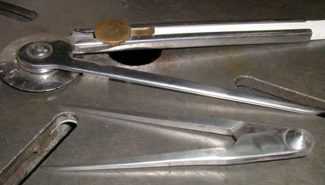

                        Except for the 6" travel wheel these two were made by heating, beating and filing.

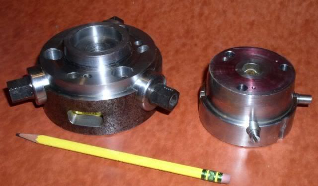

                        • Got a lathe with a D1-2 spindle nose. Couldn’t find any backing plates for this so had to make. Made copy of spindle nose. Turned out to be easy to make accurate duplicate. Set compound to taper with indicator on center. Chuck up blank for duplicate of spindle nose on same lathe. The taper and flat have to be close to right on. Turned out it was easy. Smear on little prussian blue and test best backing plate got. Take little off what is needed either taper or flat. Keep testing and repeating until get results wanted. Drill holes for guiding drill for pins when making new backplate.
                          Made another one for lathe that has D1-3 spindle only this time added cams and method to bolt to mill table. Now can turn something in lathe, take chuck off and mount on mill table. Mill some and put chuck back on lathe and things should be running true on lathe. Whew, hate that much writing.

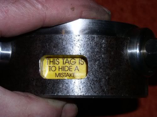

                          Screwed up making slots for toe clamps and made slot too deep breaking into a bolt hole. Covered mistake with tag
