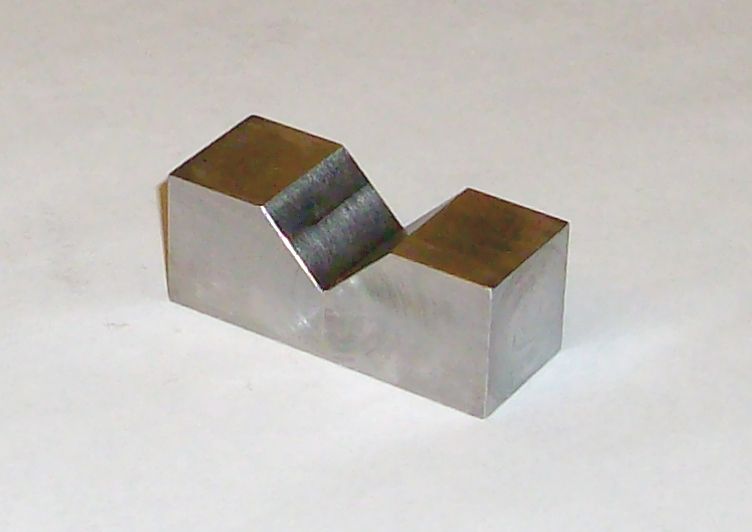

  • I needed a vee block to complete another tool. Quick, dirty and effective. A classic case of making a tool to make a tool to make another tool to ultimately make a part.
    • Tim: nice job, elaborate just a little, how you made it and all, the good work needs explained, some like my wrench years ago just a picture is enough!

            The block I started with was already machined square as I had used it as a practice piece some time ago. The V is 90 degrees and was layed out with a combination square. I set the block up in the mill vise using the head of a combination square so the block was tilted to 45 degrees. It simple matter of making small cuts to the scribe lines.
