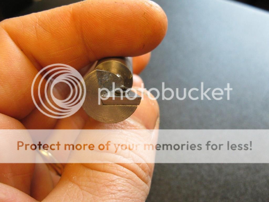

  • made a 60deg dovetail cutter after the one I made out of O1 tool steel bit the dust. Nothing new here, but I'm pretty pleased with how it turned out
    it's starting to chip a little behind the nose, so I think I'll grind a bit of a nose radius on it to help it hold up.
              It's starting to chip a little behind the nose, so I think I'll grind a bit of a nose radius on it to help it hold up.
              Have any dimensions? What insert did you use?
              Simple, but very nicely made, and a very useful tool to make plenty of QCTP holders.
