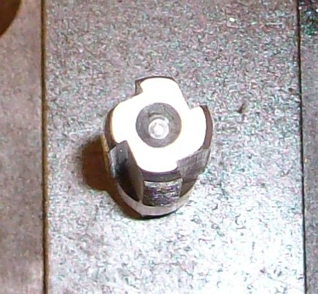

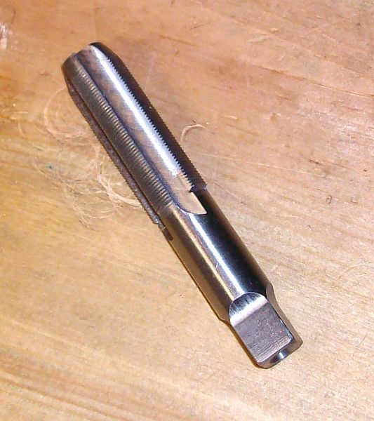

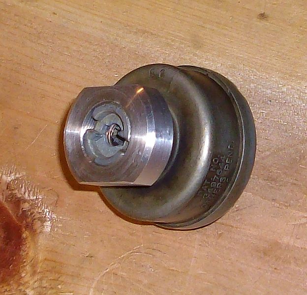

            • Cheap plastic nut on my mower's ignition switch was stripped. Switch body is die cast without much regard for any particular thread. Pitch is 32tpi but the major diameter is .616", bigger than 9/16" but smaller than 5/8". So, I made a tap out of an old grade 8 bolt. I used it to tap a new aluminum nut and it will probably never be needed again so it didn't make sense to try hardening and tempering it. Worked like a charm.
              • Nice. I never thought about making your own tap.

                    • Originally posted by Tim Aldrich View Post
                      Nice work on making a tap, but another dodge and a little less work would have been to use a 10-32 tap. Mount the tap like a small boring bar, get it lined up straight with the ways or perhaps a tiny bit pointed out to compensate for spring. Set the gears or QC box for 32 threads and thread it more like single pointed threads. You don't have to fret as much on thread depth since the tap will control depth. Two or three passes and check the fit with your male thread.
                                I may have to try that out sometime.
