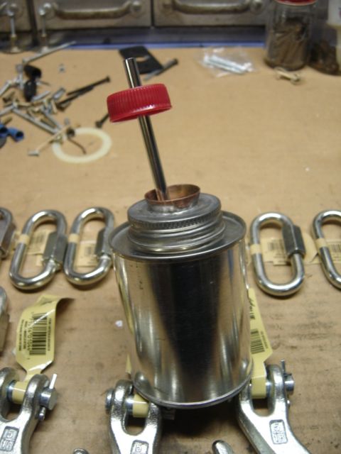

      • This one's not very technical, but it is something that serves a purpose. Every time I watch a you tube video of someone doing machine work, I notice that most are using some sort of cutting oil container and an acid brush. Lots of variations, from commercial plastic no spill pots, to old soup cans. Myself, I've been using an antique sewing machine oil can. It leaks, it's small, and I figure one day I will catch the spout is something and ruin it's antique value (probably less than $.50) So I decided to search U tube for ideas on making something that works better than a soup can, and that I can make rather than buy. A common complaint with the home built units is leaks from failing solder joints. Adding to that, the spill proof ones have no provision to keep out chips, dirt and other debris, and no means to clean the container out once it is full of junk. Their has to be a better idea. Here's mine:
        In it's past life the can contained PVC cement cleaner. Since it was several years old, and had never leaked a drop, and was nearly empty, it seemed like the perfect item to base the oil pot on. All that was needed was a piece of 3/4" copper pipe, and a soda bottle cap to slide over the acid brush handle. Cut the hole for the pipe with a hole saw, chucked the pipe in the lathe and spun the flare, trial fit the pipe to determine the length from start of flare to 1/4" from the can bottom. Solder the pipe onto the cap, and it's done. The bottle cap just fits over the flared pipe and is a snug fit on the brush handle so it can be slid up the handle for daubing the oil. The can's cap can be unscrewed when cleaning is needed. What could be simpler?

          That's a clever idea. Thanks for posting. I'll have to build one.
          Hal
          • Thanks Hal. So far it's doing the job.
            Lewis Grizzard

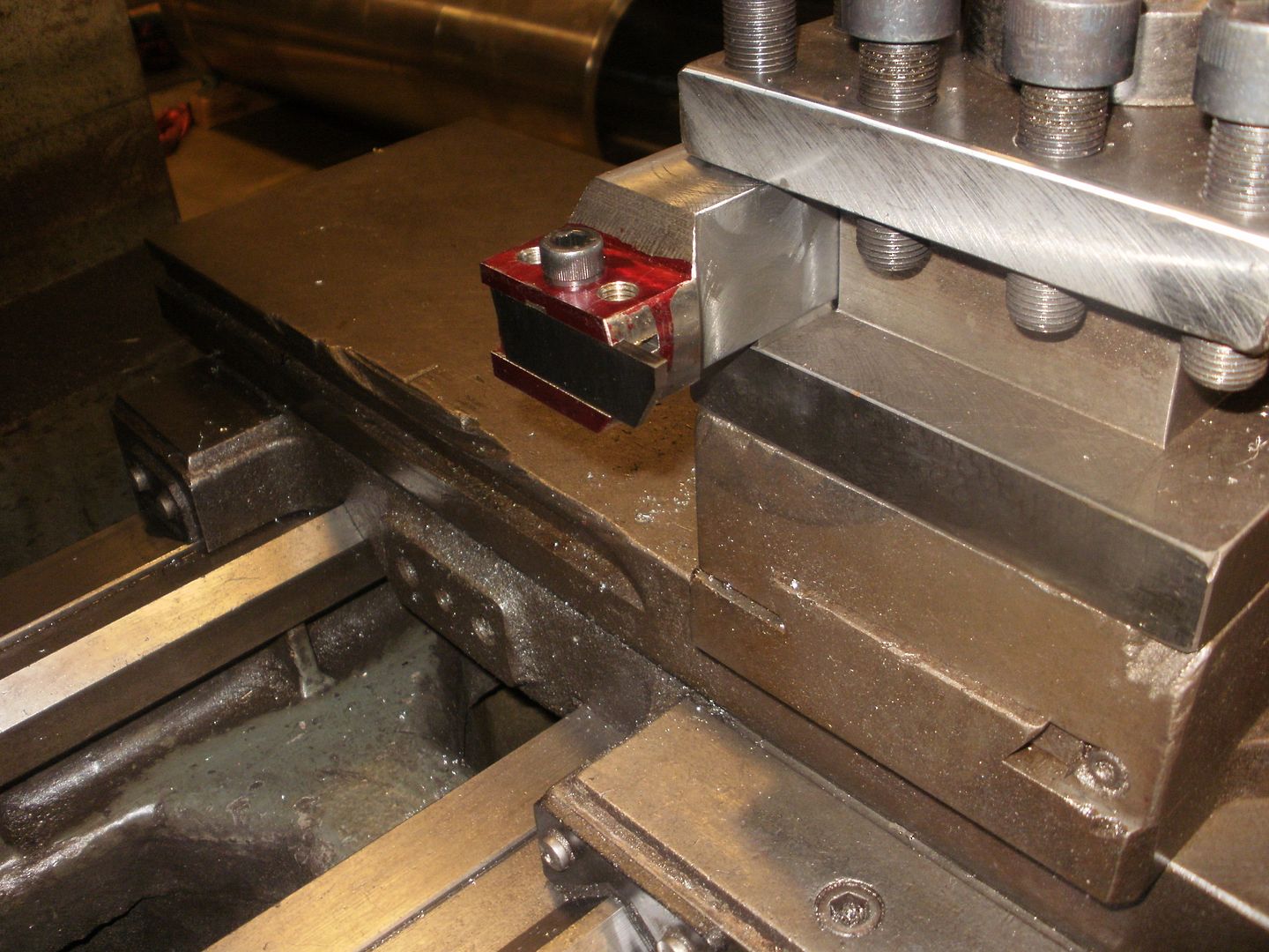

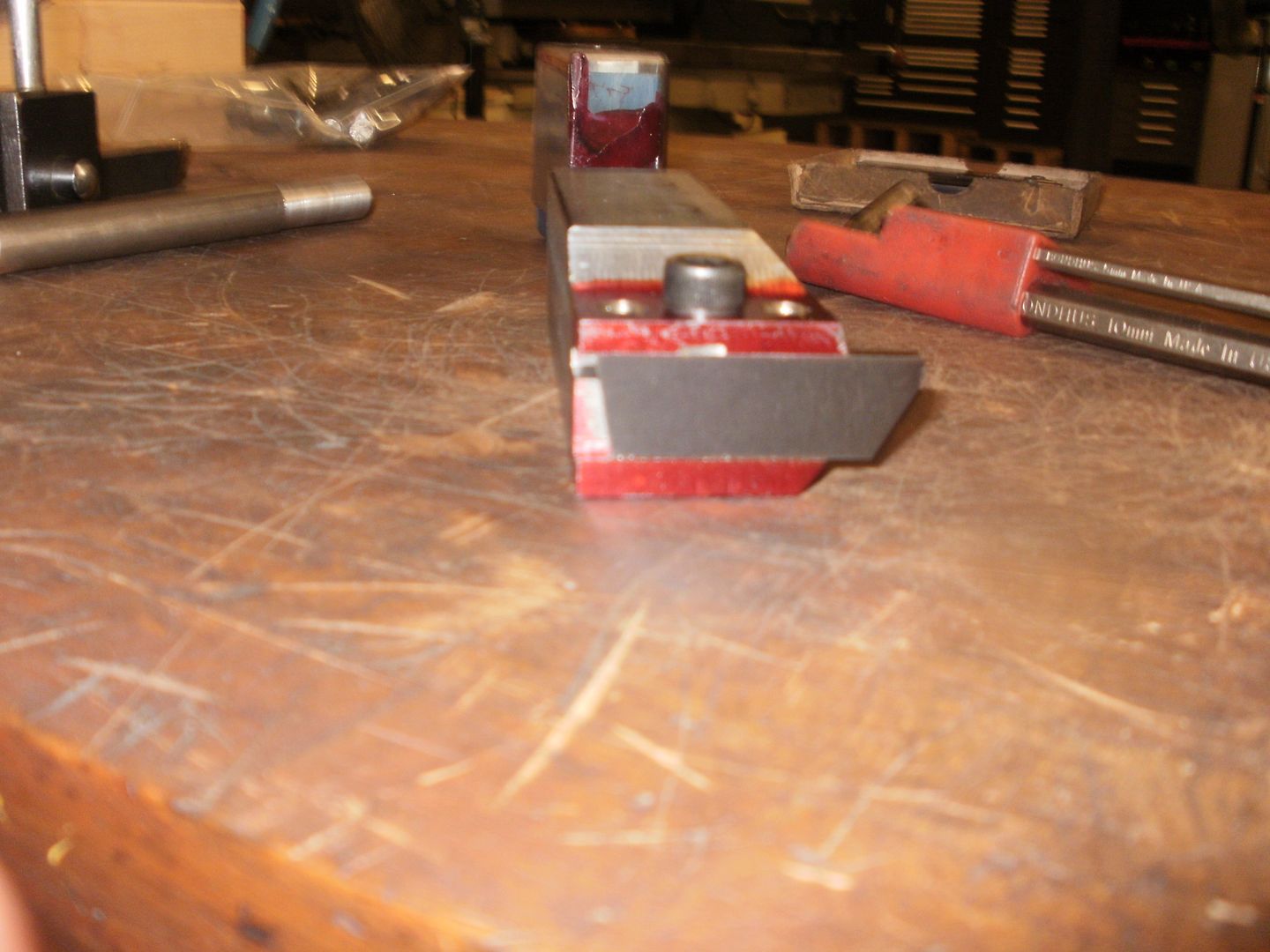

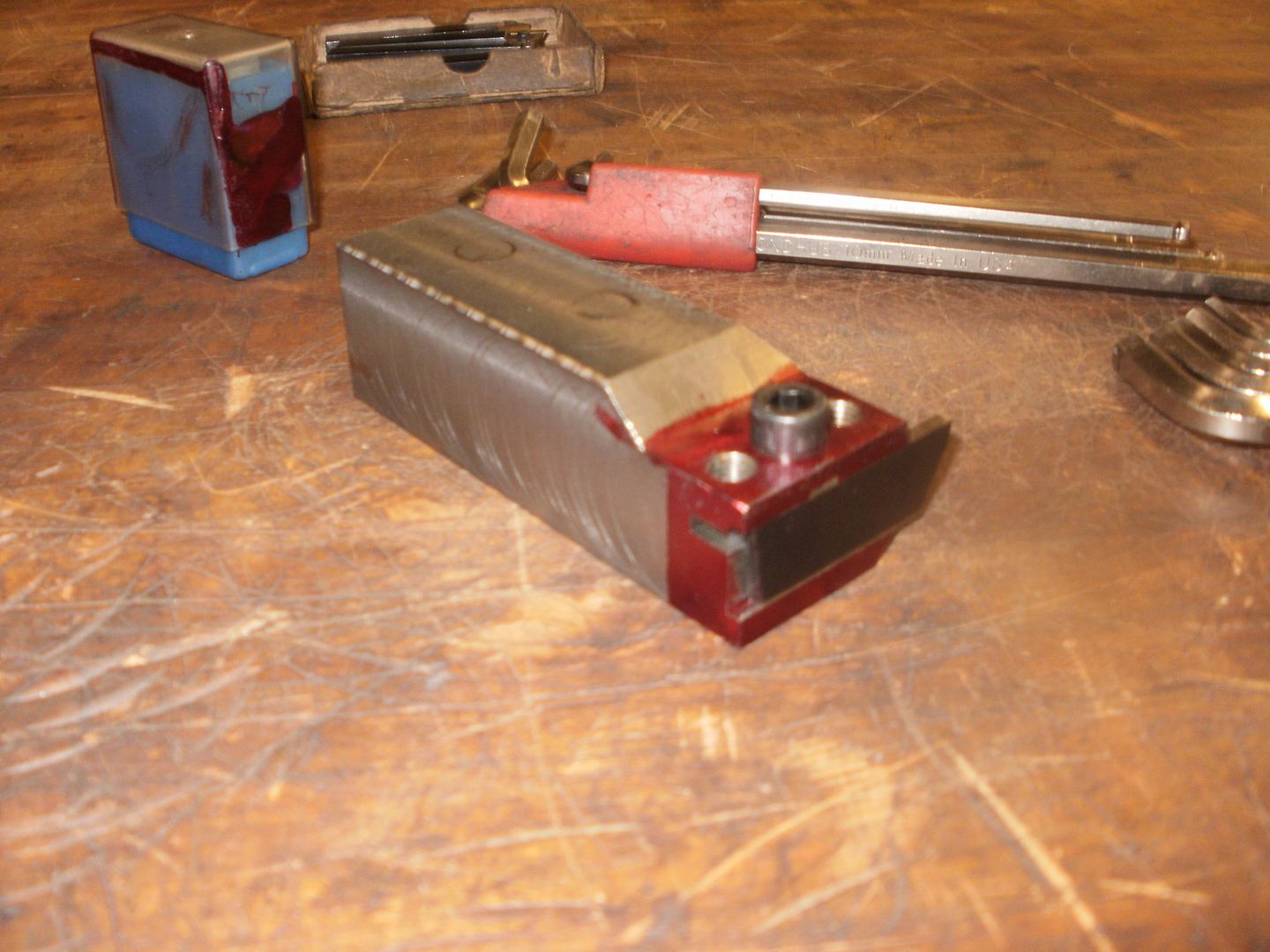

            • recently at work I've needed to cut internal grooves in some stuff at work due to the on going process of engineering changes. Found it was easier to just make up a tool holder to use cut-off blades internally. No dimensions, no sketch, just grab some stock and go. Cut-off blade has tapered top and sides. So the slot in the end of the tool holder was cut with the vertical angle and both the top and bottom tapers built in. Holder has a slot cut about 3/4s of the way from the bottom to allow the screw (M8-1.25) to distort the holder enough to clamp the blade. I thought I'd have to cut the slot deeper but it seems to work just fine. I think the holder is 4140 but I'm not positive. Some type of commercial shafting. Works well on 316 stainless at about 40 FPM
              I will need to cut the top down a little as it is too tight a fit in the tool post right now

                Spin Doctor, that's a nice looking tool and holder for just being whipped up. Necessity is the mother of invention, eh?

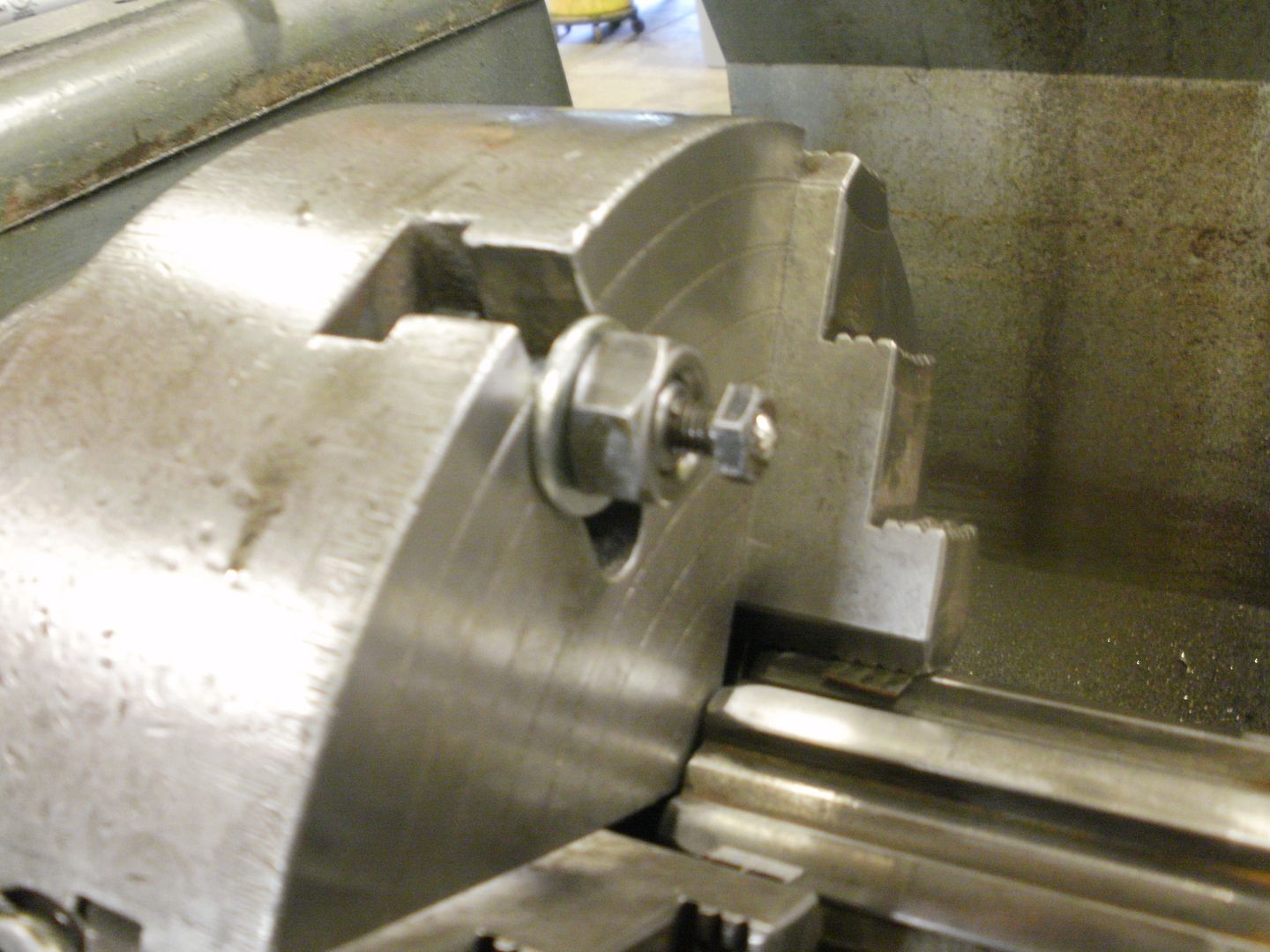

                    • When indicating pieces in a 4 jaw chuck the end of the piece away from the chuck is often tapped around with a soft hammer to get indicated in. Even with a center you can't really on that to get it zeroed in. Rather than tapping the piece with a soft hammer it is far better when possible to use a screw jack between the chuck face and the part. This gives far greater control as far as your movement of the workpiece. But how to mount the screw jack. At first I used a 1/2-13 Hex Head Cap Screw drilled and tapped for a M8-1.25. The M8's all have a hole spotted in the head to accept a ball out of ball bearing removed from service. The ball is pressed in just past half of the diameter. This works much better than a flat head face on the screw. doing nothing to the screw face would ne the worst option. Second best would be to machine a cone in the Hex Head but you might lose too much of the hex that way Unfortunately this left too little meat in the 1/2-13 screw. Next step was a 5/8-11 or M16 Hex Head Cap Screw drilled and tapped. The head of the screws are just a touch loose in the tee slot in the chuck so they either need to be welded and milled or just make some special tee nuts that fit the slots. Of course another option would be to drill and tap a number of tapped holes in the chuck face.
                      These work really great on zeroing up faces too. Set of 4 of course
