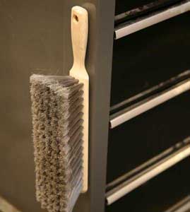

                              With a 1/2" neodymium magnet set in the handle, my "squirrel tail" will hang just about anywhere in the shop:

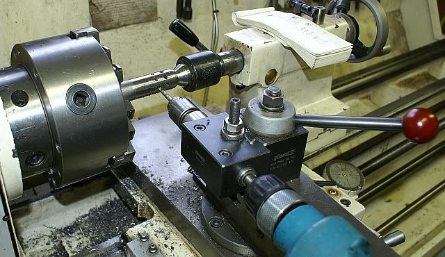

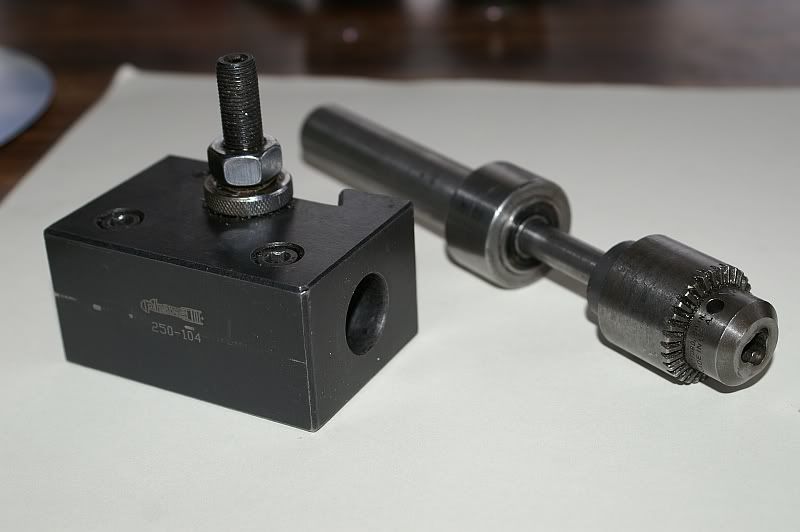

                              • I wish I could claim this idea but I can't. Gerald C over on the Chaski board posted this and gave me permission to put these pics up here. It's a QCTP drill adaptor that he made to drill some angled holes in a rifle brake.
                                Gotta make me one!
                                Link: http://www.chaski.org/homemachinist/...ic.php?t=84143
