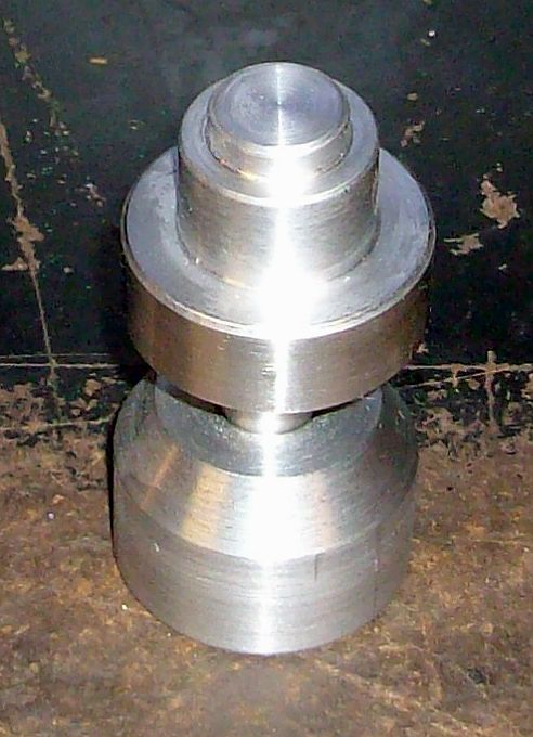

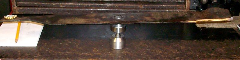

                    • Made a little tool to help me balance my lawn mower blades. Base and the cap are made of Mysteralloy and the pivot pin is hardware store cold roll. Sizes are mostly nominal. Cap was already that shape and it required little machining to achieve what I needed. Base and cap are 1.5" diam, pivot pin is .312 with a 1/2"-20 thread on the end. Cap has a drilled 5/8" hole drilled to a depth of 1". I made the cap with a 5/8" pilot to fit my blades but a cone could be easily turned for a more universal fit. The photo of a blade on the tool stinks, but you get the idea. Blade was out of balance hence the bottle cap sitting on one end.

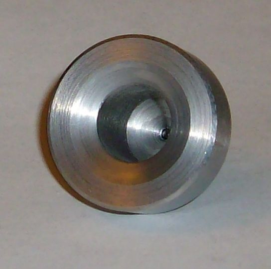

                      • Good work. Definitely something to add to my tool arsenal, and certainly better that hanging the blade on a nail as I have been doing. What does the inside of the cap look like?
                        Lewis Grizzard
                        • Originally posted by Dave C View Post
                          It looks like this. The chamfer serves no purpose. It's just there because there were some dings in the steel. Looks a little better too.

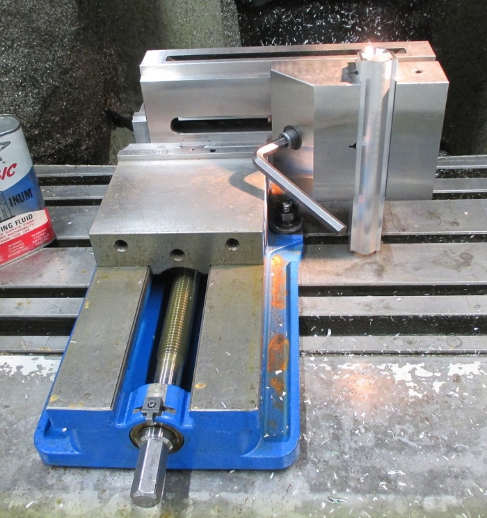

                              • Tall Part Mill Setup
                                Here is an easy way I came up with to work on parts that are too tall to hold in the regular mill vise. It consists of clamping a precision vise in the regular vise. The regular vise is trammed in and the precision vise is very accurate.
                                This makes it quick and easy to have the part very square in all directions. The vises shown are a 6" Kurt and a 5" precision. You can vary the size of the vises to suit the work.
