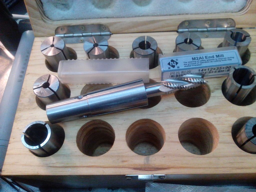

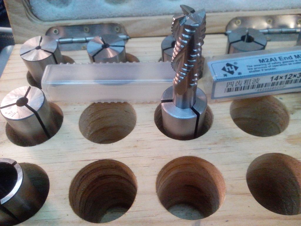

                  • 12MM MT3 Collet
                    Yay! I made a collet... AND IT WORKS, for a change.
                    I've been experimenting with ordering endmills and whatnot from China. Seems they like metric as the only stuff in fractional seems to be uber-junk. Don't yet know if the metric stuff is in anyway useful, but at 1/5th the cost, it seems worth the try.
                    But, the metric MT3 collets I can find, few and far between, are stupid-expensive. So, I made one, 2 actually. The first was one for a Vertex collet holder I have... had a lot of trouble with it, asked a bunch of questions here, and made it work well enough. But, sometimes I need the headroom, and my quill (along with everything else) is MT3, so I thought I'd have another go.
                    Turned out really well, if I do say so.

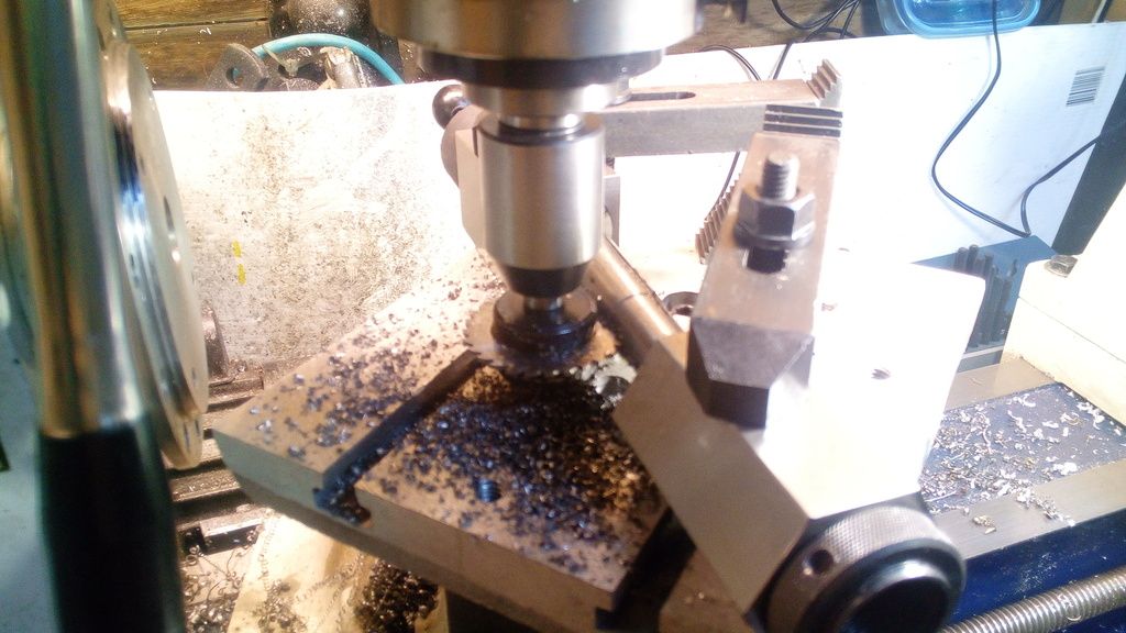

                    I didn't bother taking much in the way of photo while making it, other than this one whilst running a slitting saw.
                    Basically, I turned the outside taper while leaving stubs on both ends, different sizes. Then, I used my 5C collet blocks to index the slot, basically using the square one as an outside center for support. Then, I cut off the small end plug, chucked the big end, and drilled and tapped for the drawbar.
                    After that, I just set it in the spindle then drilled and bored to a slip fit on the endmill, right through the stub on that end. I slipped a 12mm aluminium plug I had prepared into it then trimmed off the stub on the nose, which was holding the slots apart. Once that was clear, I tightened the collet down on the plug and finished up the nose. According to the blue, the taper seems about right. I doubt I'll bother hardening it.
                    Easy enough that I think I'll make a couple of extra blanks the next time I need one, maybe a couple out of aluminium for any one-offs that come along as well.

                    • Looks real nice David! Now you will be able to make any size you need from here on out!
                      • Good work, Dave! If you're going to make spares, make a bunch 'cause you'll use 'em!
                        Pete

                          • Originally posted by fixerdave View Post
                            David, that is tremendous! I don't know why, but I really love seeing people make their own collets.
