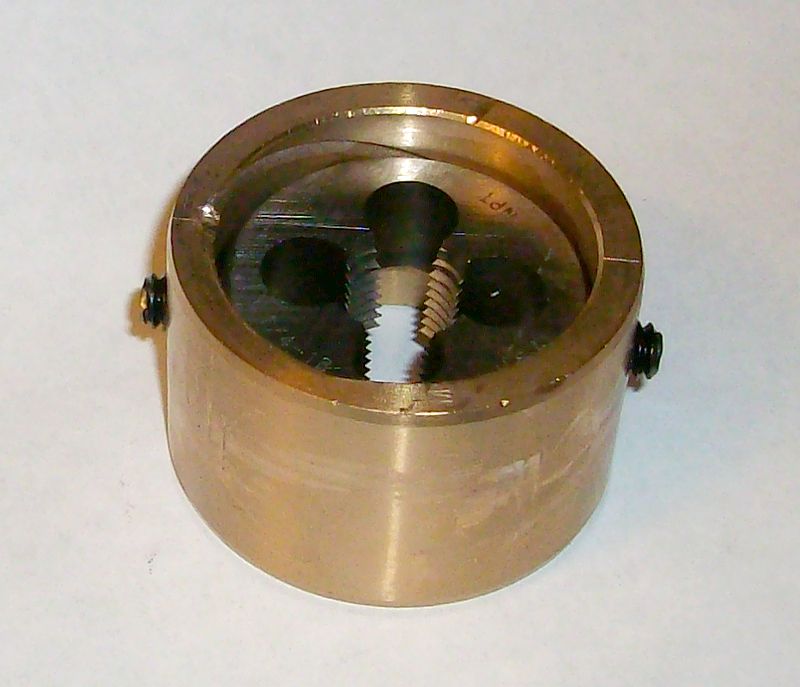

  • Just did up a post on a pipe reducer I made. It involved a 1/4NPT male thread for which I used a die. Long ago I purchased a Hanson/Irwin tap & die set covering 9/16" to 1" UNC and UNF. It came with a 1/4"NPT tap and die. During a previous project the 1/4"NPT hex die broke. Apparently Hanson decided to make a limited run and if you broke the die, tough. I won't discuss that here. Long story short, I got a round die as a replacement. I have no holders for round dies and I'm not going to build or buy one for just one die. I dislike round dies by the way. While making the aforementioned pipe reducer I managed to get the die far enough onto the work that it jammed. I was using channel lock pliers to turn the die. Get the torches and pitchforks. I managed to get a full thread but I had to get the darned thing off the work. Sandpaper wrapped around the die didn't work, bigger channel locks didn't work... I made this.
    As luck would have it, I had a bronze, air brake s-cam bushing with an ID perfectly matched to the OD of the die. A couple of drilled and tapped holes, a couple of set screws and I had soft metal that could be gripped. Die came off. I don't like stooping to the "hammer & chisel" level but sometimes the job just has to be done and redneck tooling has to be made.
