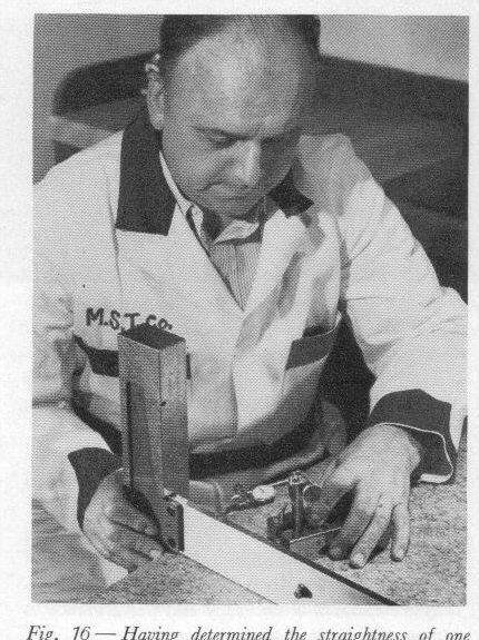

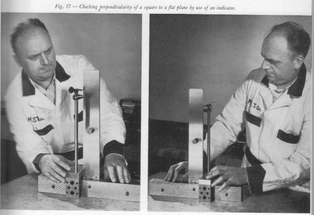

                            You don't need another square. You can't prove squareness by a vote among the references. There's a possibility that several may err in the same direction. With a surface gauge you have everything you need to prove the accuracy (or lack thereof) to the limits of your measuring equipment.
                            Here's a demonstration at Moore Special Tools book Foundations of Mechanical Accuracy.
                            First check that the blade is straight, neither bowed nor tapered.
                            Then, using the indicator and surface gauge touching the blade at two points, bottom and top, compare both sides as this guy is doing. The indicator reading is the double error. With the square shown at Moore, you can adjust it. If yours isn't adjustable you may have to lap or otherwise adjust, or at least note how far off and in which direction.

                              • What's he doing?
                                That's how we make optical flats: lapping three units against each other in a cycle. They routinely get down to lamba/10 that way.
                                You can also make right angles that way, by lapping three units against each other. I never said it was easy though.
                                Nice old photos, but I have to confess, I cannot see what the guy is actually trying to achieve there. Perhaps you could explain it in some detail to me?
