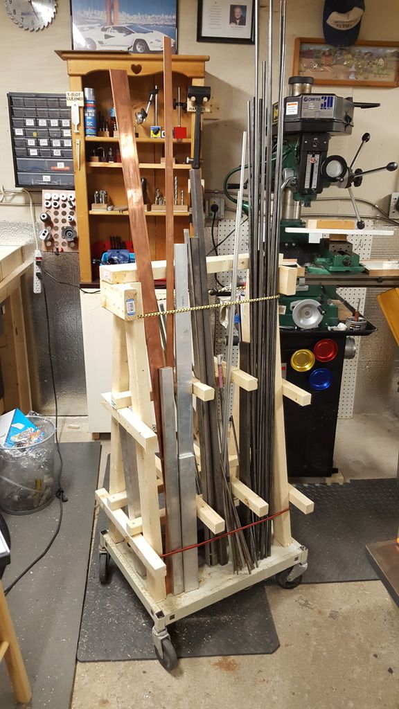

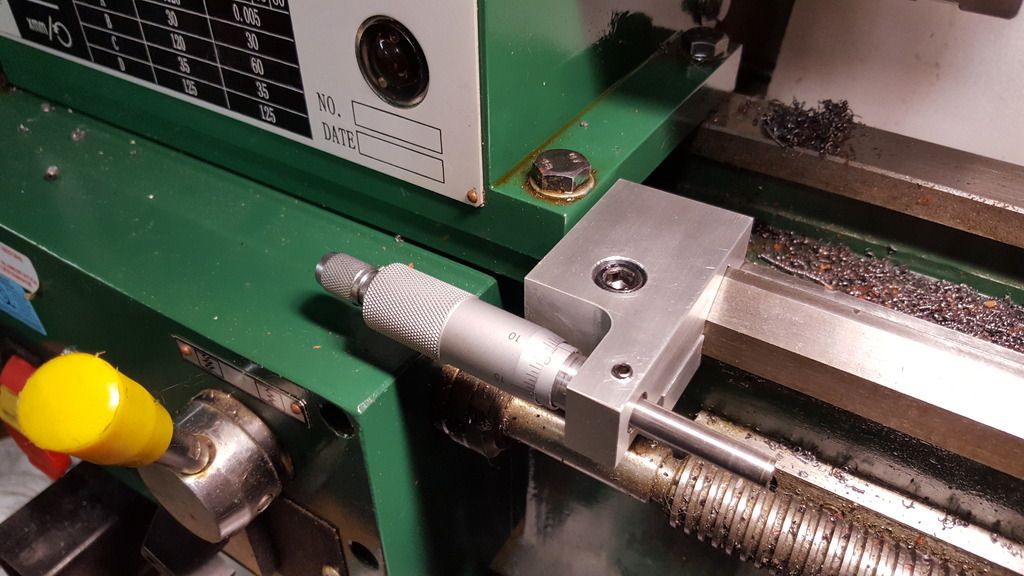

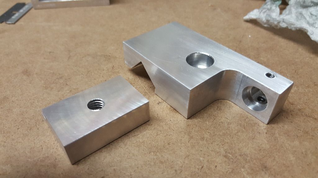

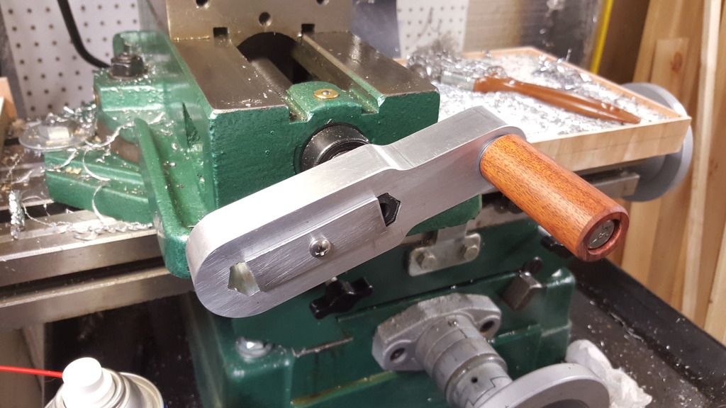

                              • Been hard at work after reading every page of this thread, made a big long list of things to do. Pretty new to this stuff so it's been good learning.
                                Wooden cart for stock storage:
                                Speed vise to replace the absurdly dumb handle that came with my import vise:
                                Lathe micrometer carriage stop:
