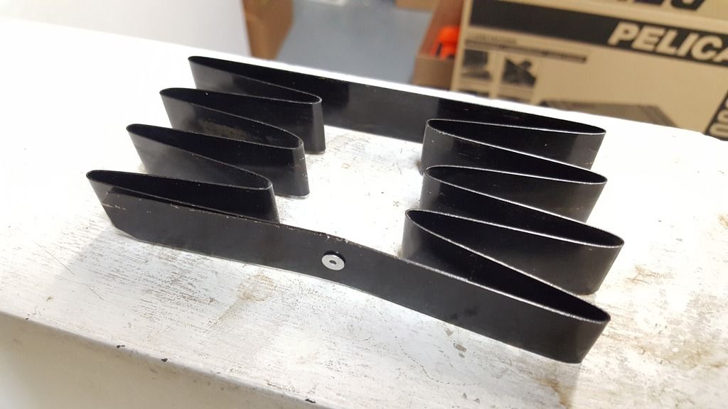

  • Parallel spreader made from crate strapping, to hold parallels when the jaws are pretty wide:

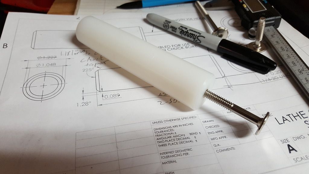

    MT4 adjustable lathe chuck stop for aligning thin parts in the lathe with minimal jaw depth

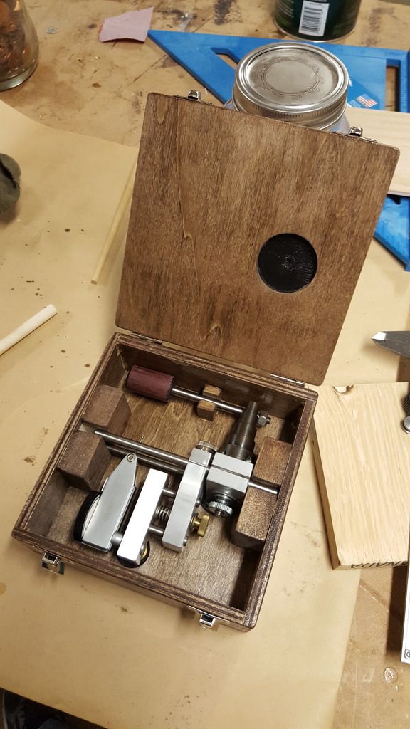

    Zero Set DTI holder based on some of the designs here and what's commercially available:
    Made a simple plywood finger-jointed box for the DTI holder:

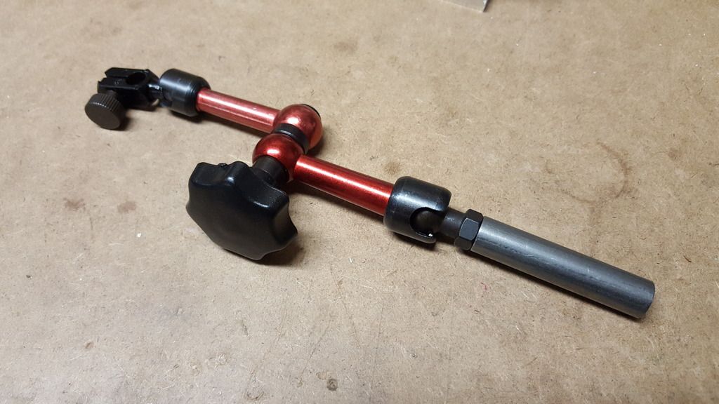

    • Little mod for my cheapo indicator base, taking the arm off and putting it onto a 1/2" rod to use in the mill spindle, excellent for setting the vise and other simple indicating jobs.

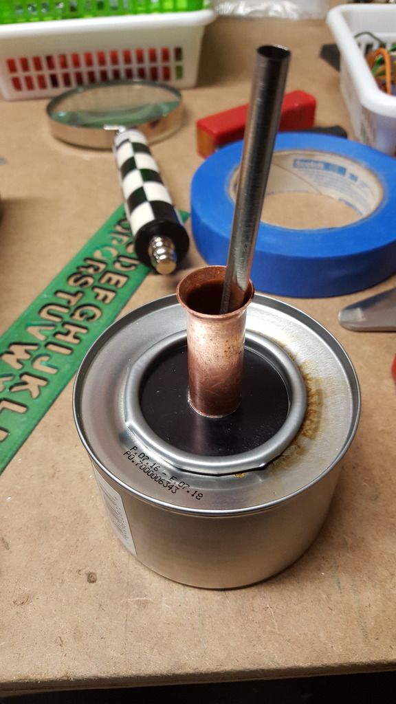

      Un-spillable oil pot for acid brushes:

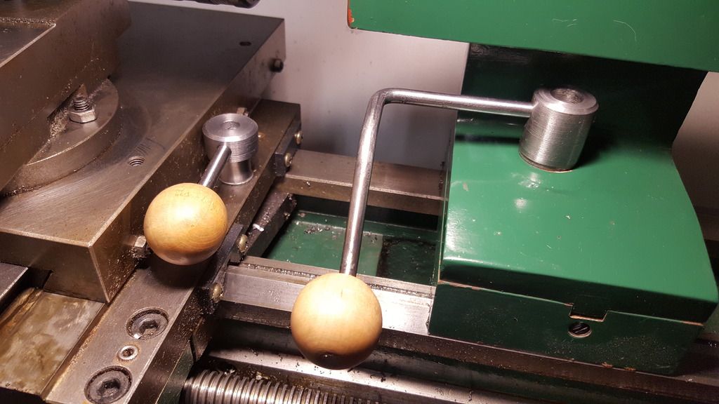

      Levers to replace the nuts on my Craftex B2227L lathe:

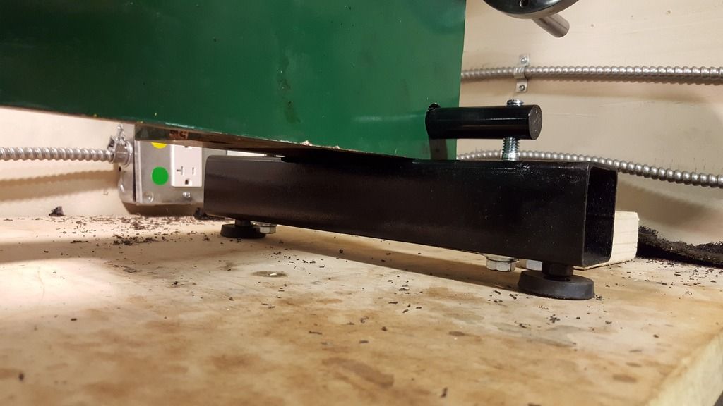

      Level-able feet for the lathe too:

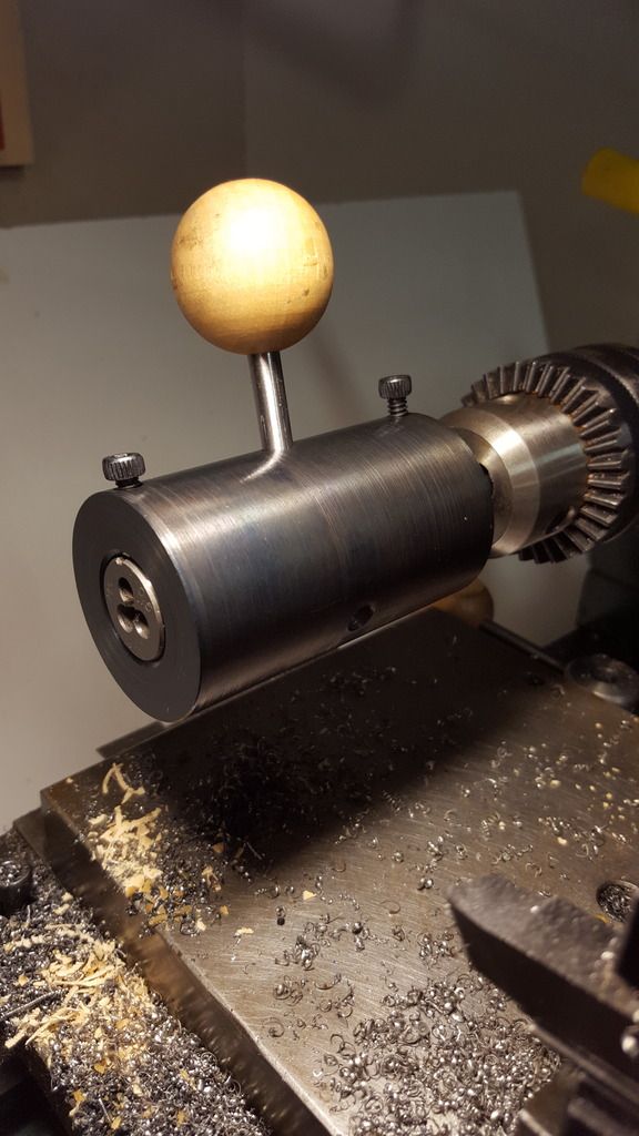

      • 13/16" and 1" tailstock die holder:

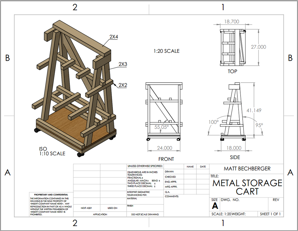

              • I LOVE the stock storage cart and would like to make one just like it. Any chance you could provide the major dimensions? Would you change anything if you made another one now?
                Thanks!
                Dave
                • Originally posted by DaveR View Post
                  Thanks!
                  Dave
                  Here's my drawing. I was going to make a bigger one but I had a old AV cart and I wanted the wheels, but they weren't looking like they'd be easy to put on a new cart. So I cut the base off the AV cart and used that. It was 18x24 not 24x30 like my original plan was. I adjusted my drawing to match what I built not what I had originally planned.
                  Works great so far but its still pretty new.
