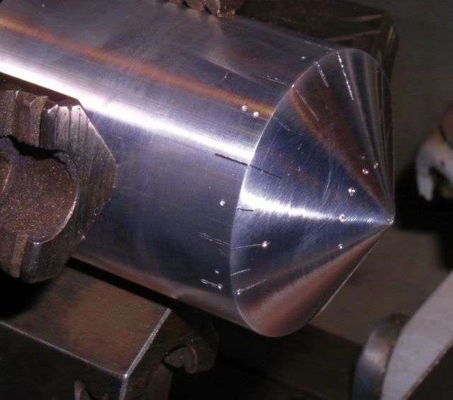

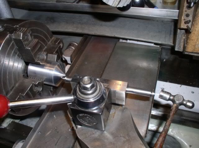

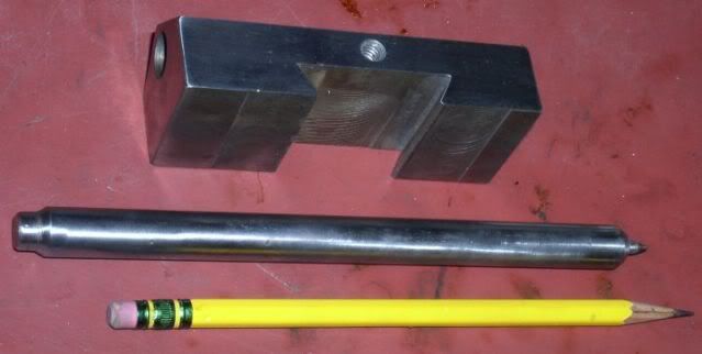

                    • Tool holder holds Punch / Scribe
                      Shaft with sharp pin inserted in end slides in tool holder. Tapping with hammer will give center punch mark for laying out something like bolt hole pattern.
                      Pushing in on punch/scribe while moving saddle or cross-slide will draw lines.
                      Just a sliding fit of Punch/Scribe in tool holder

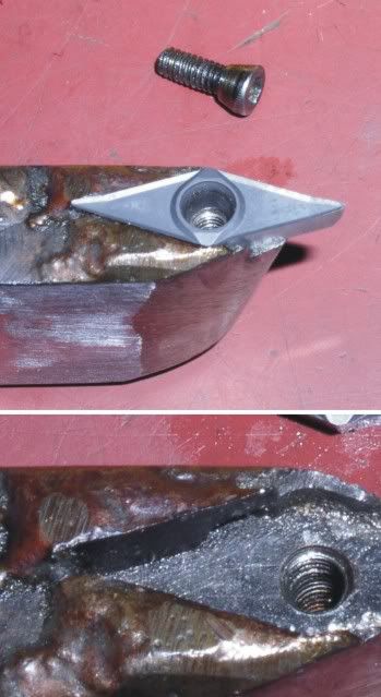

                      • Method of making insert pocket.
                        To make a hard to machine pocket such as this pointed diamond insert.
                        Machine pocket big enough that insert will fit in.
                        Oxidize the insert by overheating with something like oxy-acetylene torch.
                        Brass (silver solder or soft solder also) won’t stick to the oxidized surface.
                        Turn taper on socket head screw to match what is needed for insert. Drill and tap for hold down screw and screw insert into place.
                        Braze in the area need in the pocket trying not to over flow atop the insert.
                        This insert holder should have had more support under tip.

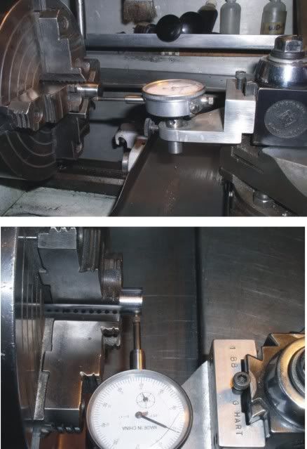

                        Just another idea on tool post indicator holder.
                        Have a lower leg that mounts under indicator.
                        Have post on bottom of indicator that is held in holder with enough friction that it can rotate.

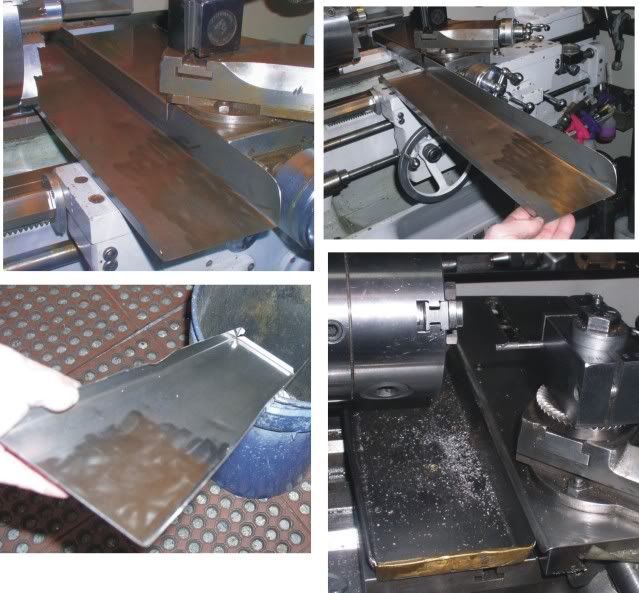

                        Upper chip tray sits on saddle.
                        Sheet metal fastened atop cross-slide has angle bent down on chuck side and slide out chip tray has bent up side that fits in side space next to cross-slide.
                        Tray needs to be removed anytime chuck jaws or work extends enough for possible interference with tray.
                        Tray catches small parts that would normally fall in lower chip tray and makes for easier swarf clean up.
