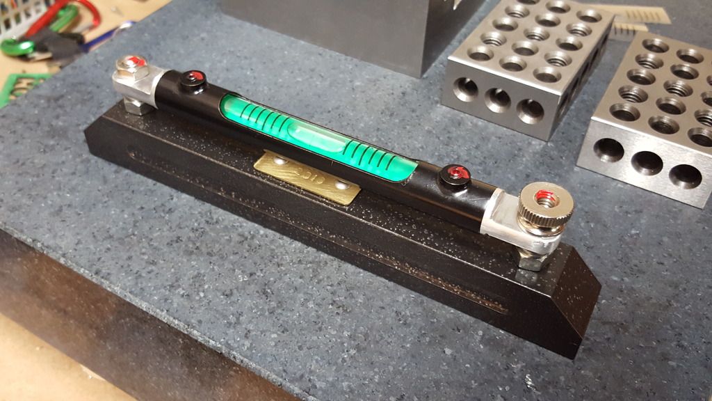

                      • After some time fiddling I think I've finished my precision level project;

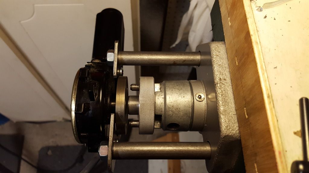

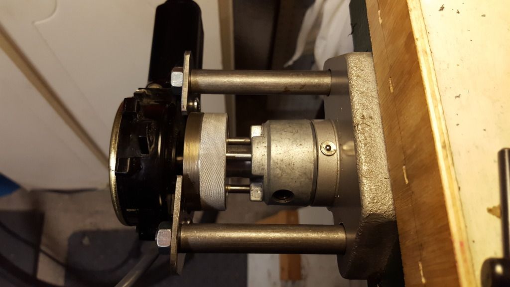

                        Also built a power feed for my mill drill, works great off my PSU but now I need limit switches and PWM speed control. Uses a car power window motor with a new shaft on it. Runs about 10 to 90 rpm which I think will work well for fly cutting.
                        Uses a dog clutch which is operated by hand when the machine is stopped.
