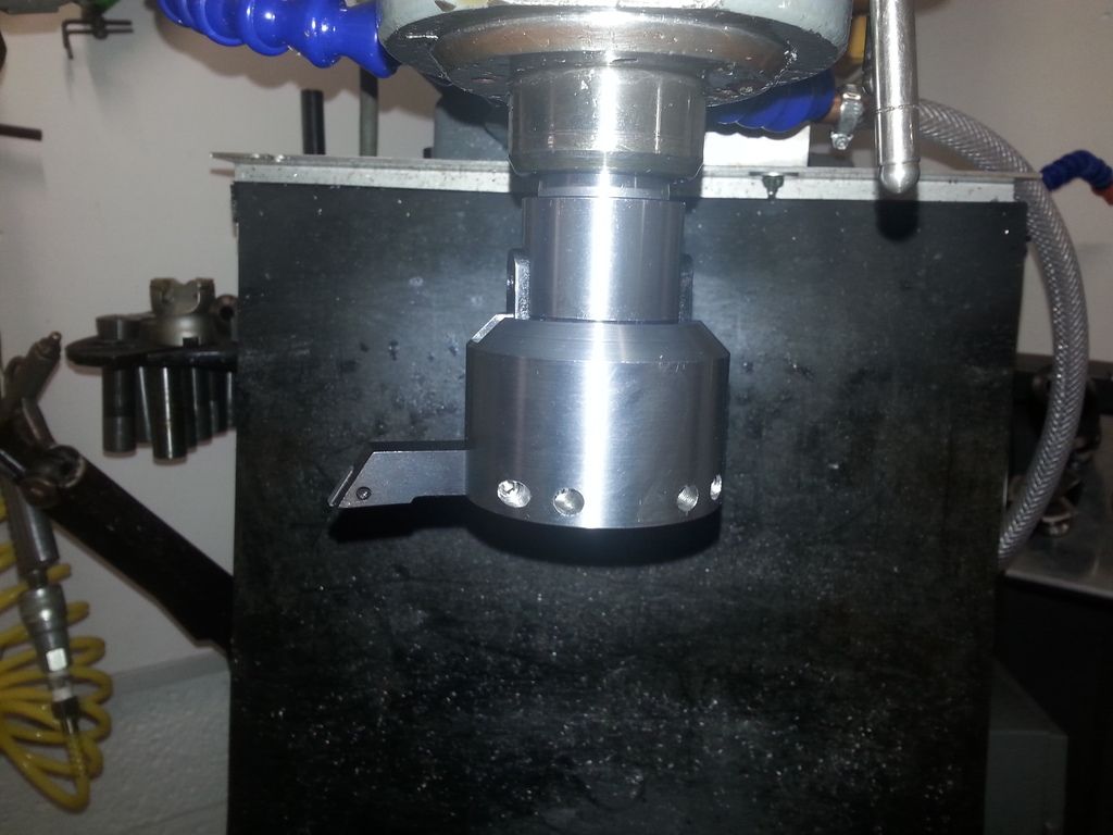

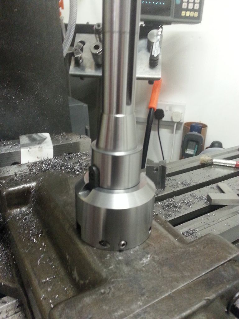

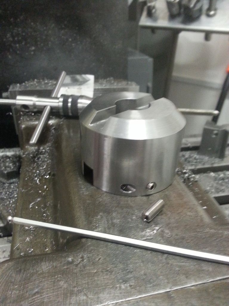

                  • Indexable Flycutter
                    An Indexable Flycutter using a commercial 12mm DCMT left hand toolholder and a far eastern R8/22mm shell mount.
                    For some time I have needed a medium sized flycutter so I have tried to make a fairly rigid item using some propriety components.
                    Body machined from EN36
                    Added a shop bought R8/22mm Shell mount
                    Paul

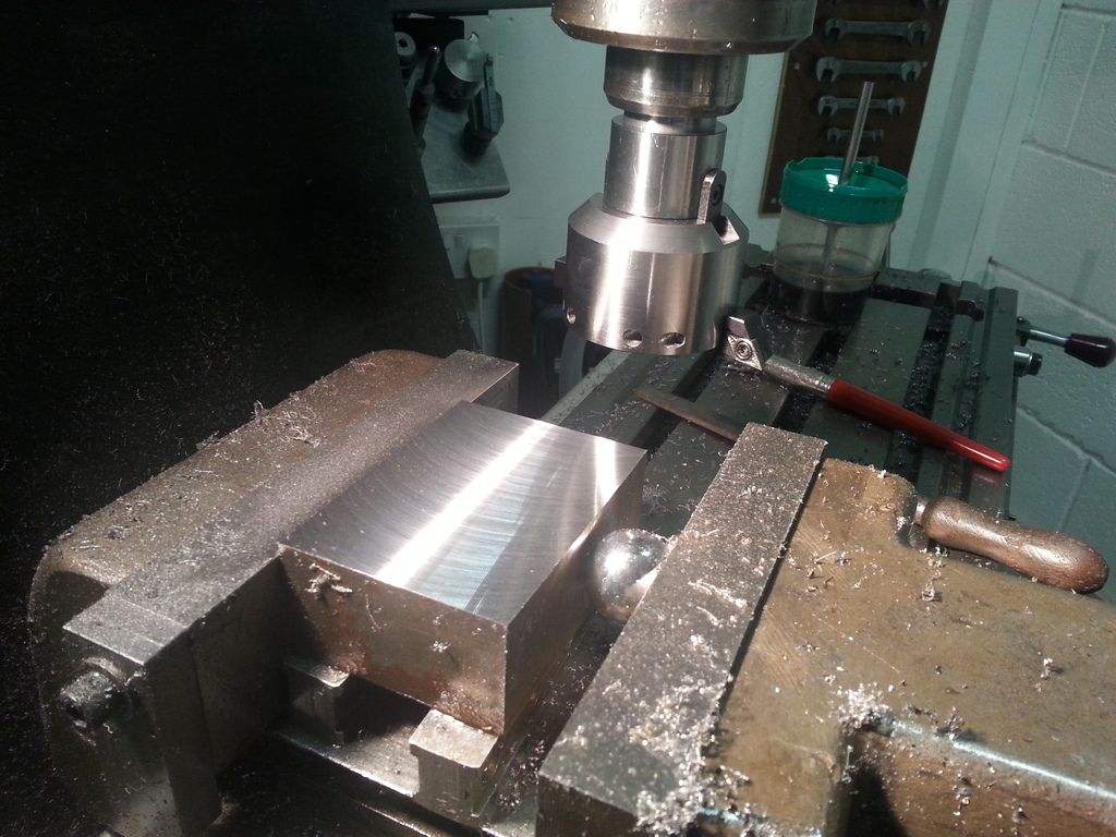

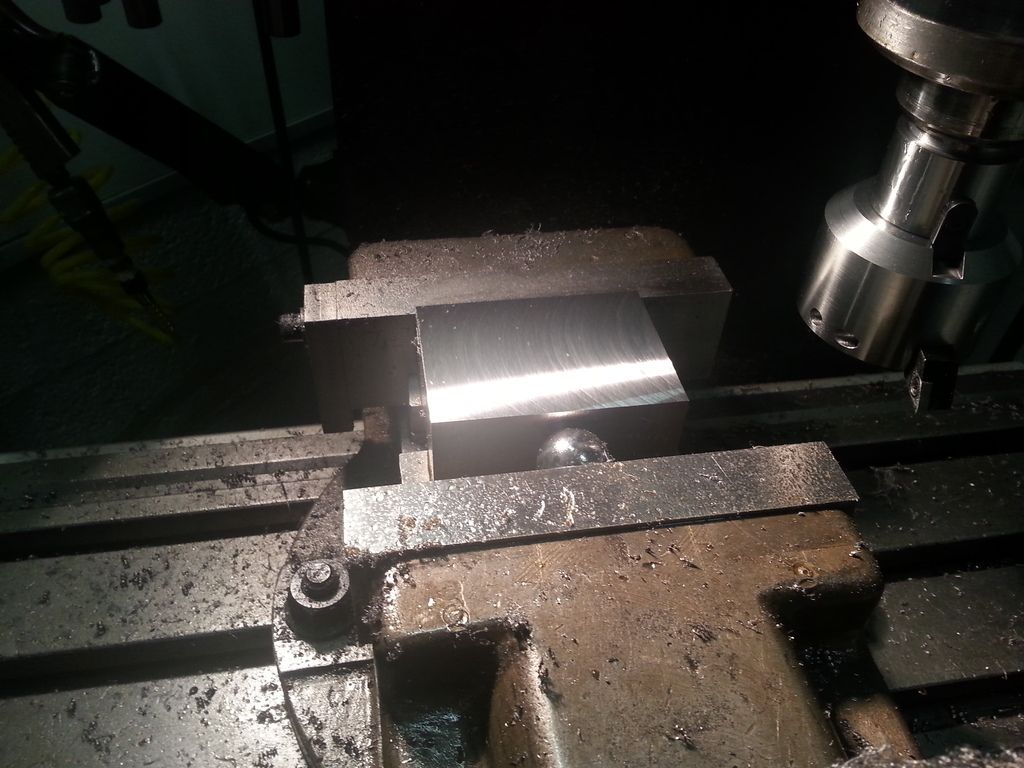

                    • Indexable Flycutter in action

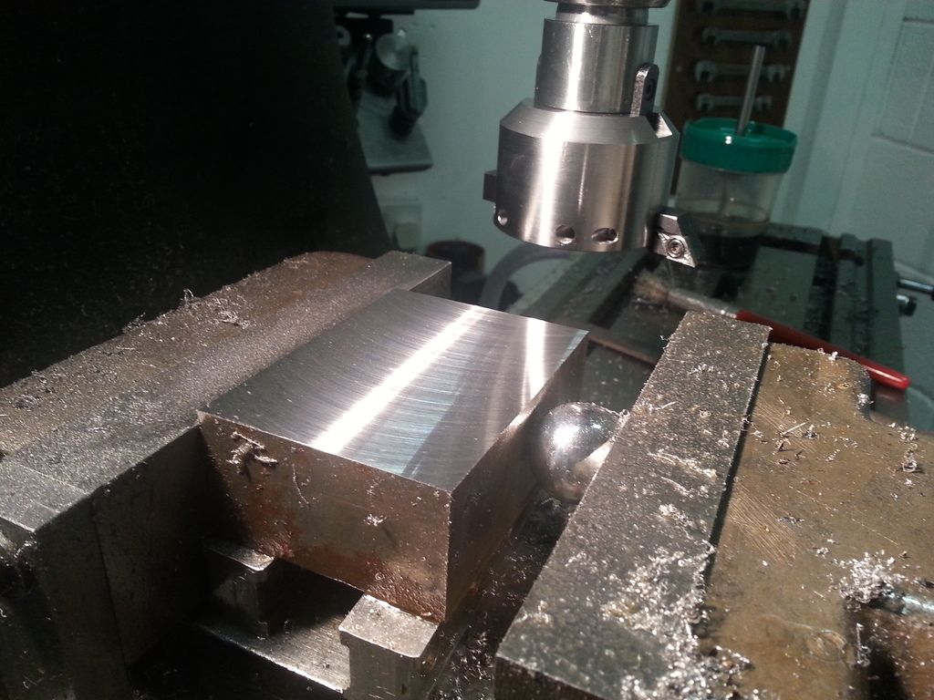

                      • Indexable Flycutter DCGT insert
                        Changed the uncoated Kennametal DCMT insert for a Korloy DCGT aluminum grade one, reduced DOC to 0.002" and upped RPM's to 1800, nice finish,
                        material is EN1A (1215?)
                        • whats the round ball for?
                          san jose, ca. usa
                          • Originally posted by gambler View Post
                            To make sure that one face of the workpiece is square with the fixed jaw of the vise, even if the sides are uneven as might happen with a sawn piece of stock.
                            The sequence I was taught was, 1) face off one of the largest faces, 2) turn to place it against the fixed jaw getting one square corner, 3) turn so the face just finished is against the base of the vise getting two faces now parallel and square with the first, and 4) turn to do the 4th face now that you have basic squareness. To get the last two you do now need an external square reference to get side 5 square with two adjacent faces and then you can finally do the 6th parallel with the vise base and all should be good. You'd use a ball, round stock or other equalizer with the first three cuts to be sure of square accuracy.

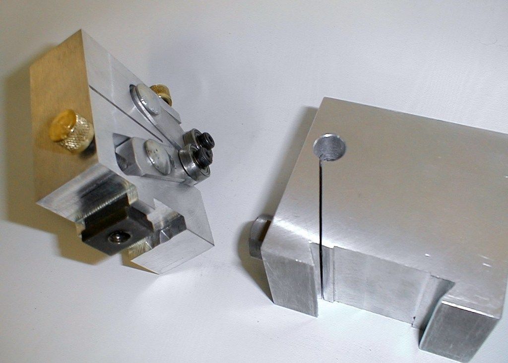

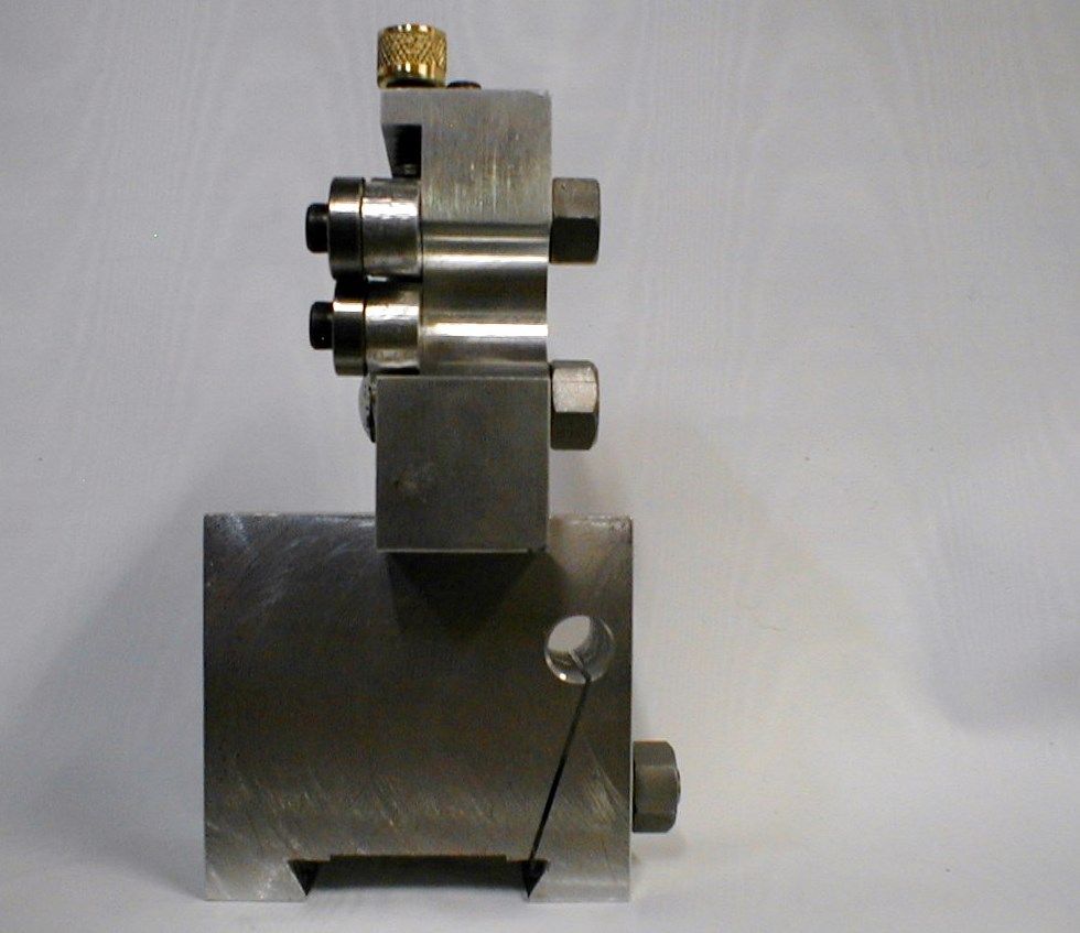

                            • This is a travel rest I made to fit my 12 inch Atlas/Craftsman lathe. [img][\img]
                              [img][\img]
                              I designed it to accommodate workpieces of diameter down to 1/8 inch and at least ¾ inch at the largest. I wanted rollers and found that to get the maximum benefit from the rollers that I would need to try to catch them at about 8:00 and 1:00 positions. To make that work, the bottom slide was positioned at a 25 degree angle and the top roller carrier was made to swing up and out. The roller carriers, top block and bottom block are all made of aluminum. Aluminum on aluminum, because of the friction, clamps up very securely.
                              The bottom block is 3.38 x 2.15 x 3.07 inches. Basically just what the rough stock I had cleaned up to be. The top block ended up 3.4 x 1.25 x 3.07 inches. The bearings are ¾ inch OD and ¼ inch ID and run on shoulder cap screws. [img] [\img]
                              The bottom block clamps to the cross-slide and can double as a slide stop. It may also find use for attaching other items to the carriage in the future. The top block assembly has a captured T-nut and locating ears. Because I had extra material, I also fitted it to the bottom block, extending a bit below the block to allow that material to further support load.
                              I am also starting a separate thread on this.
                              • Gary thats quite ingenious, better than a fixed follower rest has the ability to accommodate varying toolholder/toolpost setups.
                                Paul
