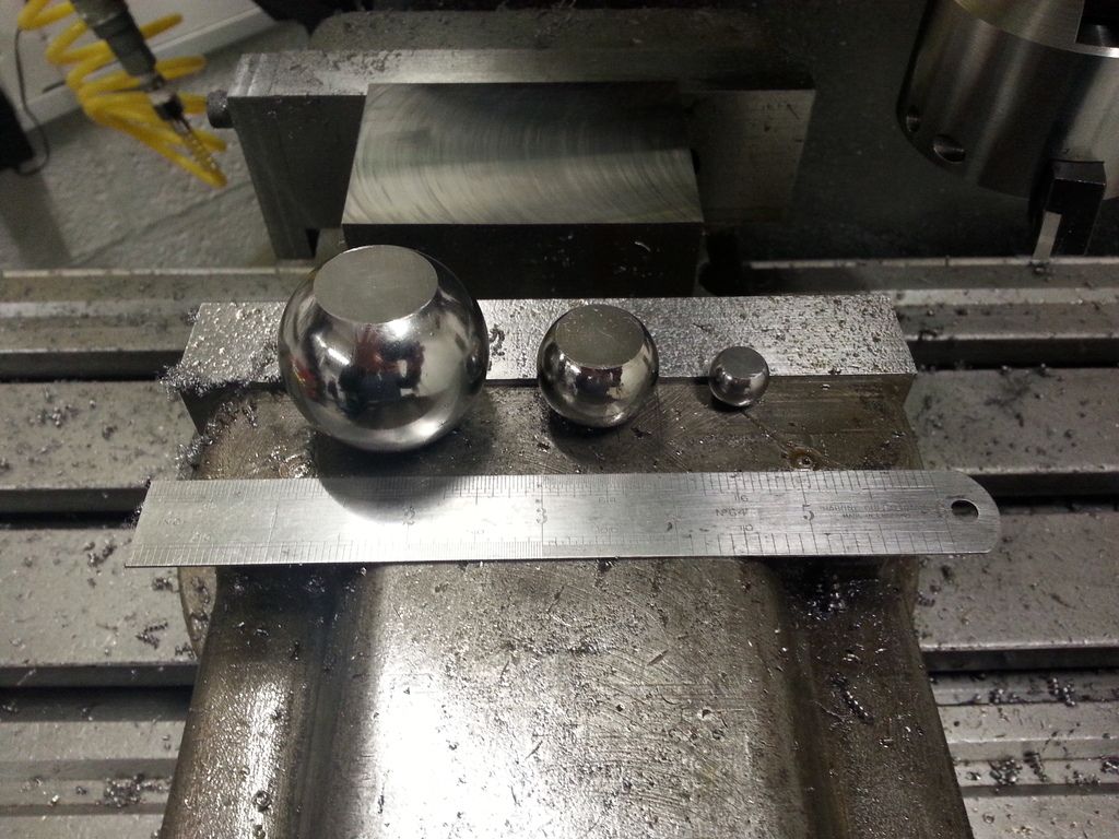

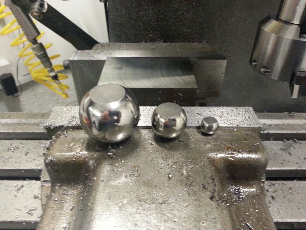

        • Originally posted by gambler View Post
          whats the round ball for?
          Originally posted by TGTool View Post
          To make sure that one face of the workpiece is square with the fixed jaw of the vise, even if the sides are uneven as might happen with a sawn piece of stock.
          The sequence I was taught was, 1) face off one of the largest faces, 2) turn to place it against the fixed jaw getting one square corner, 3) turn so the face just finished is against the base of the vise getting two faces now parallel and square with the first, and 4) turn to do the 4th face now that you have basic squareness. To get the last two you do now need an external square reference to get side 5 square with two adjacent faces and then you can finally do the 6th parallel with the vise base and all should be good. You'd use a ball, round stock or other equalizer with the first three cuts to be sure of square accuracy.
          Here's my selection of balls
          • How did you get the flats on the balls?
            • Originally posted by richz View Post
              The ones pictured went for a ride on my old T&C grinder but I have ground others using an offhand grinder then finished with a diamond hone.
                An alternate method is hard turning on a lathe. That is how I made mine.
