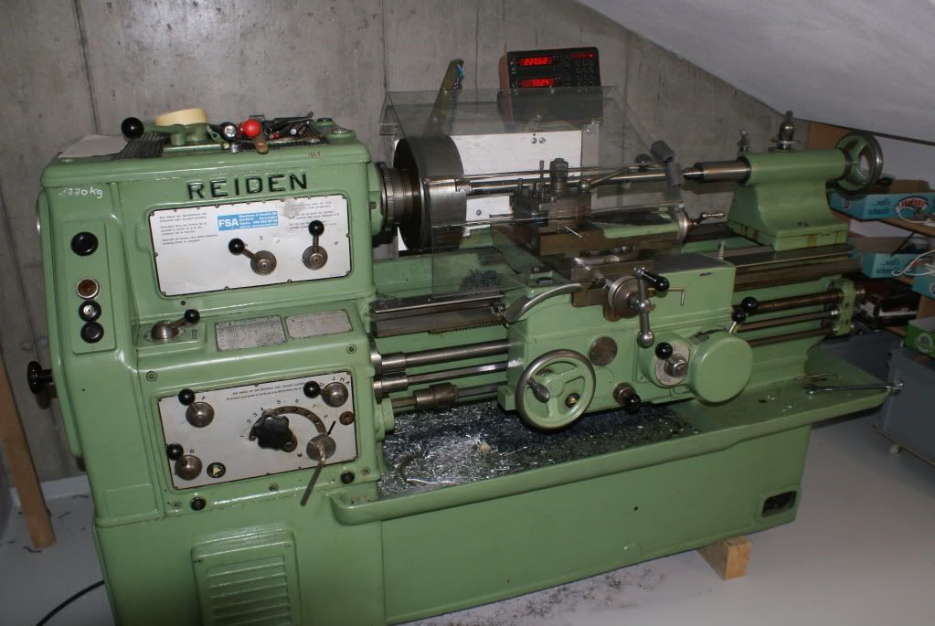

              • Originally posted by Sparky_NY View Post
                I would like to see more of that chip shield on the lathe ! I am so tired of being sandblasted by chips and them flying all over.
                Its pretty simple, piece of polycarbonate bend with help of hot air gun, mounted to piece of steel and the M12 bolt doubles as a hinge joint. Highly recommended after getting hot brass chip inside my nose!!
                And here is my fix to chuck running loose and trying to smash my toes:
                http://i.imgur.com/AMXil4X.jpg
                http://i.imgur.com/lQA9KEZ.jpg
