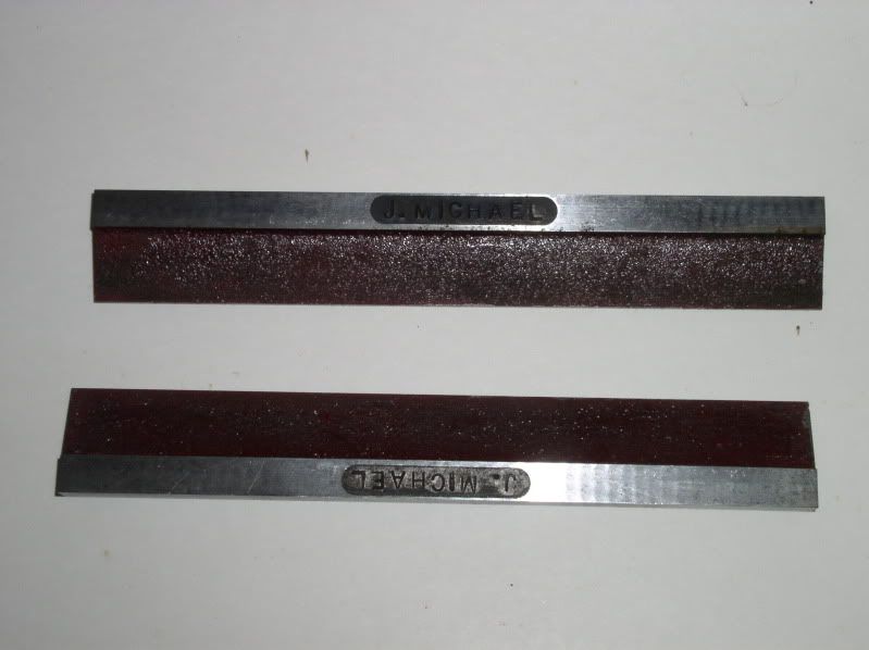

      • Sets of aluminum parallels - easy to modify to handle certain shapes, handy to use when drilling close to edges:

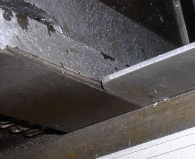

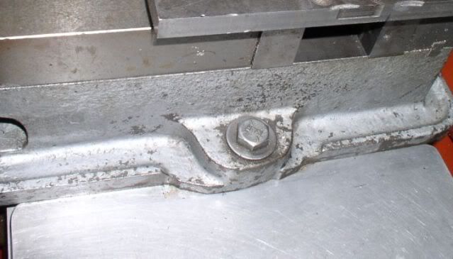

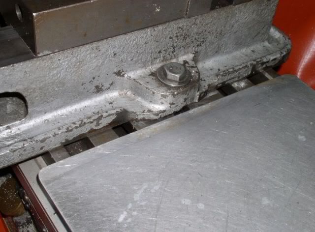

              • Keeping chips out between mill vise and table covers.
                Cutting small step in base of vise so table cover will slip under.
                Aluminum table cover pushed in groove between vise and table.

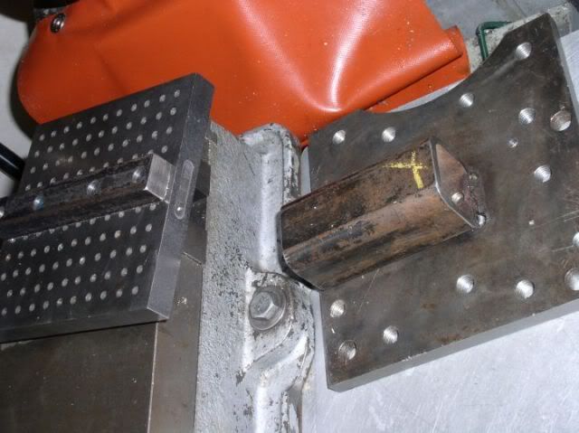

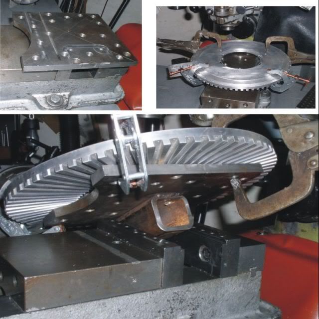

                • Mill vise table. Piece of half inch steel welded to some heavy walled square tubing. Clamp vise table in mill vise and clamp work to table using half inch tapped holes or clamps.
                  Another plate with bolted bar underneath for clamping in bench vise for set up and then transferred to mill vise. Holes are tapped 10-32

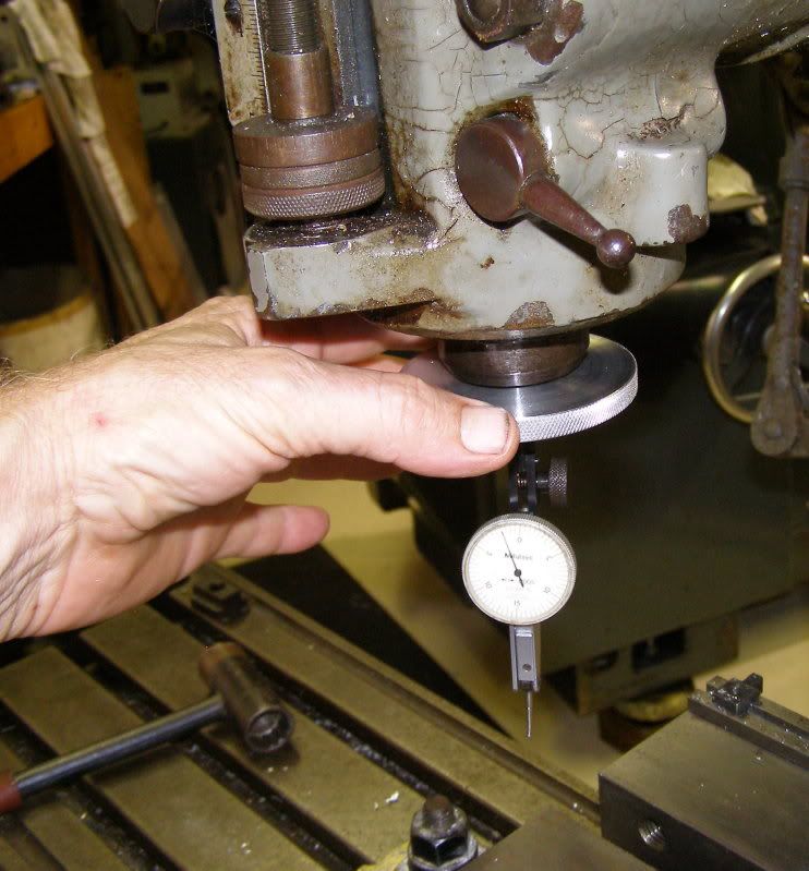

                      • It took about 30 minutes to spin out this holder from a piece of 2024 t4 aluminum bar that was lying in the stock rack. It has a stepped shank, 7/8" and 1/2" as my boring head has a 7/8" shank and the 1/2 makes it handy for other jobs. It also has a stepped bore so it will accept both 3/8" and 1/4" shank adapter accessories.
                        It makes it quite easy and handy to rotate the spindle for sweeping a bore.
                        The indicator holders that clamp to the spindle are OK too, but people tend to use them to rotate the spindle and the dial reading can be affected by doing so. This type of holder does not disturb the indicator reading.

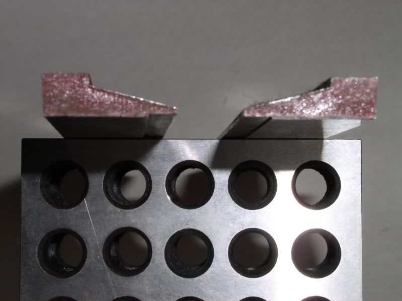

                        • Hold Downs
                          I don't think this has been covered recently. This is a set of hold downs for thin material. They will grip the edges of stock and press it down flat as the vise is tightened and leave the full top surface clear for machining.
                          Looked at on end view, the back sides are tall and are ground at an angle. The front edge is thin and has a small relief under. The action when clamped is to press in and down.
                          • Light comes on …tryfred smiles…hurries out into shop…yep that’s what those “odd” hold downs are for…tryfred goes back to finish lunch / peruse HSM and smiles some more…life is good. Thanks, TGTool
