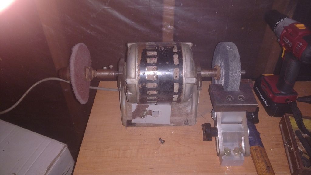

                Not the prettiest looking thing but I made the tool rest for this old bench grinder I acuired. The slides were made with a water jet but the rest on my home mill. It's a slower speed grinder 1725 rpm perfect for the Scotch Brite wheel on the other end . Gonna eventually make some guards for how unsafe this thing looks . I'd also have to say for how old this thing looks it's the queitess grinder I've ever used

                  Dang that looks like a washing machine motor. The only thing is it has shafts out both ends. It does look homemade.
