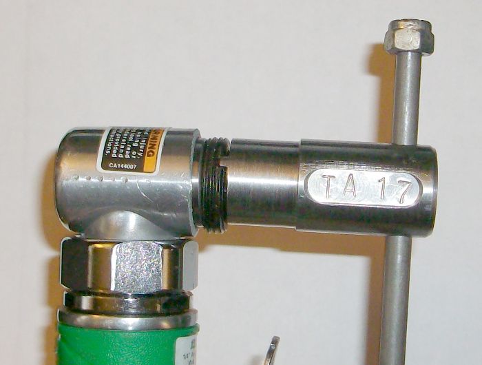

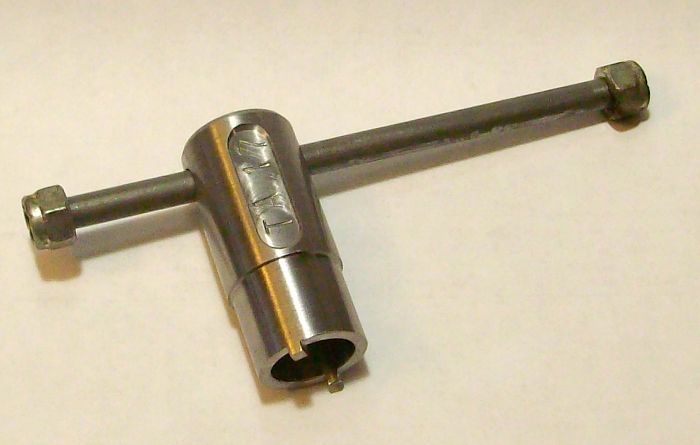

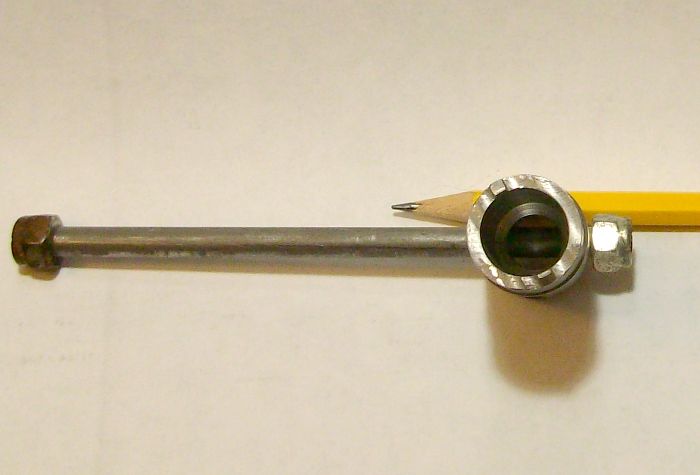

    • A coworker asked for a tool to disassemble 90 degree die grinder heads. His second job is being a maintenance man in a factory. They remove the spindles from these grinders and replace them with something else (not sure what). He tried removing the spindle nut and broke the housing (can be seen in the photos). I took the grinder home and made the pin spanner to fit. I gave him instructions on how to harden it. It's not tool steel, but from experience I know it will harden it enough to create a little bit of durability.

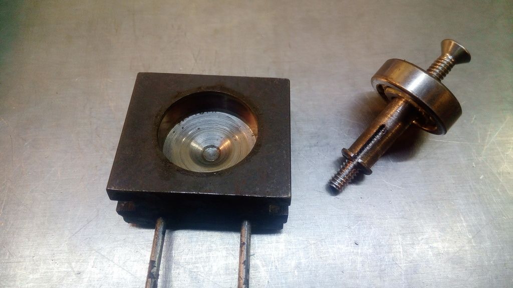

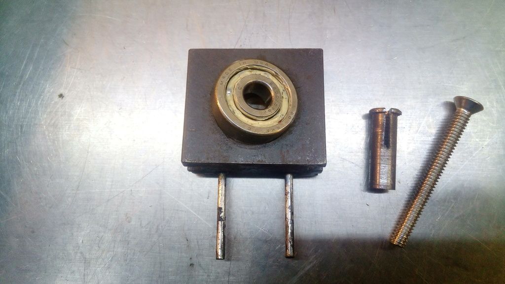

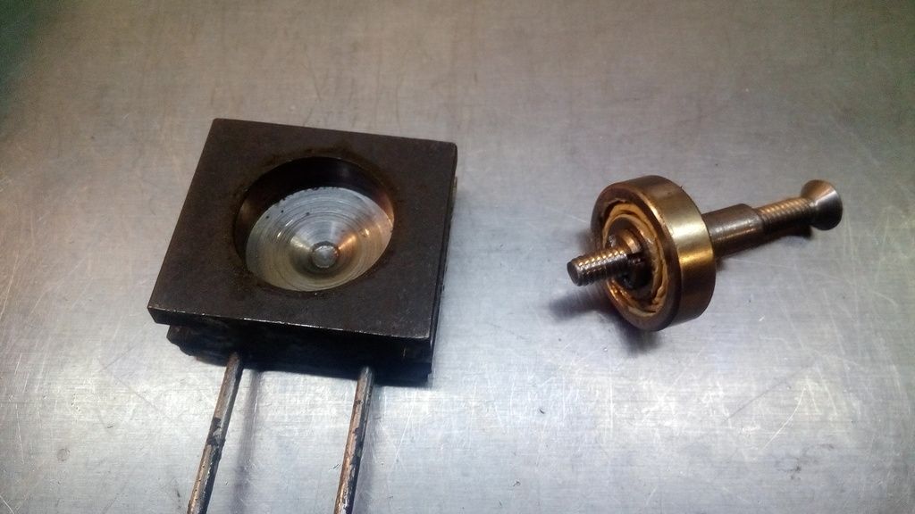

      • You ever run into a situation where someone pressed a bearing into a blind hole?
        Me neither... but I swapped some tutoring for a train and things changed. Been making all kinds of new tools for things I never knew I needed to do (or shouldn't need to do).
        Thus
        Basically, I just turned a chunk of steel, one end that would go through and one that would not, threaded it, then used an angle grinder with a cut off disk to do the slots... yeah, quick and dirty. Not shooting for the Pretty Tool of the Day award.
        In use, squeeze the slotted end together, tap it through the bearing, and then thread the bolt through. The bolt will spread the squeezed together end such that it can't go back through the bearing and, eventually, the end of the bolt will hit bottom and press out the bearing. Vice grips to stop it from turning... too lazy to mill flats. Worked well, and should last the 8 that I need to do.
        Well, of course I changed my mind and decided to make new bearing blocks anyway, so I didn't really need to do this... but that's just the way it's been going the last while.
        David...
        http://fixerdave.blogspot.com/

              I've heard of that but didn't think to try it. Then again, with the amount of locktite on these, I have my doubts it would have worked. Actually sheared a 1/4" bolt doing one today. Had to thread the topside of the puller thing, spin on a nut, and use a slide hammer to get the works out. Eventually resorted to heat. My understanding is that the bearings are actually supposed to be stuck on the shaft but able to move back and forth in that hole. But, on the bright side, I actually got to use my new left-handed drill bits. Actually worked
              I still have 4 to go. I'll try the grease trick on the next one and report back. It might even save the bearing. Thanks for the reminder,
