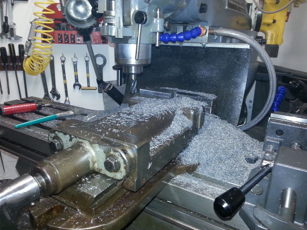

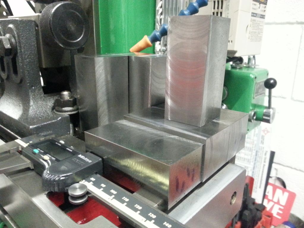

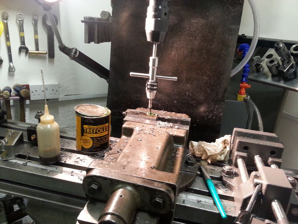

          More pics
          wow that is really nicely done!!
          I wish i can commission someone to made tool holders for my Tripan 111 tool post
