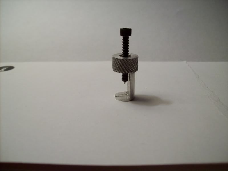

                Here's a real simple little do-dad I was just using yesterday.
                For a sense of scale, that screw is 6-32. This is used for pulling needles off of dial indicators and dial calipers when they need repair (or just to confound you're associates ). I made this two years ago or so to repair my dial calipers.

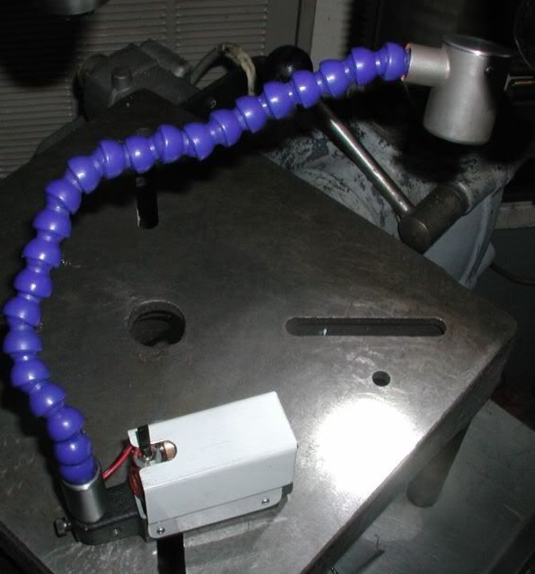

                    Using one of those Cree LED lights that Evan told us about. 4 AA batteries on a Mighty Mag base and some Loc-Line. Super bright light for poor old eyeballs that don't like to focus.
