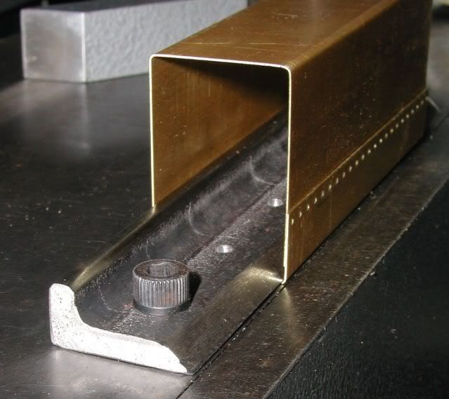

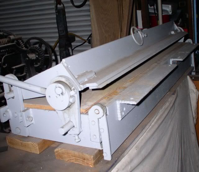

      • Made small hold down from angle iron. Drilled and tapped bed of brake. Used bolted on hold down to make small tank.

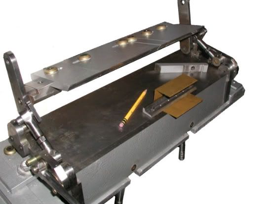

        Wish I could take credit for making the brake below. Was all rusted up when bought it at estate sale. Cleaned up and slapped some paint on it. Very well made brake would of liked to have known the builder. Was puzzled about angle iron that was on the folding leaf (not sure of terminology). After using seen what it was for. It gives a little more leverage pushing on the metal farther away from the bend line.

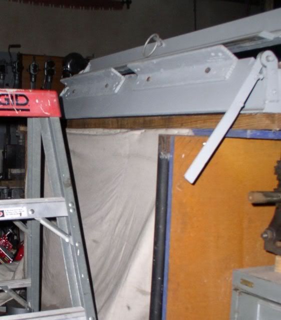

        Didn't have room for it. Put on top of little house that have for surface grinder, thinking would take it down when needed. Found out most the time, just use a stepladder and use it in place.

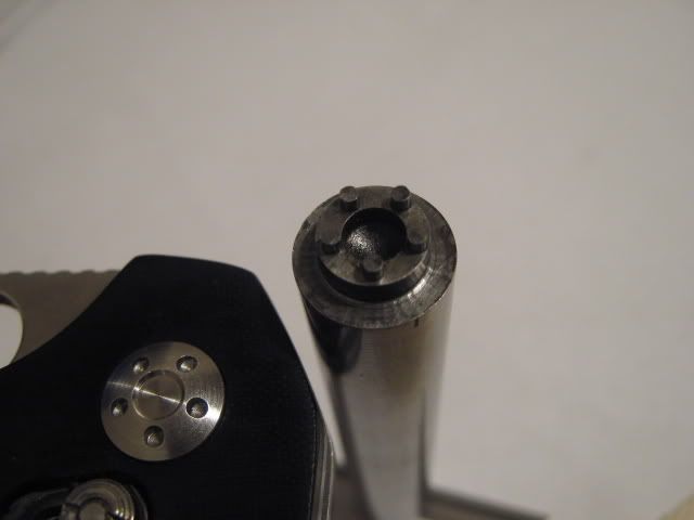

          • Another little key made yesterday.

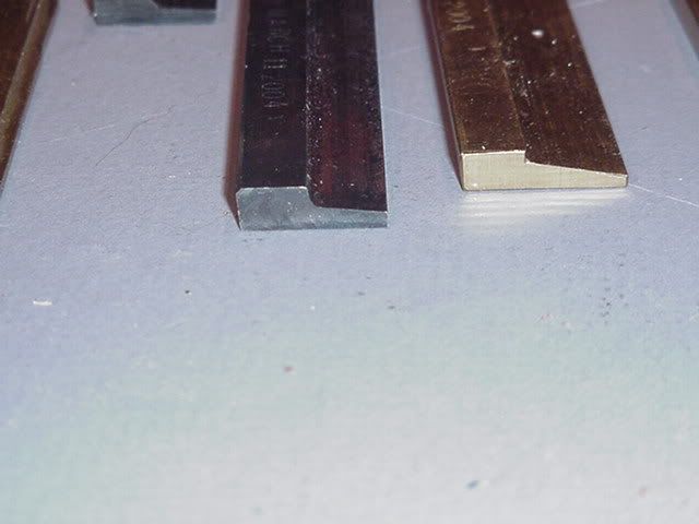

                • Set of hold downs for the mill. For those unfamiliar with them the two sides are at an angle to each other and as you close the vise it wedges the stock down on the clamping surface. The two round pieces are extensions for my Starrett Tubular ID micrometer. Pushes the capacity out to 20 inches.
                  And a set of HSS angle tool bits for use in wedge or piston QCTPs. Done on a surface grinder with my Tool Grinding Jig

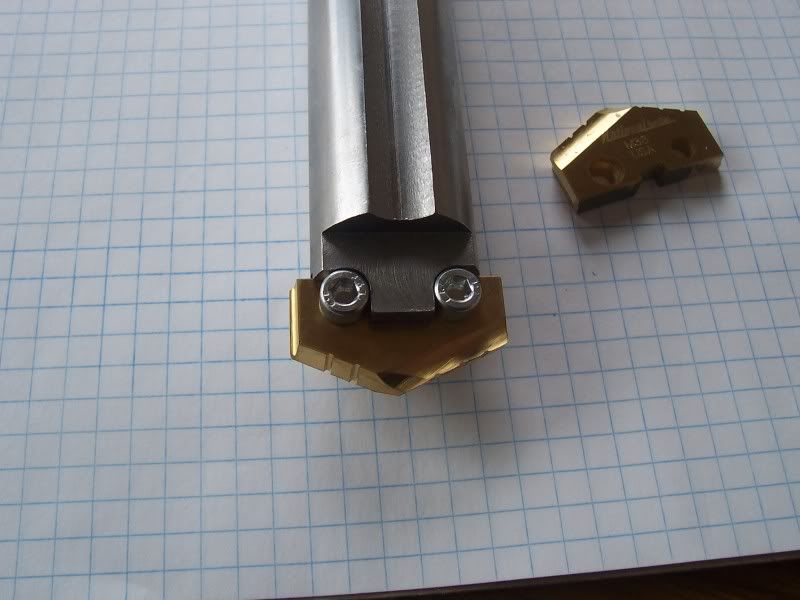

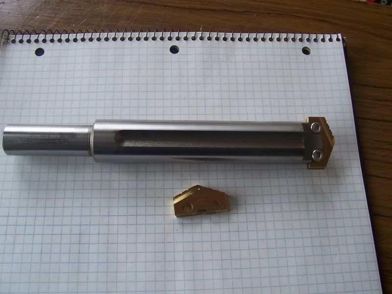

                            • Here is a pic of a spade drill I made a few years back. It takes a number 3 blade.There is a groove cut down the body on a small angle for flood coolant.
                              You can get the blades from ebay at a reasonable price. Just had some 38mm come in the mail today. > 10.00 each
