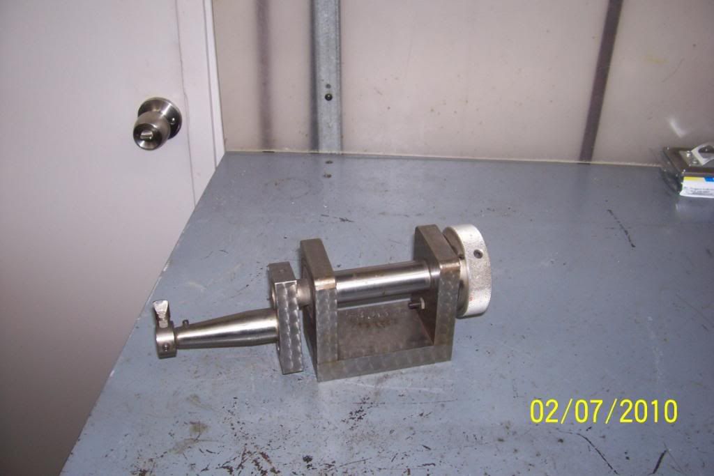

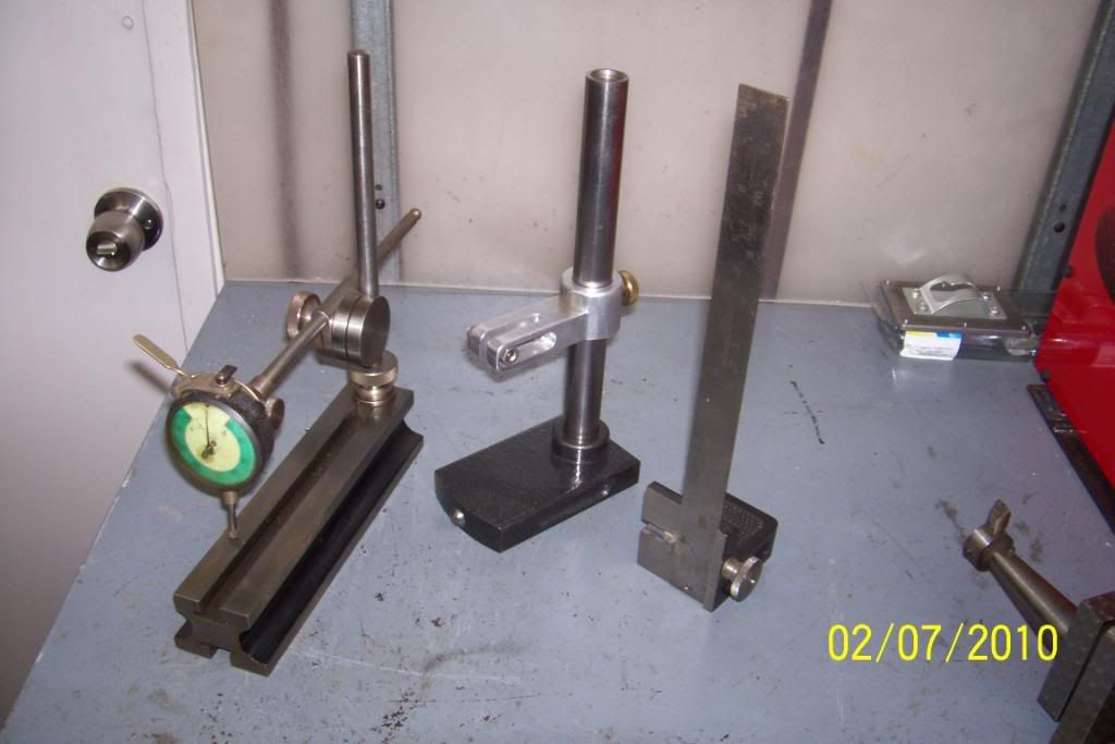

      • Well I have been watching this thread since it started. Very interesting. So I thought I would add my 2 cents worth and show some of my shop made tools.

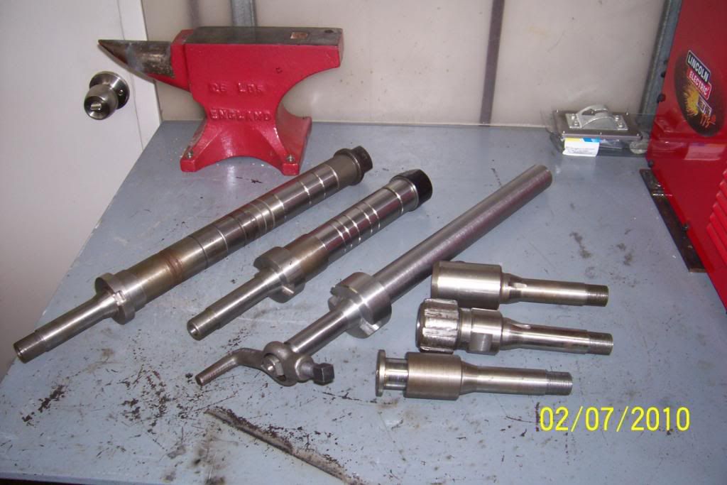

        These are shop made milling arbors for my Van Norman.
        This is some inspection tooling I made a copy of a Starrett indicator stand , a rule holder and a Square checker.

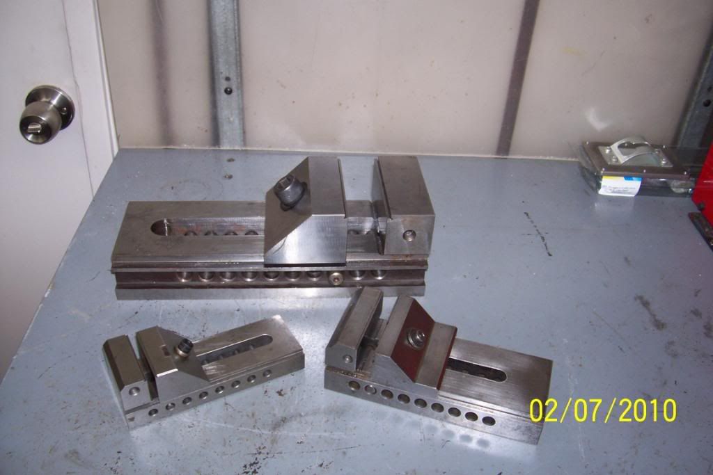

        These are 3 grinding vise`s I made over the years all harden and ground

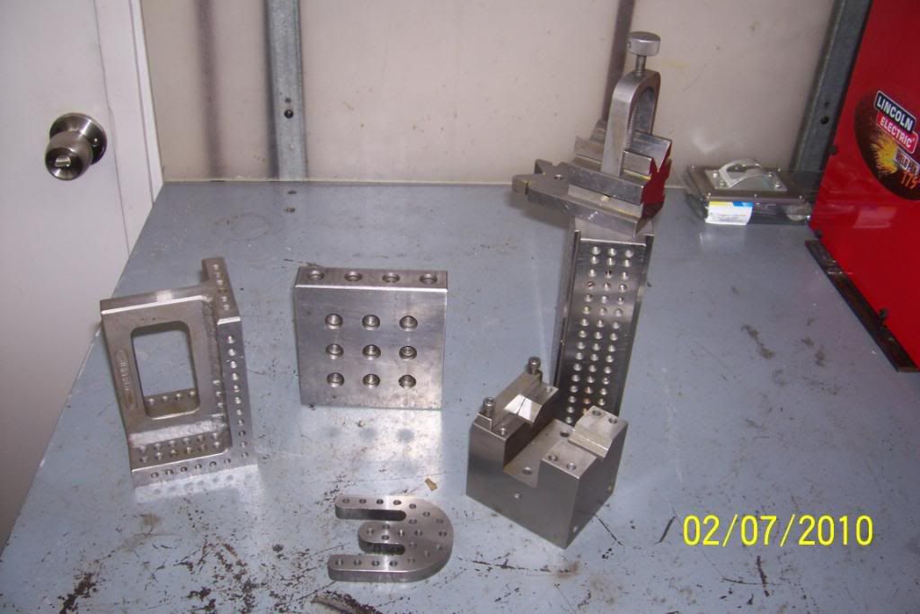

        This is a collection of grinder tooling I made over the years all haeden and ground to size . Angle plates 2 .A few v blocks and a few other set up blocks.
        Hope this gives some ideas

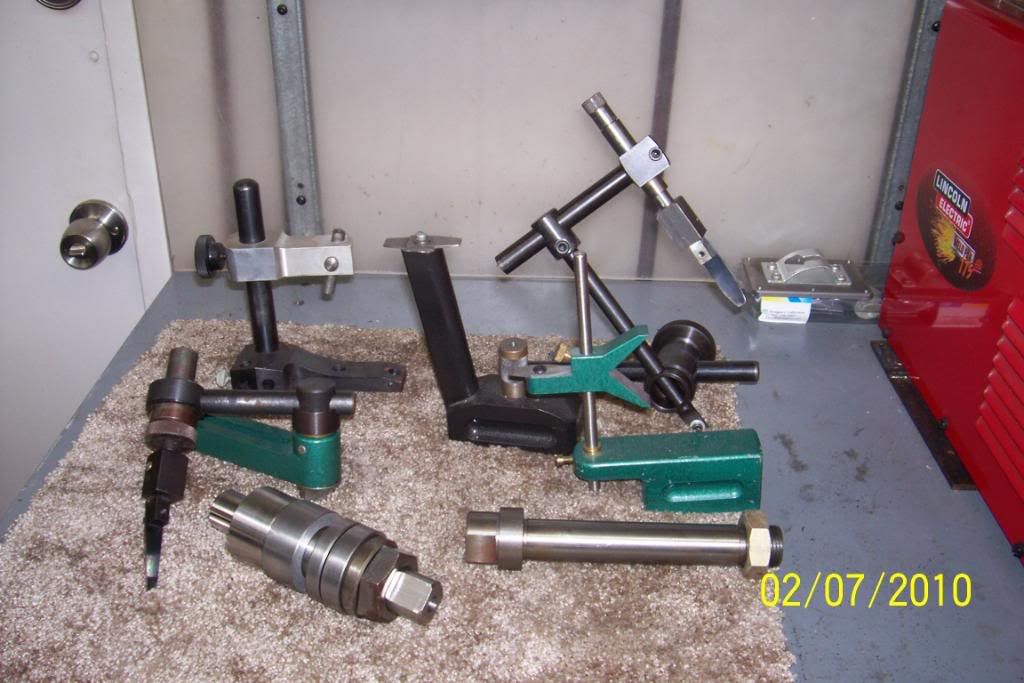

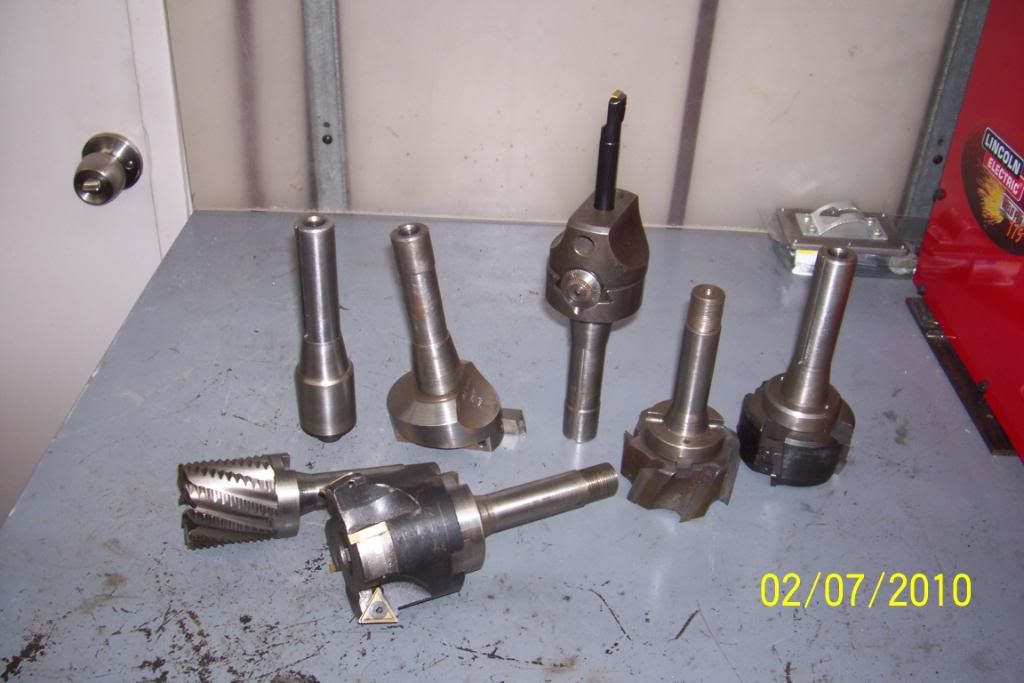

        • Something did not come out right so here is some more stuff I built
          Arbors and face mill holders along with a boring head all shop made
          This is tooling I made for my K.O.Lee cutter grinder . Can`t afford to buy so I copy the real KO Lee parts and build my own for free.
          This is a radius dresser for surface grinder to put radius on grinding wheel
          The next idem is a adjustable angle plate I designed and built many years a go.
          Hope you enjoy . This is just a drop in the bucket of just some of the tooling I have built .

          • Nice arbors Lane. Why is a dog clamped onto one of them? A+ for making the end mill holder. Bottom most tool on the right, face mill holder, slitting saw arbor or something else?
            • I`m still working on arbor with dog attacked need to cut left had thread on end but waiting on nut . To fit thread to the last arbor is for slitting saws . 1/2 inch bolt goes up threw bottom of plug to tighten all together.
              • Originally posted by lane
                What is the flat plate that's shaped like a "3" for?

                • What are the slots in the top part of your R8 holders for? (right after the taper.. I guess 'bottom' part really when installed)

                    • Awesome R8 arbors, Lane! Did you manufacture the precision boring head entirely or just fit your own arbor to the end? And did you use tool steel for them or hardened high carbon steel?

                        • Originally posted by Black_Moons
                          They are 5V for the Van Norman spindle, only look like R8.
                          • The slots are for drive keys and those are arbors foe my Van Norman Not R8.
                            The table top is 1/2 inch steel plate .Home madw welding table.
                            The boring head I built from Scratch. Very simple to do Their was a article in Home Shop Machinist Many years ago On how to build one . Very good head .I use it more than my 3 are4 store bought ones its better.
                            All arbors were made from Pre Heat treated 4140 are ETD 150

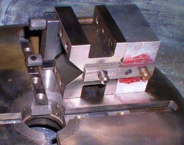

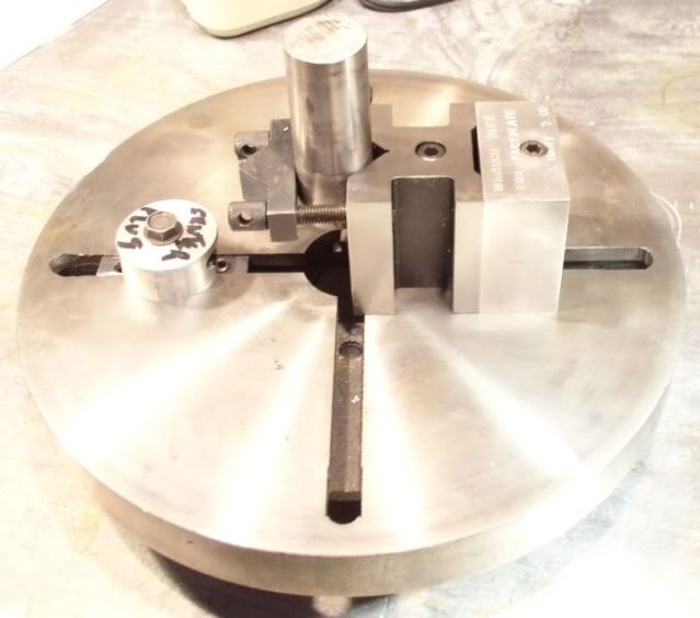

                              • Faceplate with adjustable V-block. V-block has key on bottom that slides in Tee slot groove of faceplate. Work is held to V-block and off sets can be made to work without unclamping the work.
                                Made from plans in Marlyn Hadley’s book “Model Machines, Replica Steam Models”
