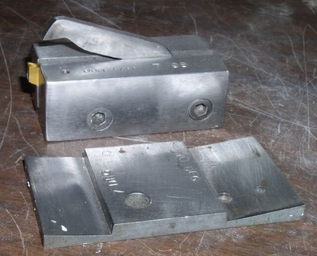

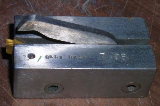

                    Made a home made carbide grinder and decided rather then have a table that adjusts for angle would make holders to set the angle.
                    Carbide parting inserts should be touched up at first sign of getting dull because not much can be ground off them. Touching up can double the life of these spendy buggers.
                    Putting finger on swing arm holds insert in place for grinding.
