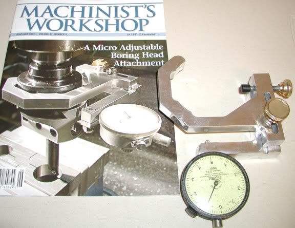

    Plans from June/July 2004 of Machinist's Workshop by Peter Stenabaugh

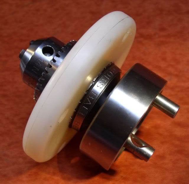

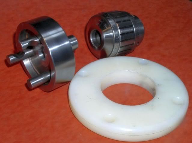

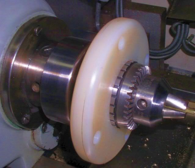

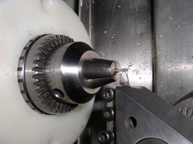

              • Took a half inch Jacobs ball bearing Super Chuck and drilled a clearance hole straight thru the back. Made an adapter to go from my lathe D1-2 spindle nose to the Jacobs taper.
                Bored out a nylon type plastic disk for snug fill on drill chucks collar. Also drilled and tapped for set screw for a little extra holding.
                Works slick. Do have to stop lathe to loosen chuck, but loosens easily with out much effort. No chuck key needed

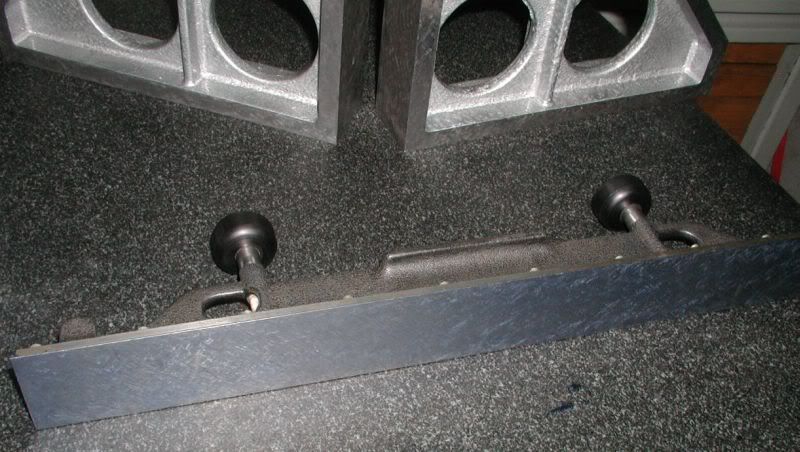

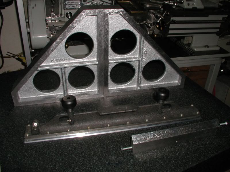

                  Couple of machined and scraped squares. Greg Dermer made the patterns and Gary Martin of Martin Model and Patterns used to sell these castings. Not sure if they are still available, there not listed on web page.

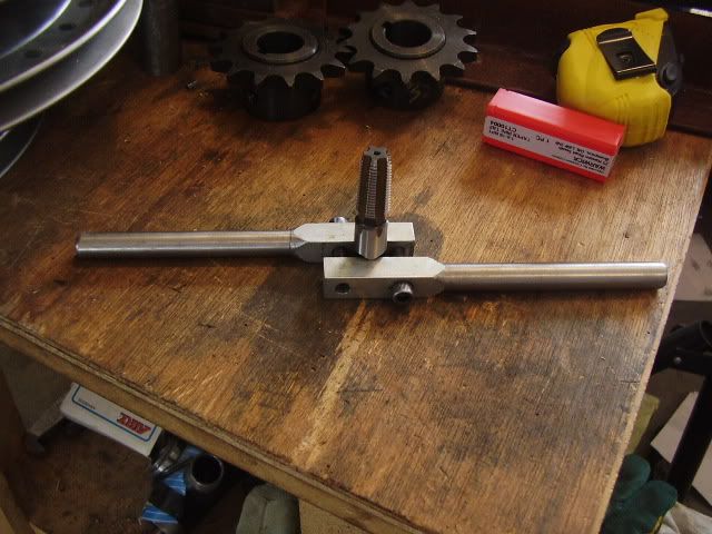

                          • Pretty basic, but may help someone out of a jam... Shop made tap wrench. This one is turned out of 1/2" keystock, but can be scaled up or down as required. I've been putting off making one to fit my 1" hand reamer....
                            Note that it leaves clear access to the center on the end of the tap...

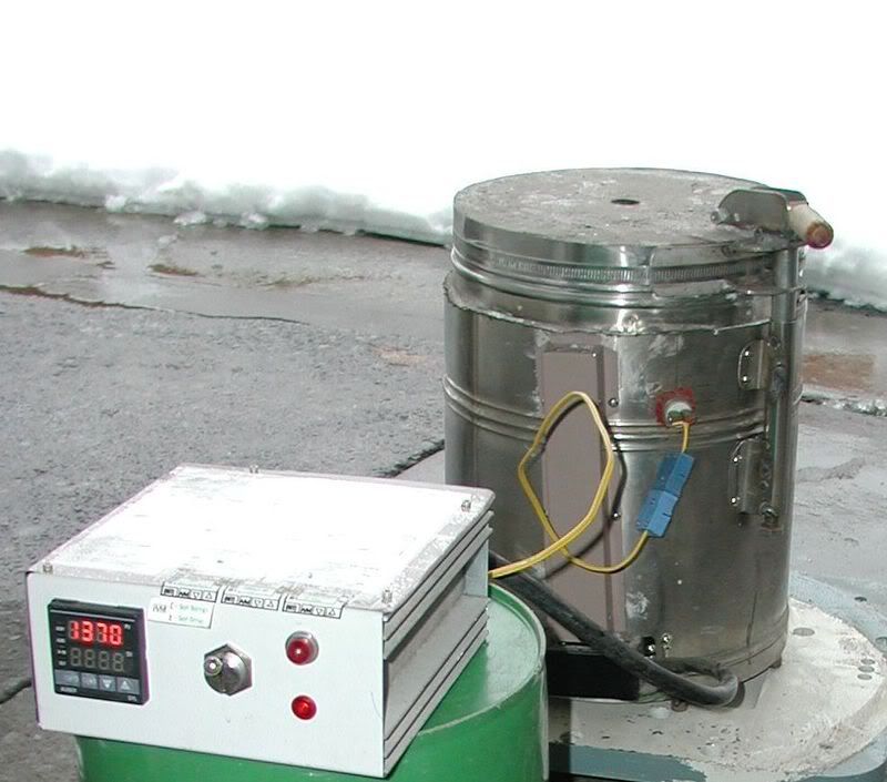

                            • Propane melting furnace made from 5 gallon propane tank. Intake air to burner passes thru exhaust port to prehead the air to the burner.
                              There is a ratchet lift up device that pushes the crucible up from the bottom. High enough to grab the crucible but not too hign so it can tip.
                              Pouring tongs slips over top of crucible latches in closed postion for lifting and pouring.
                              • Gary,
                                How long does it take to heat up the crucible will a full load of aluminum?
