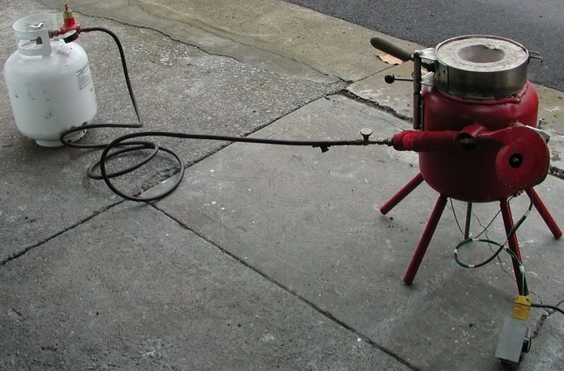

          Propane melting furnace made from 5 gallon propane tank. Intake air to burner passes thru exhaust port to prehead the air to the burner.

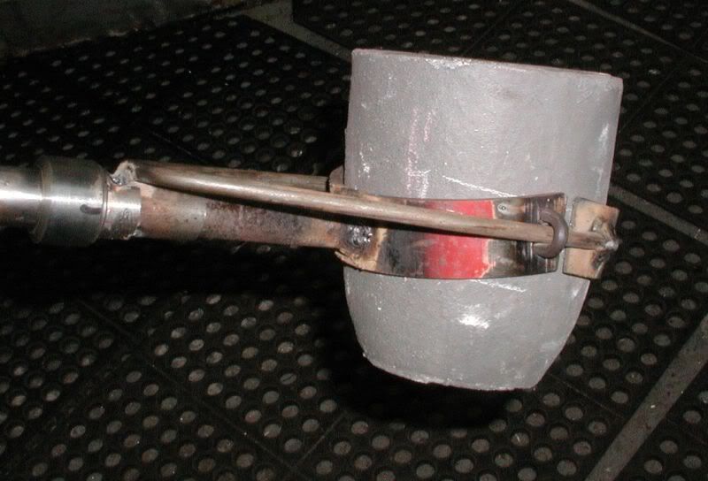

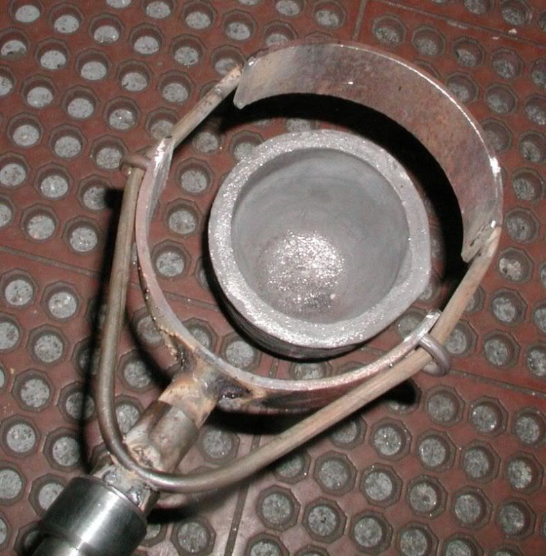

          There is a ratchet lift up device that pushes the crucible up from the bottom. High enough to grab the crucible but not too hign so it can tip.
          Pouring tongs slips over top of crucible latches in closed postion for lifting and pouring.
          do you have design and build instructions for these???
