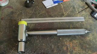

        Here's a mill hammer I made this weekend. It takes 1-1/2" replaceable tips on one end and has a 1/2" sockets on the other as well as the end of the handle (to use as a T-handle). It's loaded with shot. I didn't want to limit myself to just a draw bar hammer so I went with sockets.

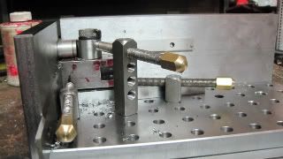

        Here's my version of Lautard's Po'Boy's Jig Borer from the 2nd Bedside Reader. The work is pushed into the corner fence and by spacing the drill bushing holder out from the fence you can get accurate locations with just a drill press.

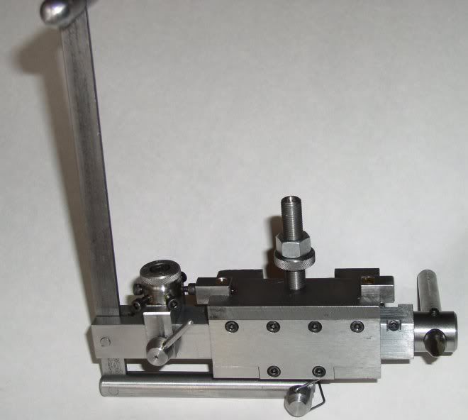

                        • An external hone, blatant ripoff of Sunnen hone. V-block is Turcite lined and stone is a replacement brake hone stone from the car store. It doesn't say by I think it's silicon carbide by the cutting action. I'll experiment with aluminum oxide, alternate shoes etc.
                          This was built initially to scribe graduation marks on dials. It's sturdy enough it also serves as a hand shaper for internal keyways. Again Turcite lining on square ways - clamp up with shims while the epoxy dries and it's automatically fitted to the slide.

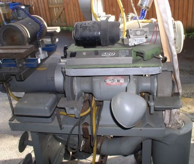

                            Backside has a SRD drill sharpener atop a Baldor grinder

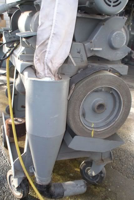

                            Left side shows the cyclone. Scaled down version of wood dust collector, had found plans someplace on the net, but don't recall where.
                            To the right is the BIG Wheel. It is one of those woven nylon wheels with abrasive in it.

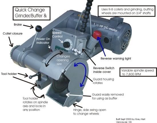

                            More on The Quick Change Grinder. Started grinder after reading something by John Dean in a early issue of HSM. It is a quick change grinder where wheels are mounted on 3/4 arbors and the arbors are held by a 3/4" R-8 collet. Years later did a redo and changed motor to DC for speed control and reverse. That is when this picture was taken.
