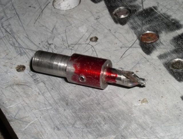

          Mostly have 3/8 collet in mill and like to use smaller center drill. So, made adapter. Lots of time center drill in mill and then take part to drill press to drill.

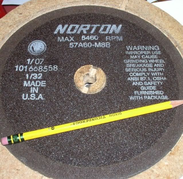

                • Grinder attachment. Abrasive cutting with swing table and non-reinforced cut off wheel.
                  This abrasive blade is only 1/32" thick and has no reinforcement. Very easy to break and work can not be cut free hand because of this. Also needs to be kept in a dry place when not in use or they get real weak and will break just handling them. Think they are ment for use in a surface grinder. They have a inch and quarter center hole. Being very light if they do brake, they don't have much energy. But as makes sense protect your eyes and lungs.
                  Attachment for grinder clamps below grinder and has a pivot point for the swing arm. The swing arm lets the table swing into the cut off blade and back out of the way. Pivot point is long so there is no or very little side to side movement.
                  The Vise Grips are welded on the bottom of the table and are part of the swing arm. There is a Vee groove in the table for holding round work. Hard steel cut be cut or notched with easy.
                  The long cut on this high speed steel blade took less then 10 seconds to cut. Picture didn't turn out but piece of steel fits between fingers of vice grip for clamping the lathe bit.
                  There is some resistance when cut is first started and then it changes to very little resistance. You can tell by looking at the color that not much heat goes into what your cutting.

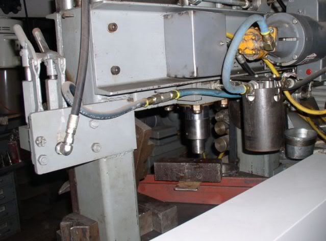

                          • Was using the hydraulic press today. Making some posts from some old inch and half pipe. Made 3 sided pocket atop the pipe for a 2x4 to fit in on edge. Made 2 cuts in pipe. Bent two sides out and then over to the press to make square corners by pressing in a hunk of key stock. With press as a vise holding the keystock down the sides were hammered against the keystock first and then a quarter turn of pipe with keystock still in place. Squished the sides flat. Worked good.

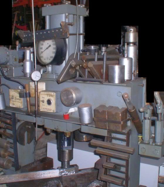

                            Being had the press out, took some pictures of the press and some accessories.
                            Hydraulic press. 25” inside width.
                            Electric table lift by cable from one side only. Bearings, mounted to table, ride on top outside and bottom inside of left upright. This works much better then having cables going to both sides.
                            There is an adjustable rod that can connect to a dial indicator for repeat bends to a certain depth.
                            . Backside shows the 5 hp electric motor and a low and high pressue hand pumps for a “little” feel when needed. Originally only put hand pumps on when first built.

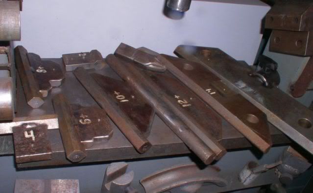

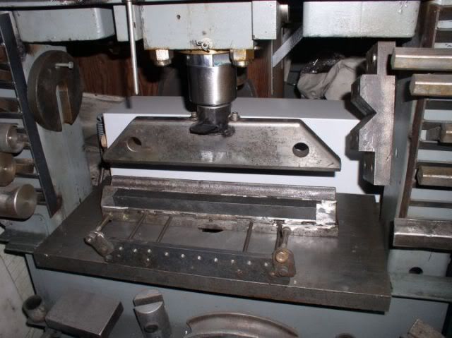

                            Press brake. Bottom die has back gauge.
                            More dies for bending of different lengths.

                              • Nice rig Gary, what is it's capacity, 30tons?
