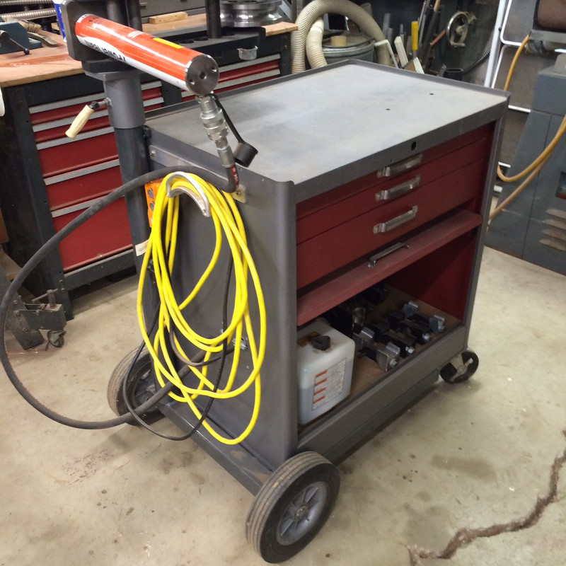

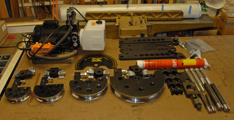

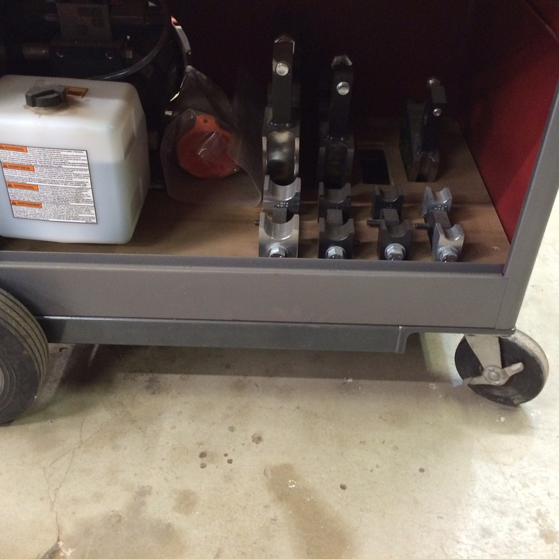

  • I don't think I've posted this here. Modified an ancient Kennedy rollaway cabinet to make a cart for my JDSquare Model 32 bender, which rotates on the vertical column, which mounts to a heavy duty welded base on wheels and casters. The electro/hydraulic power pack mounts in the bottom of the cabinet, which has a cutout for motor cooling. A power cord is mounted with a power on/off switch. Also the pushbutton switch for controlling the hydraulic cylinder in/out. Dies are stored in a built-in rack in the bottom of the cabinet, to keep the CG low. Smaller accessories and related tools are stored in drawers. Hydraulic reservoir is easily accessible for service.
    I have bent up to 1.5" (1.9" OD) 316 stainless schedule 40 pipe with it. Great machine.

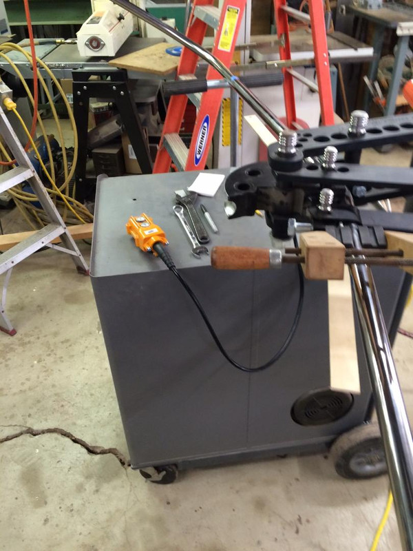

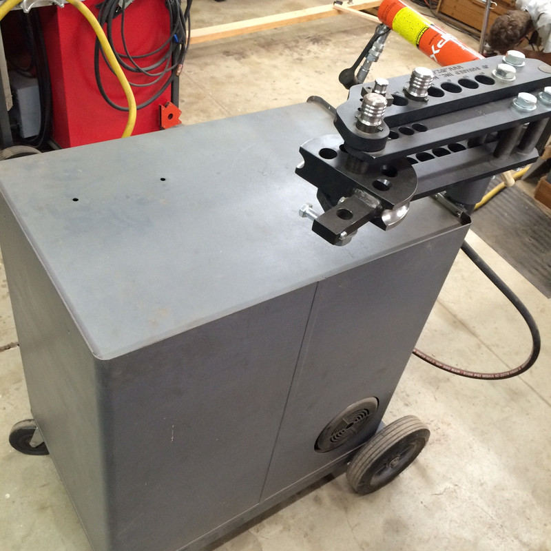

        • Thanks fellas. The top will be covered with a fitted rubber pad. Here are a couple projects I built on it that have proven its design approach. Have to say I really wouldn't change anything, though I will be adding more dies as I go. Because of the rotating feature, it stores in a very small footprint.
