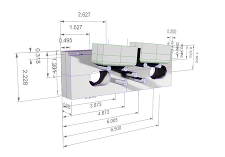

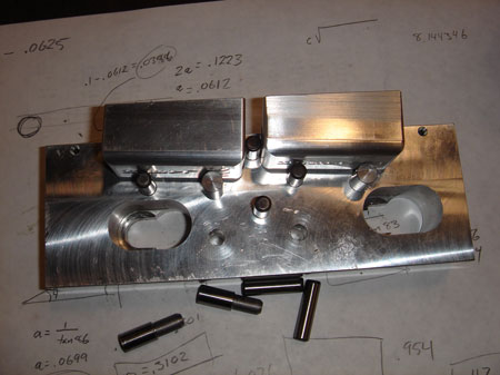

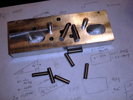

        I made this set of soft jaws with a bunch of dowel pin holes and set it up so I could use the same set of jaws to hold two parts in tandem and machine all six faces. Took some head scratching but worked out great.

          DaHui, ditto on the cool vise jaws. I've been thinking about a slide out jaw setup myself. I saw one somewhere that uses slightly modified bolts to make it work better, so I'm wondering if you're just using ordinary socket head cap screws? Seemed like they had turned the bolts and also shortened the head. Can't remember now where I saw it and I didn't save the link (DOH!).
          Endless magic is possible with special vise jaws. This is particularly common for CNC'ers. I visited a shop one time that had two big cabinets full of nothing but custom made softjaws for Kurt vises. Have seen others that keep bins for repeat jobs and they put the jaws in there.
          For CNC, repeatability of the jaws is important. I've seen a lot of jaws with a bore on top you dial in for repeatability. But, I've wondered why they don't modify their jaws to use dowel pins to locate the jaws. I did see in Lipton's book he puts a shoulder to locate the jaw, which also seems a good feature.
          Anyway, I digress. Great additional posts, guys!
          BW
          • A lot of vise jaws are held on by low head socket cap screws. They are a standard catalog item. I use them all the time. A box of 25 will last a lifetime.
            For a 6" Kurt vise I use the 1/2-13 x 3/4 size. They take a 1/4" Allen wrench.
            • These jaws use the standard SHCS. It's a lot easier to just crack the screws loose and slide the jaws off if you change jaws very often. It also means you don't have to crank the jaws wide open to get at the heads, you can just use the short shank on a regular allen wrench.
              I should also note, only the fixed jaw has pins in it. The stock is 1" wide and I think the pins protrude about 3/4" if I remember correctly.

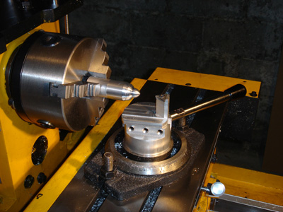

                  I am about half way done with a taper setup for my sb9

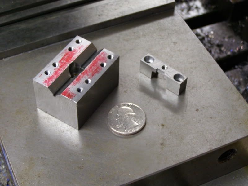

                        • Just finished a little V-Block and Clamp from A2 tool steel.
                          A little machining...
                          A little grinding...
                          • Glen
                            Very nice job on the V block.
                            And a nice way to mark your tools.
                            Do you just mill a slot,stamp your initials and bead blast the bottom of the slot?
                            And another question if you don't mind. Is the high polish the way it came off the grinder?
                            Thanks
                            Hal
                            • Hal,
                              Yes, it was milled and then stamped. I did bead blast it prior to grinding.
                              Yes, that is right off of the grinder. I'm one of those crazies that believes in balancing wheels
