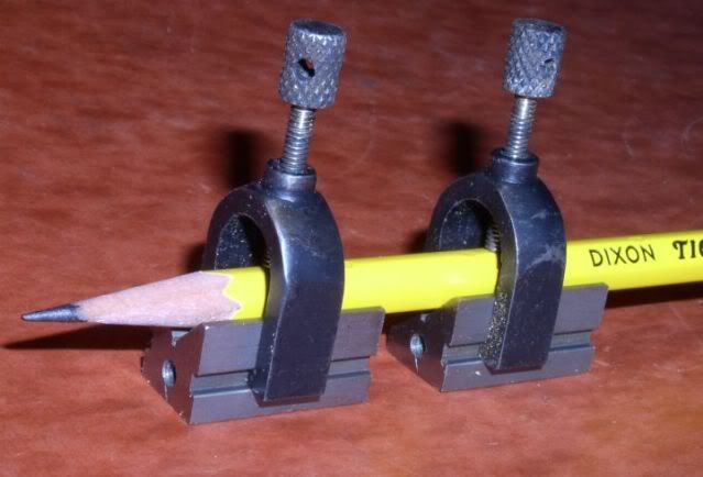

        • A friend cut these V blocks out using wire EDM and gave them to me.
          I made the clamps, a little big and clumsy looking, me thinks.

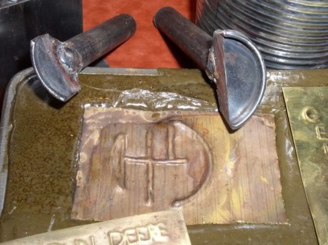

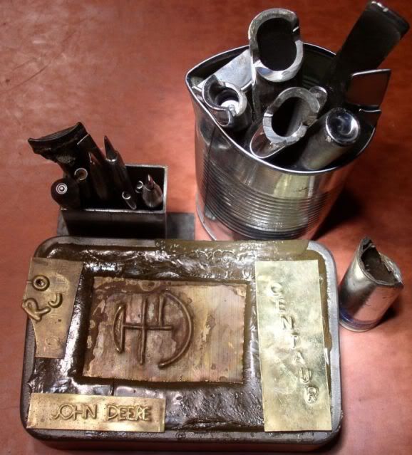

          Repousse is the shaping of metal by hammering on the backside. It can be done on a lead block or end grain of a wood block. A pitch bowl works better. Easy to make tools, a welded up pan and some pitch from
          http://www.northwestpitchworks.com/
          The brass examples below are showing the work from the front side not the hammered side.
          Rounded edge chisels for straight lines are easy to make free hand.
          Radius tools are easy to make on lathe and just cut the part of circle wanted and attach a handle

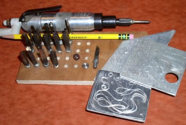

          Keller Pin Riveter converted to power engraver. The pin riveter has a female 10-32 thread so making tools by silver brazing a 10-32 thread to 1/8" lathe bits.
          • Gary, your scroll looks darn good considering what you're using. You could easily pick up the hammer and chisel very easily if you wanted to.
            I used S5 shock resisting tool steel purchased in .250 round stock to make my chisels. It heat treats easily with propane torch and 10wt oil. You only need to harden the tip or business end. Made them about 7-8" long. If you haven't been trying a chasing hammer you should. Just hold the chisel so your thumb is near the hammer end and you can rotate/steer the chisel. You look like a natural to me.
            Have you figured out yet that the length of the chisels heal is about the same as the depth of cut?

              Thanks for advice on using the shock resistant steel. Will get some S5 next time I'm over where they sell it. And the advice on the heel length, digging in is a big problem for me. Thanks
              Don't know why but haven't used chasing hammer, mostly just push by hand. Guess will have it get back into trying, its been over a year or more.
