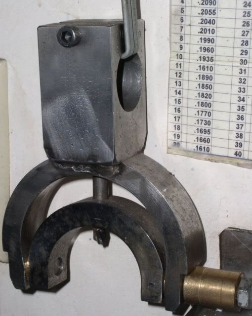

  • A double barreled boring bar holder LOL
    For 1/2 and 3/8 bars
    And before someone asks, no, I dont use em both at the same time

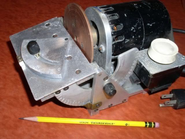

        Forest Addy design for sharpening carbide scrapers.
        DC motor with cast iron "faceplate" Table is set at 3 degree negative angle.
        Diamond lapping paste is imbedded in cast iron using ball bearing on end of rod.
        Small container of kerosene in old 35mm plastic film container.
        Kersosene applied to lap with acid brush. 2 passes then touch of kerosene.
        Small copper lap is charged with diamond paste just like the cast iron scraper lap. Small motor and light dimmer switch for speed control.

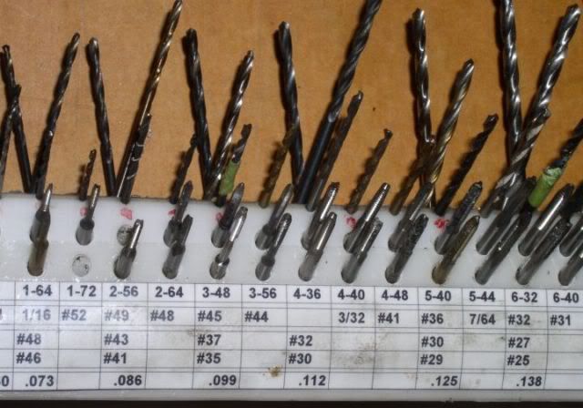

          • Holder and organizer for small taps, tap drills and clearance drills.
            Taps are in bottom two holes and just above that is the tap drill.
            Drills above that with the tip angled to the right is clearance plus drills.
            Drills above that the tip angled to the left is close clearance drills.
            Hex socket wrenches made from socket head cap screws.
            Handles are ¼ hex stock, which works good. Don’t roll on table easily and a ¼ inch nut driver can be used for wrench extension.
            Number system for the wrench sizes is:
            One row of dots = 1/64th of an inch.
            One narrow groove = 1/32nd of a inch
            Two narrow grooves together = 1/16th of an inch.
            Two pairs of narrow grooves together = 1/8th of an inch.

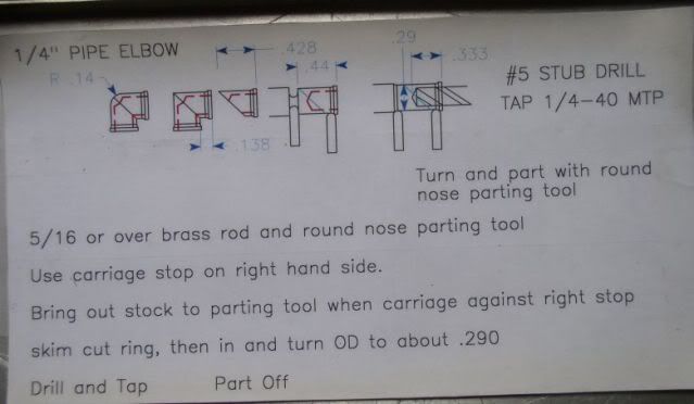

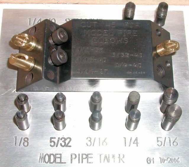

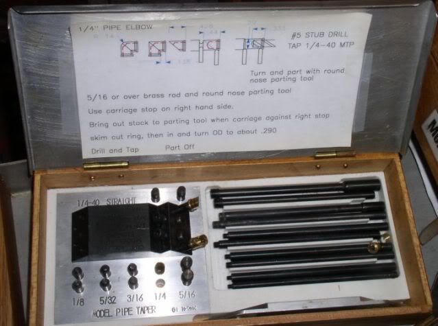

            Kit in a box. For making quarter inch model pipe elbows.

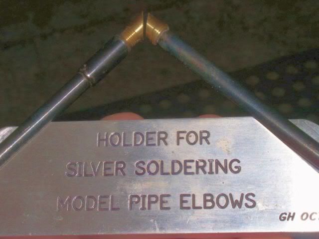

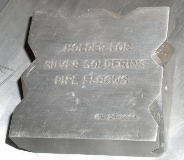

            Holding fixture for positioning the two halves of elbow that are screwed on rods for silver brazing the halves together.
            • Gary: I sat straight up in chair when I saw your latest: model pipe 90's. I bought Superscale 5/16" elbows for the cooling system of my Mery engine, but they do not stock them in 1/8". I've been dithering on this for several months and I'd sure like to get on with it. Any chance I can talk you into more info and a picture or two??
              TIA
              Carl
              • Carl, the Mery was one of the first IC engines that I made, nice engine. Haven't made 1/8 elbows since making this kit, so don't have measurements. Maybe the ones for 1/4" elbows will give you an idea.
                At bottom of picture shows threaded on one end short rods that the halves of elbows are screwed onto.
                They then are slipped into the holes at 45 degrees and pushed down until elbow contacts milling block. Tighten the screws to hold rods in place.
                Put block in milling vise. Before milling do a little thinking about how the rotation of the mill cutter has a tightening action rather then a unscrewing action as it starts milling.
                On the right hand of the block is tapped and a male thread that can be milled 45 degree for making a 90 degree street elbow.

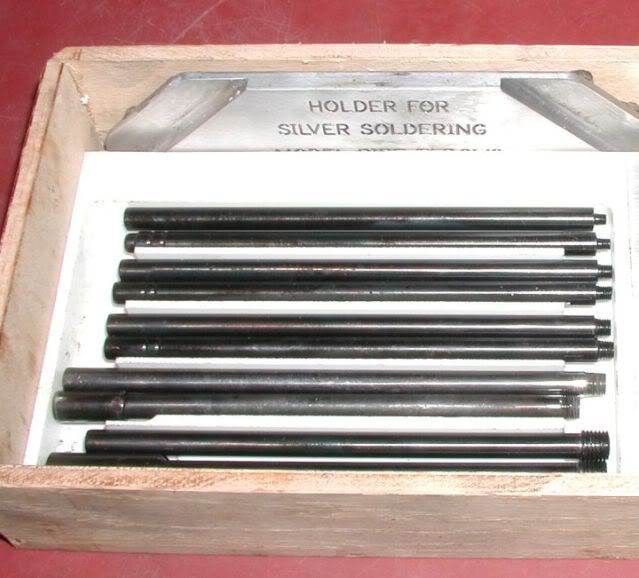

                The long rods are threaded to put the elbow halves on. One of the rod pairs has a female thread for making a street elbow.
                On the back side of aluminum holder for soldering is some strong computer magnets epoxied on that hold the rods in place and make it easy to get the joint aligned.
                Silver brazing (silver soldering, hard soldering) requires the right torch for this job. The brass wants to heated fast so not much heat goes into the steel rods. The steel rods should be oxidized so solder don't stick and not too much flux on solder joint. Hope this makes sense and not confuse.

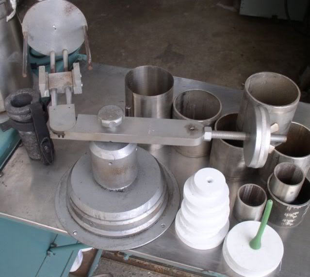

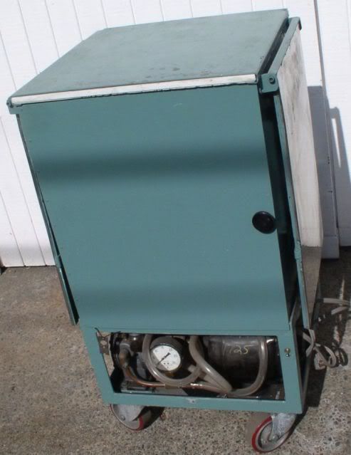

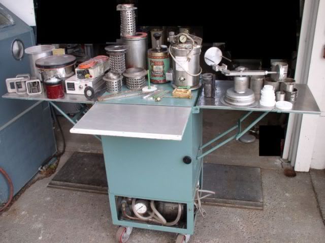

                          • Making horizontal space for another hobby, lost wax casting. Built cart that takes up about 3-1/2 sq. ft. Has couple shelves for storage inside and underneath is vacuum pump.
                            Has 2 flip out tables and table that pulls out to front. Now have over 8 sq. ft. of table surface.

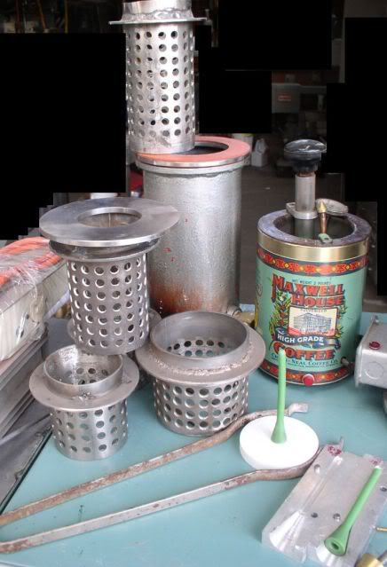

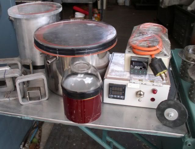

                            Metal rectangles on left are flasks for vulcanizing a pattern in rubber, using a heated press. 3 vacuum chambers for debubbling the mixed investment. Two temperature controllers. One is 120 volt and can be used on wax put and the other is 230 volt which can be programed for upto 30 different heat steps or ramps. Used for the wax burn out or can be used for heat treating. The rubber disk on a rod (lower right corner) is for mixing investment. Works exceptionally good for mixing and not intrappng air bubbles.
                            The stainless steel flasks with the holes are for vacuum casting and the vacuum chamber that they go in. The vacuum chamber has the red silicone gasket on it and adapter plate so two different diameter flasks can be used. Will do another post to explain rest of stuff.

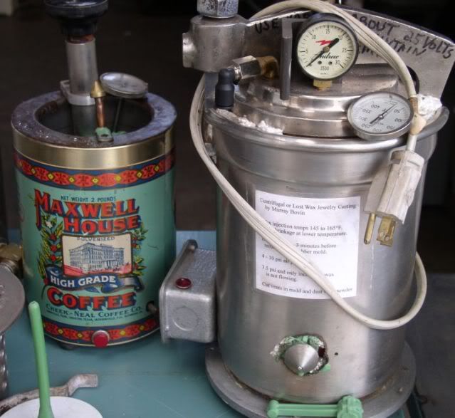

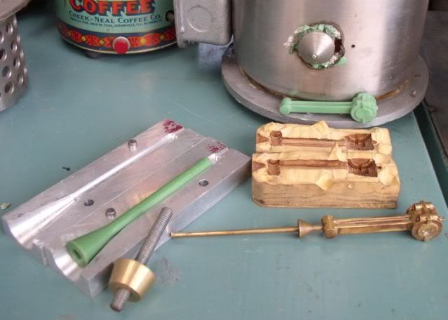

                            • Two wax pots. The one on the left has a 110 volt burner hot plate and built a pot with a top hat washer on top. A little insulation and slipped into an old coffee. Had pump with coned nozzle on discharge.
                              Second wax pot is pressurized by air and has an electric heating elment around the inner tank. Temperature is controlled either with variac or the 110 volt PID controller shown in earlier post. Spring loaded discharge valve is inside the tank. Originally had valve on outside but had wax temp problem with that.
                              A model connecting rod pattern is shown with 1/8" rod sticking out to the left.
                              This pattern is made bigger then what wanted by a shrink factor for the wax shrinkage and for the metal shrinkage from the pout.

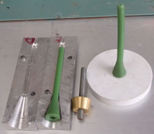

                              The pattern is put in a metal flask with rubber packed around it and then put in heated press and vulcanized. After this the rubber mold is cut open leaving jagged notches so the two haves will index to each other.
                              The rubber mold is held closed between two metal plates and pressed against discharge nozzle on the air pot to fill. Wax pattern shown which will be "invested". Investment is a high temperature slurry something like plaster of paris. This is vacuumed and put in burn out oven where the wax is burnt out.
                              Mold for making a wax tree which wax patterns are welded to with some wax using a hot wax pen. A female thread is cast into bottom of tree and the white plastic flask bases have the same thread. A short set screw holds the base and tree togather. Just use cheap black electrician tape to hold base to flask and wrap the flasks with holes and when investment is set up the base is removed.
                              Broken arm centrifugal caster. Made years ago but have yet to use it.
                              • Originally posted by gary hart
                                What about the angle table on this picture? Did you make it? Looks great.
