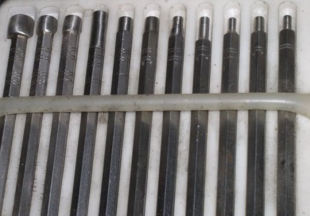

      Can you please take a picture of these wrenches so we can see the sockets? I am not sure I understand how you made smaller ones.
      Thanks,
      Alex

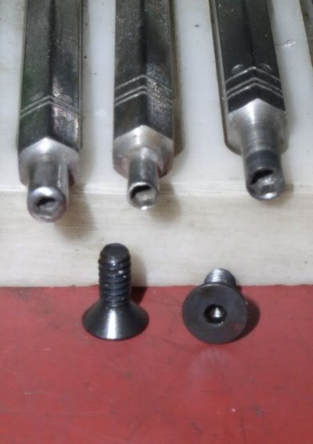

        • Originally posted by AlexK
          Gary,
          great idea.
          Thanks,
          Alex
          A socket head screw with small hex socket size compared to thread size works best. The flat head socket head screw in picture has a 5/64 hex and the thread is 6-32.
          This allows drilling a clearence hole in bottom of socket for the screw that has a nut on it. You really don't need a 5/64 size wrench but, what the heck if your making a set.
          Drill and tap your handle, I use 1/4" hex stock. Add some Loctite and tighten screw in handle.
          Now what might be the tricky part, in fact you might want to test this before Loctiting in. When you turn down the outside of the screw you want the hex socket close to being in the center. If not what can and will happen if it is off center, you will have a cam. The wrench will get jammed up on the side when in a tight spot. As with most my learning, learned this the hard way.
