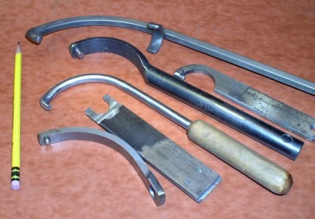

  • Originally posted by reggie_obe
    What kind of steel did you start with?
    For most spanners don't think it much matters what kind of steel you use. Would guess on all those shown is mystry metal made from scrap metal on hand. Extra strength could be had by heavier material or a gusset where curve changes to straight. Nice thing about making your own is that you can get a good fit.

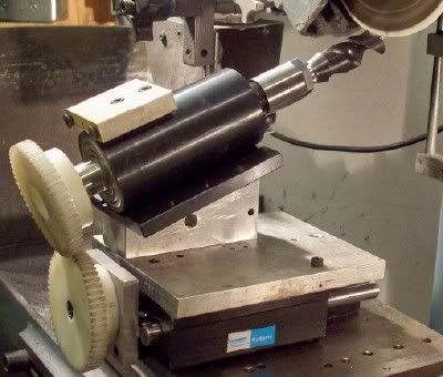

              • Two it one lathe tool.
                Harig knockoff, cylindrical grinding attachment:
                Mini Grinding attachment:
                Tapered thread grinding attachment:

                  • Originally posted by gary hart
                    Lots of ways to make spanner wrenches. The one like the best is to mill half the diameter of a rod that will be bent, bend and then add the pin. The one with the black oxide finish is done this way. Finish was by heating just below scaling started and then droping in bucket of oil.

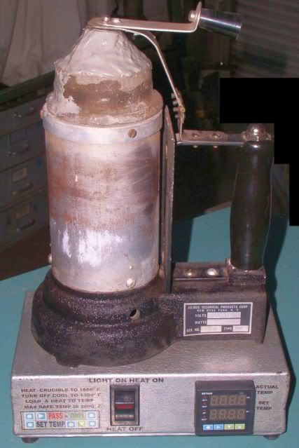

                    A new electric melting pot with manual controls costs about $900. They are kind of neat in that you pour right from the pot like you would a coffee pot. They use a graphite crucible and have a lid, so the atmosphere has no oxygen for oxidizing the melt.
                    Bought a old Jelrus electric melting pot off of Craigslist with a bad control. Made new base and installed a digital control and made decal with some instructions. Put a hinge on the lid. Ended up costing about $100 which fit my budget.
                    Hi Gary,
                    The part about "made decal with some instructions" caught my eye.
                    I have had a few uses for making decals such as replacing the beat up threading chart on a south bend lathe.
                    Care to share some tips on making decals?

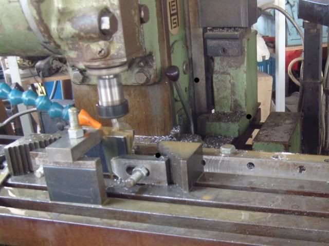

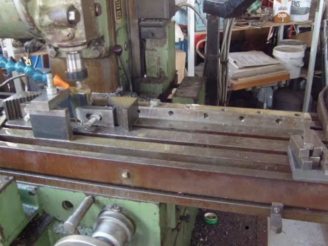

                    • My hold down
                      I've just read this thread, quit a feat, well I didn't read it all, but I looked at all the pictures!
                      Here is my "back bar" an early piece of work on my H. Ernault Somua ZHV1 Universal milling machine. It's a hold down, "T" in section that bolts into a "T" slot. There are 14mm horisontal threaded holes that allow clamping as though it were a vice. I find in some ways it's easier to set up than a vice.
                      I hope this is understandable!
                      Fired with enthusiasme, I wanted to post, I will post the bit sharpening tool that I'm building when it's a little more advanced.
                      Regards, Matthew
                      • Making water slide decals is one of those side trips that takes more time and stuff then a person would think. Maybe not too bad for someone that grew up with computers, Maybe.
                        To make good decals a printer that prints white such as Alps printer which uses a resin or something like that instead of an ink is nice, maybe a must. Alp printers might not be supported anymore in the states. Then you need a program something like Corel Draw to do the graphics. Then learn the quirks of an Alps printer program.
                        If you want more info there is a Yahoo group - Alps Decals. Also some Utubes videos on Alps decals. Sorry, not very encouraging

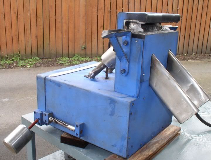

                        Some hammered in lettering. When I retired from the fire dept, found another firehouse. Recuperative Gas Fired Forge Furnace. Made from ABANA plans that were developed at the Sandia National Laboratories. Haven’t finished this one yet as like the first one had built

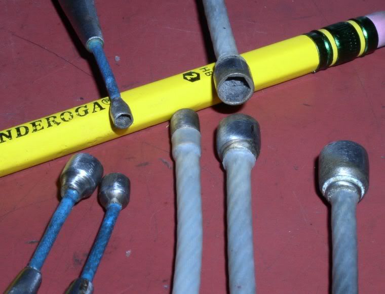

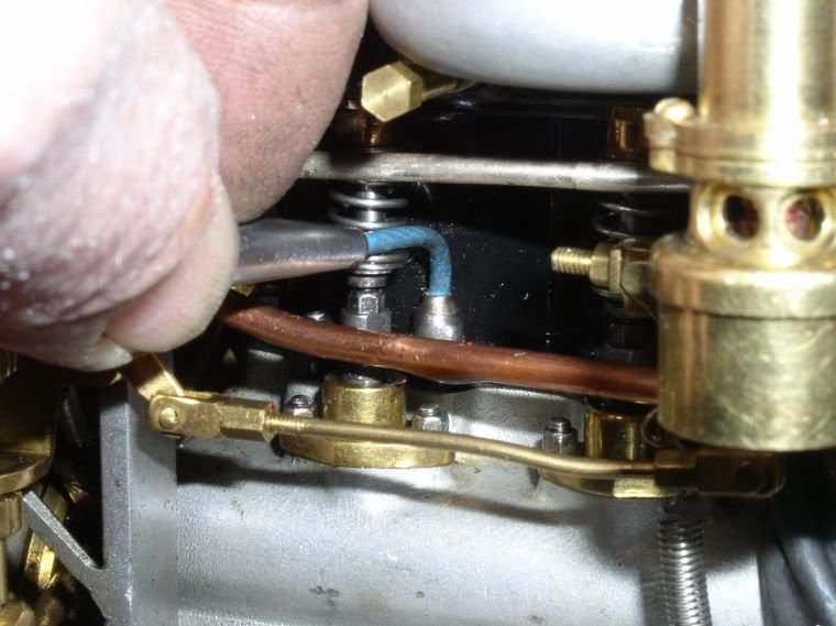

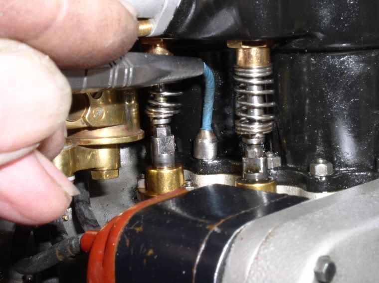

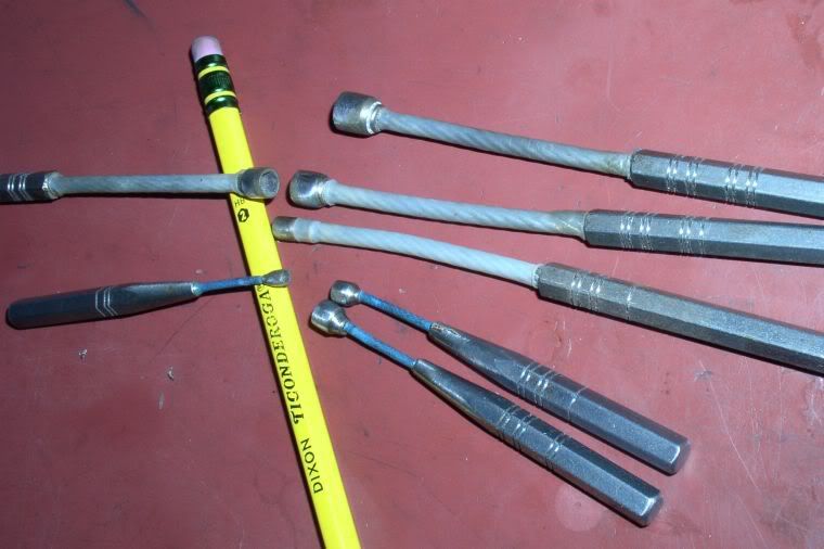

                        • Flexible shaft wrenches for those hard to get at places. Not strong enough for final tightening or breaking loose. Has saved me much frustration and time when working on little nuts or bolts in those hard to get at places.
                          Flexible steel cable like used in steel fishing line leaders works good. They do need shrink tubing put over them to keep from unwinding the lay when going the wrong direction.
                          • Hi Matthew,
                            Pretty ingenious vise setup you got there.
                            Looking forward to more neat ideas like that from you.
                            Member since 2005 and this is your first post?
                            CONGRATULATIONS......and bring it on.
                            That is what this thread is all about.
                            • Gary, Very ingenious! I'll need to keep this idea in my back pocket for future use.

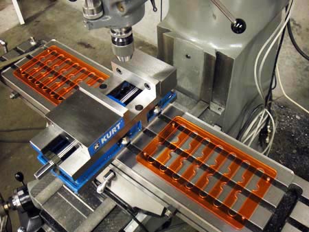

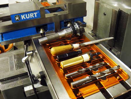

                              • This isn't "a tool" but it's "for a tool." Does that count? Laser cut acrylic table covers!
