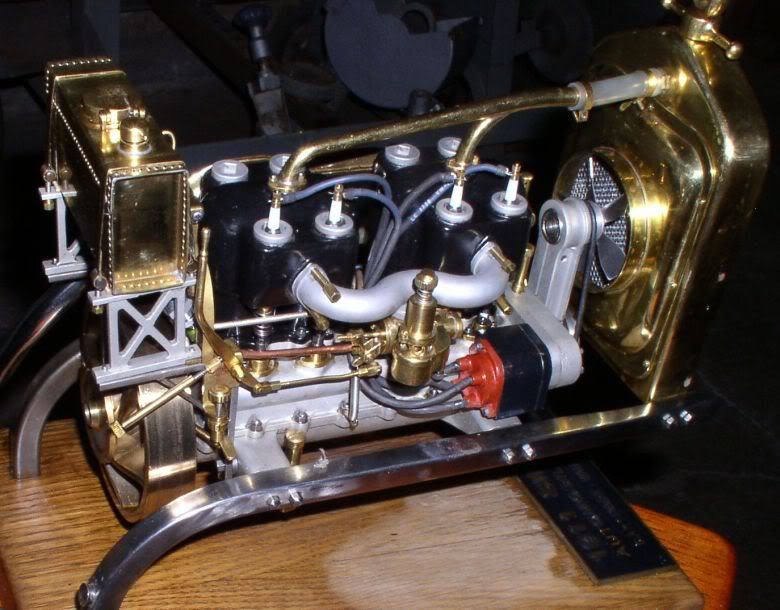

        • Gary- Motor?
          what is the motor you are tweeking with the flex tools. I see a mag and external valve tappets?
          • 1/6th scale 1911 Simplex T-head engine
            • Looked and didn't have a pictures of this engine except bunch of parts had worked on. The engine is not quite done, having much problems with float in the carb. Fuel leakage has leached the oil out of the wood base. Went out took a picture tonight.

              • Thanks for the photo Gary. Very very nice job.
                The fuel leakage might be prototypically correct. I recall part of the instructions for starting an airplane engine of the times included pushing the aircraft out of the resulting fire.
                Jim H.
                • Jim, thanks for the kind words. Will remember that gas leakage spot is authentic.

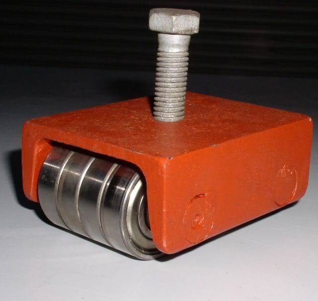

                  Some cheap machinery skates made from junk 203 bearings from electric motor rebuild shop. A short hunk of 3” channel iron. Couple of axles to fit bearings. Notch and fill notch with tack weld to hold axles in. Height is 1-7/8”
                  Has tapped hole in middle. If lathe headstock end has bolt down holes this can be used for bolting to lathe in the two corners.

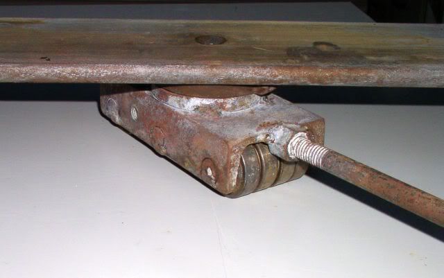

                  This one has 3 rows of bearings and a scrap throw out bearing from a car clutch between skate and flat bar. Has a steering arm for pointing in direction you want to go. This one can go at the tailstock end of a lathe. Three skates work better then 4 as they are always in contact with the cement. Total height is 3-1/4"

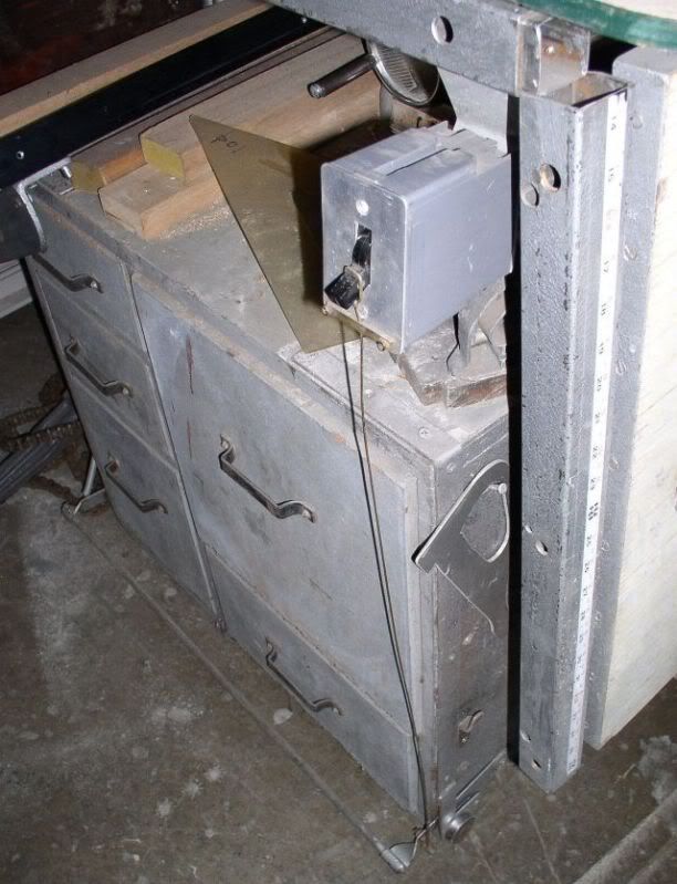

                  Mickey Mouse foot shut off switch for table saw.
