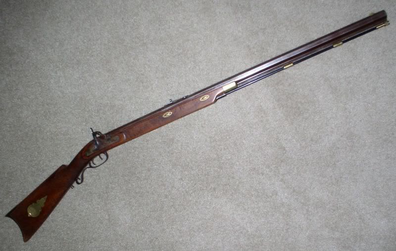

          • Here's a Hawken style half stock planes rifle I completed a few years ago. Kinda hard to see any details but it shoots really well - 54 caliber. This was made from a bunch of parts I bought at Friendship Indiana one year. The walnut stock was a blank and all the parts were cast steel. Lot of hand work. Took me months to get it finished.

            • Mark - is your's an original? would live to see it if it is.

              • Yup, Jerry, it's an original in 54. The wood grain was sort of bland until I rubbed a lot of neat Ballistol into it.
