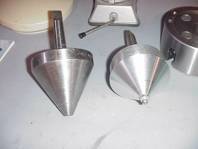

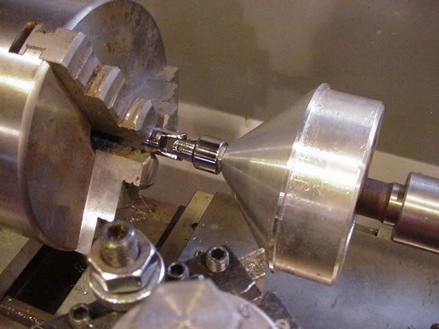

              • This is related to the Bull Nose thread.
                In years past I made a 60 and 90D bullnose center by modifying a piece of #2 Morse taper tooling and mounting a chunck of stock on a double row sealed bearing with one seal removed. The bullnoses are driven off of the headstock with a universal socket in order to keep run-out to a minimum

                  • Spindoctor and Kidd,
                    Thanks for adding the bull nose centers to the thread.
                    I am adding that to my to do list.

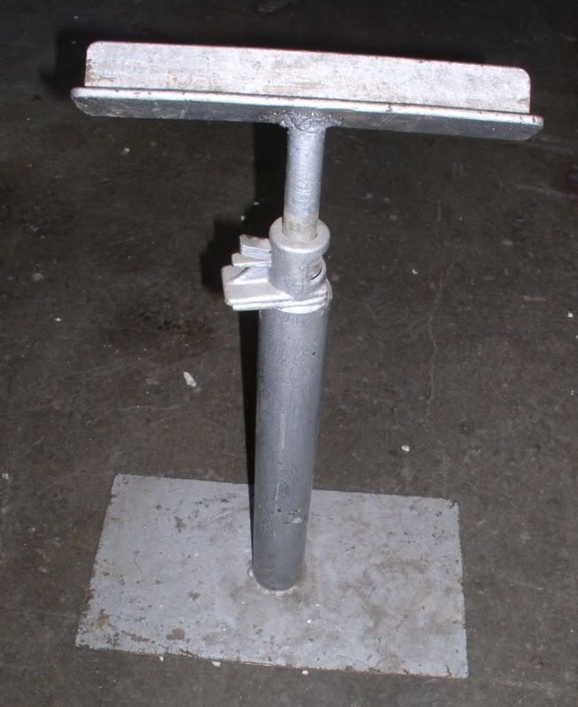

                    • Simple adjustable stand for horizontal band saw or what ever.
                      Half of a 3/4" pipe clamp like the woodworkers use. Fasten clamp to tube and welded other end to base plate. Weld piece of 3/4" water pipe to hunk of angle iron.
                      Lift to adjust with one hand it stays where you let go of it.
                      • Spin Doc, I was thinking rather than making a hex, you could simply slot the end and make a driver similar to a standard screwdriver to transmit power.
                        • Originally posted by Jim Shaper
                          I noticed he was using a universal socket adapter to drive the center. My guess he did so to compensate for any run out of the hex.
                          • Plus that way I can lube the bearing Its not like I need to use the center for small stuff. I've got a couple of nice once for that

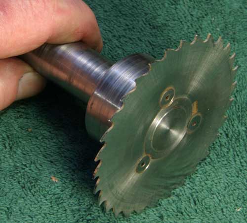

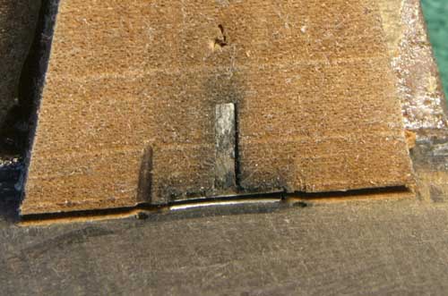

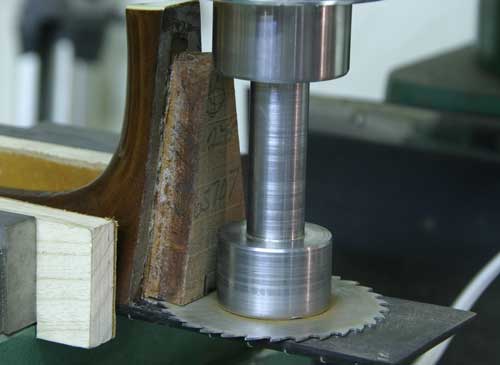

                            • Here's one I used today - a flush cutting saw:
                              I use it to cut the steel truss rod and mahogany dovetail when resetting older Martin guitar necks:
                              It cuts neatly through everything without scratching the bottom of the fingerboard:
                              If you'd like to see more about this stuff, it's on Day 17 of my current repair blog:
                              http://www.frets.com/FRETSPages/Blog...8/37d28_1.html
