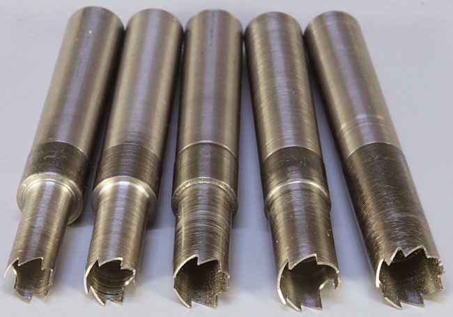

    • Here's yesterday's project - a set of "telescoping" plug cutters for veneer repair. The smallest cuts a plug for a standard drill size, and the one above it cuts the plug for its hole, and so on:
      Frank Ford
      HomeShopTech

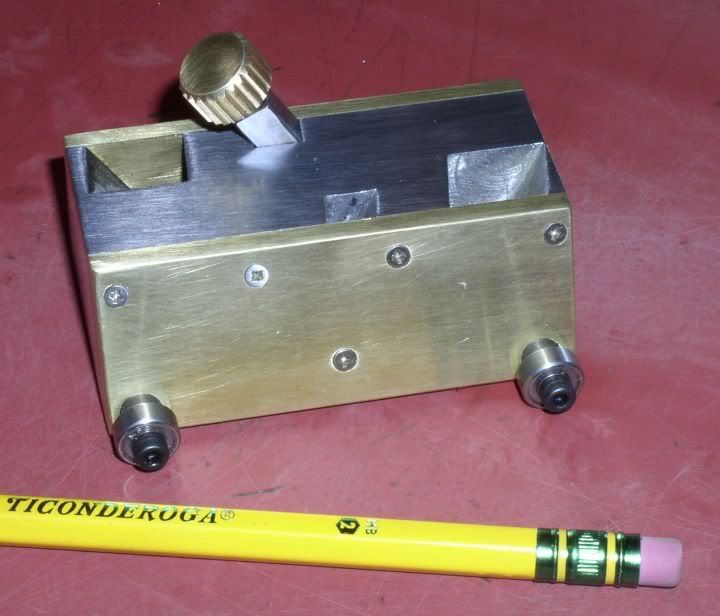

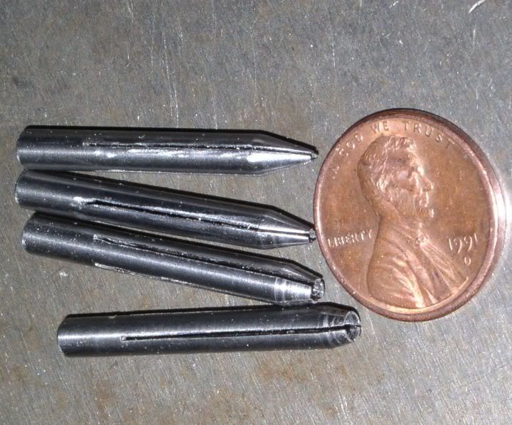

        Gadget Builder gives information from Derek Brown's article describing his Four Facet Sharpener for small drills (#42-#80)
        Sounds good, so built one. Need button head screws to replace the SHCS on the axles and a diamond pad. Also got to build the magnifier for aligning the drill bit in the collet.
        The four collets for holding drills from 3/32 down to #80

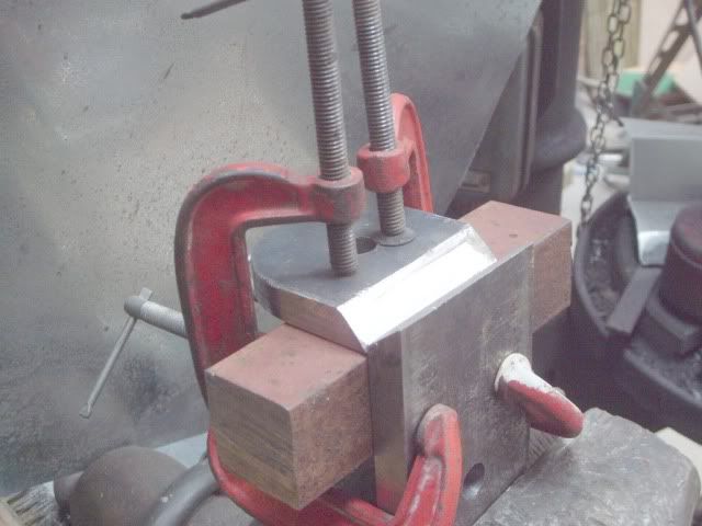

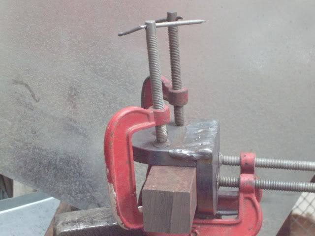

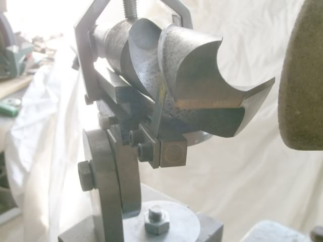

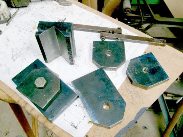

                        • Cool & Tutter Grinder tooling
                          Hi,
                          some time ago, Ibought through ebay a Clarkson Mk I tool and cutter Grinder. Advertised as having "some tooling", which turned out to be a pair of centres and a couple of worn grind wheels, all I had to do was make some tooling!
                          Armed with "Sir John's" Mrs's CD, the March Clarkson manual and a little inspiration from McGyver, I set to.
                          The "bits", made a "V" block from a chunk of found rusty mild steel. It figures in my previous post entitled "back bar". The other parts were cut out of 15 mm hot rolled with my band saw. I added a passing "shop made" tap wrench to the picture as it was there.

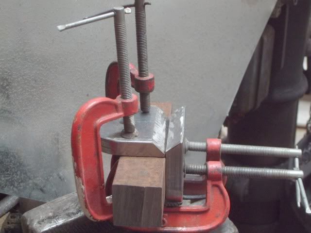

                          Clamped up before welding.
                          Mig welded together. Peened with a hammer whilst still hot lead to virtually no distortion.
                          Limited to 4 images per post, Continued!

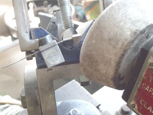

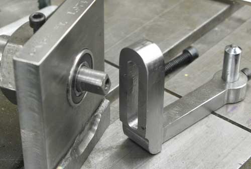

                            Part 2.
                            The clamp was assembled in the same way.
                            The first try with a 50mm bit! I was really pleased with how well it worked.
                            The rear stop mechanism. I kept it as simple as possible. The bit that I was sharpening is a 5/8" bit that has been in my possesion for the last thirty five years, it was new when I got it, I used to use it for mounting fifth wheels on tractor units. I don't use it much anymore, but after all those years of hand sharpening, it was an apropriate guinea pig.
                            Again the 5/8" bit, seen from the front, the finger holder that worked really well for the 50 mm bit was difficult to use on small bits.

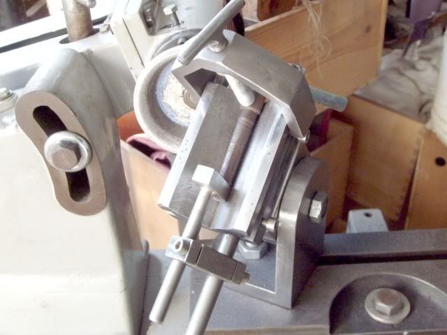

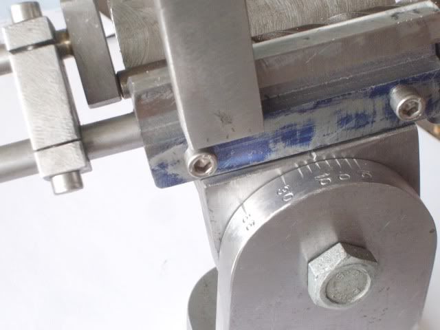

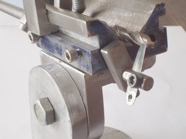

                              Part 3
                              The Mk 2 finger holder is cranked down so that the hacksaw blade finger is near perpendicular with the flute.
                              My not very pretty "hand" marked graduations and numbers. I have some very cheap hexagonal section stamps that I couldn't make a guide for as the faces don't line up with the sides the same way on each one! A bad buy.
                              General view.
                              Most of this was hand made, I'm a very in-experienced machinist, but I've done a lot of fabrication and welding. When training as a vehicle mechanic, I learn't to file the old way, a 4" of 3/4" round bar cut square with a chisel and filed square to 10 thou tollerances. I don't have any quarms about truing up things with a file, it's still quicker than setting up and milling most things! I used my slitting saw for the first time on this project!

                              • Milling Table clamp/vice
                                HI
                                Attached are pictures of a Mill table vice of clamp. Simple to make I trued up some angle iron and welded on 2 taped round stock with 3/8” fine threaded bungs. Mounting hole were aligned to the slots in the milling table. With the use of “V” blocks it will clamp round shapes too.
