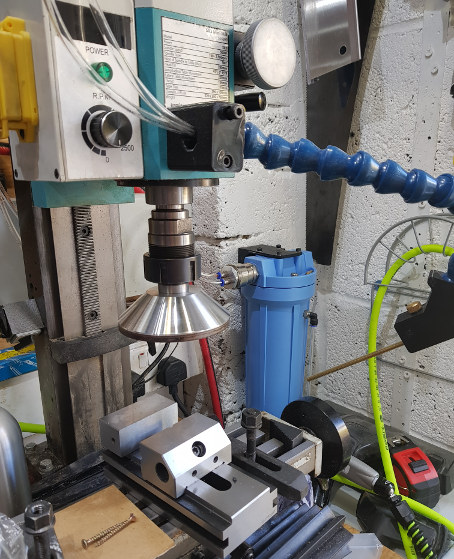

    Ok, results
    This was my setup. The angle between the 'top' face of the chisel and the back was a little more than 1.75° but not as much as 2°. So I went with slightly shy and jacked up the end to fine adjust. I worked out the sfm's of the Tormek diamond wheel and also Evan's wheel in the 2011 thread I linked to earlier. That gave me 260sfm and 630sfm so I had some guides to work within at least. That equates to 250rpm and 610rpm for my smaller wheel. I settled at 450rpm to start and got really good results with the 12mm wide Stanley. The metal and the wheel were still cold to the touch.
    Next up was the first victim. First thing I found was that unlike the Stanley, the sides weren't parallel enough to grip securely in the vise. I put the back of the chisel against the fixed jaw, one edge against the bottom of the vise and clamped the angled face with a dowel in the V of the moving jaw. I trued up each side so that I could grip the chisel and also so that the sides were square to the average of the face I was going to grind - otherwise it was going to tip front to back in that setup.
    I found that initially the wheel was probably only making contact at one point around the revolution until it wore true. To be honest, this was quite helpful as it reduced the contact and hence the heat. With a much wider chisel once it was making full contact there was noticeably a lot more drag. I was still doing fine for heat until I was far enough down the chisel that the opposite side of the wheel engaged with the blade too. There wasn't any coolant at that end and the extra contact really made the heat build quickly at that point. I did end up blueing just the tip of the chisel but it should come out when I (hand) grind the primary bevel. Why did I grind the entire back when just an inch or two would have done? Well, to be honest, it just looked really bad. What I did have to do is once I got the deep gouges (from the factory grind) out of the middle was then to grind just the end as far as not making contact with the opposite side of the wheel. You can see a slight difference in colour (about 2/3 along) on this pic where that happens but it's not noticeable by eye. I knew it was cupped but I had to take off 0.5mm before it cleaned up! I did this in 0.04mm DoC steps. Probably took me a couple of hours (I'd have been there weeks by hand!) but this is the result:

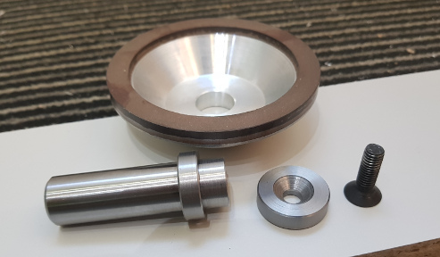

    Finally something that fits the category! I saw a Joe Pieczynski video a while back on diamond grinding HSS on a mill. Obviously that went in my shopping basket and obviously I've done nothing with it for the last 18 months. Now, I've bought myself a nice set of 8 chisels for a project and standards aren't what they were in the 70's (when the other two 'identical' chisels I've got were made) and the backs need a LOT of flattening. It's still taking too long even on a 120 micron diamond plate (that's approx 140 grit). I know there are shortcuts involving a tiny back bevel but partly I want these as perfect as I can get them - they have sort of inherited sentimental value as they replace the missing ones out of my dad's set - and partly the back is so bad that one entire corner is unusable as is. Clearly the overkill solution would be a surface grinder....and I did look! There was even one of the mythical bench size variety available...but collection only from three hours drive away....and it's been very difficult to get fuel here in the UK for the last week of so. It would have needed work anyway as it looked like it was someone's self-build project. So I suddenly remembered I had this resin-bonded diamond wheel that just needed an arbor. One chunk of EN8 (roughly 1040 equivalent) later and here we go. Turned the shank first and then held that in the 20mm collet that it'll be running in to do the other side.
    Runout was....far from what I'd hoped it'd be. I'm not sure how much was my failure and how much was in the wheel but it clocked in at 0.3mm on the outside of the cone and the edge of the flat at the bottom. So I just chucked the whole lot back up in the lathe and trued it inside and out - the arbor's dedicated to this tool anyway so it won't be coming back off.
    There shall be some unimportant test piece tried first, of course....and much covering of things shall be done first
    What grit is it? Well, I guess we're going to find out as it's unspecified. Could be about 200-ish as other "D12A2" wheels seem to be. Gotta give these things a try.....even if it's just to find out that they don't work!
