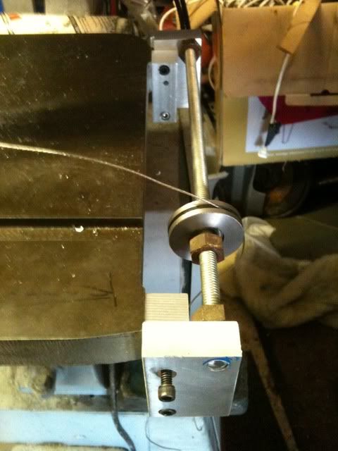

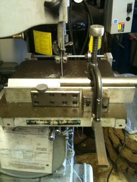

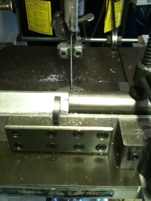

          • My thanks to Frank Ford
            I like his web site especially his Delta Band saw.
            I made his gravity pull and his metal feed projects.
            I put a 15lbs. brick of lead on the end of a wire rope, guided by a pulley.
            cuts nice and true and I don't have to sit around pushing the metal through the blade.
            Rob
            After the cut:
            Gravity Pull mechanism:
            Metal guide:
            Rob

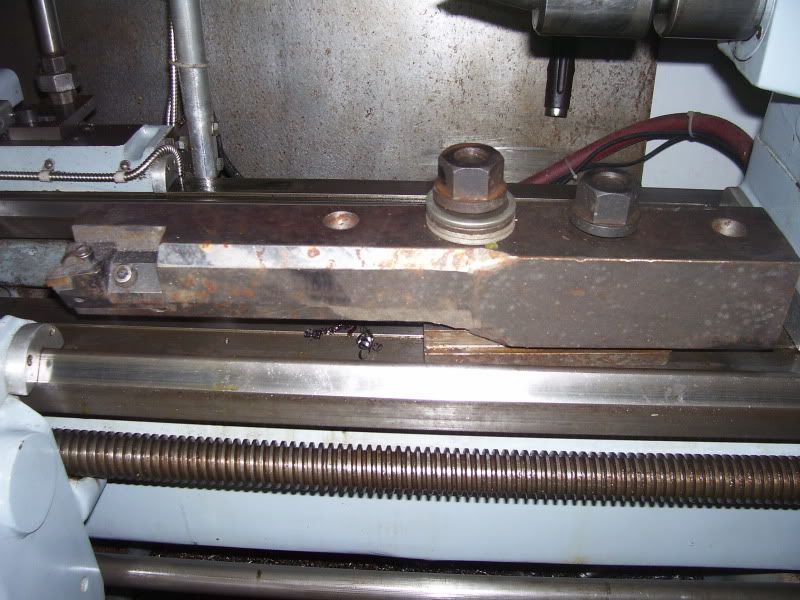

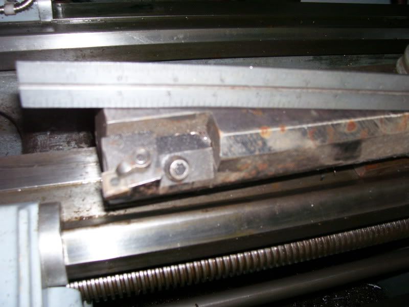

                • Since I took a pic of a boring bar for the make your own bar I figured I would put it here so others could get ideas..
                  I bought a few of the insert cartridges that were different geometry on ebay for less than 15 bucs. I needed to bore some bearing housings that were 8 to 12 inches in dia in the bore.wanted something ridged."rigidity is the key to sucess by the way"..
                  I had a 3" square bar handy and whittled away till I came up with this. I put in a few holes to mount it for different lengths and i can have 2 studs holding at once.Rigid
                  jim

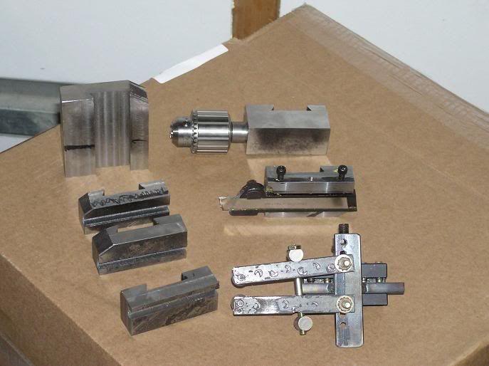

                          • Now that I can post pics here are a few.

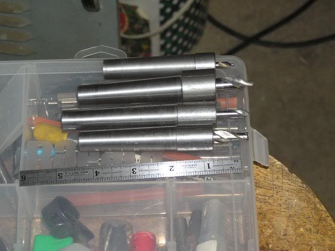

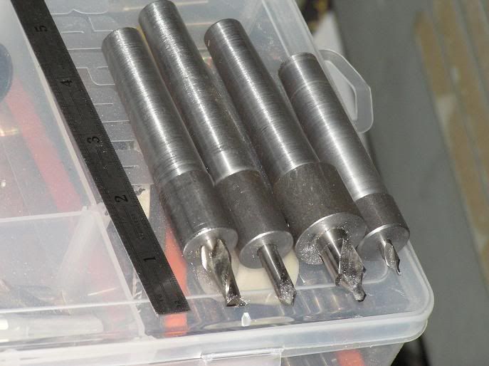

                            Sir John posted these awhile back. I actually stole the idea from somewhere else a few years ago. If you have a manual lathe and you dont have a turret tailstock, you gotta do this. Lots of benefits. Gets you closer to the tailstck than a drill chuck to help you start on center. Super fast to go from spotter to center drill or whatever. i will be adding a few common drill sizes in stub length for starter holes.
                            The one on the end hold a two flute centercutting endmill for getting rid of those pesky little nubs from the cutoff on the lathe. Makes things reall flat to get a spotter started on center. Works ok as a drill also for short depths and you can let it center your holes as well as it kinda cuts like a boring bar.
                            Some tool holders, the boring bar holder in the back holds Morse 2 taper. The knurler needs to be reworked. Yeah I know youcan buy them cheap but I have lots of metal and the cutters and learning to use it has been worth the exercise. I make them in aprox 6" bars then cut them up.
